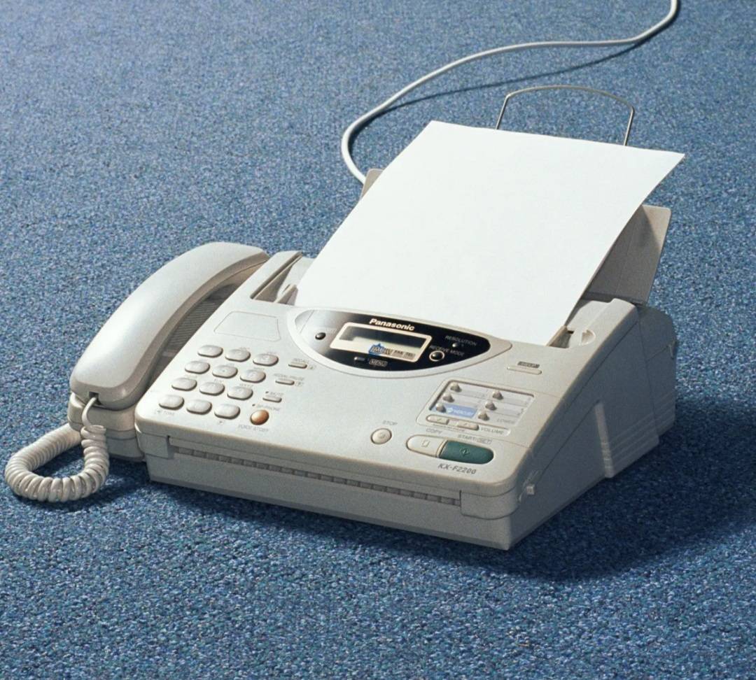

You need an email machine.

A fax machine - LOL
Someone might remember AN/UXC-7

Wow AN/UXC-7!! Did you get a chance to use one?
Yes and I worked in C&E Maintenance so we had to fix (got them working) - LOL
