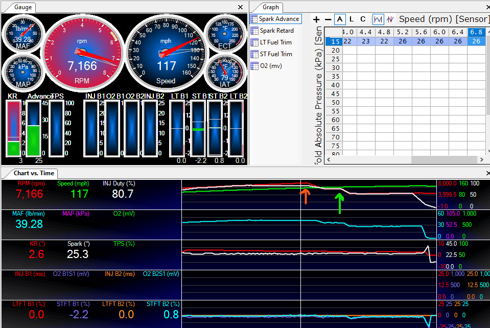

I'm just a spectator in this thread. However, when I go with an aftermarket tune it will most certainly be this company. Your customer service as well as your quality of work is what we've been missing in this world for decades now.Basically the issue this car is having is from what I have been told (when in manual mode) it is auto upshifting 3-4 when wot or something down that line.
While it's a very small issue it even does it stock.
As far as coding the tune to the car you are talking about a option We have to protect tuning by modifying the OS of the vehicle and your device for some unknown reason wouldn't load the tune and said unlicensed vehicle.
That is not a issue on our end but we went and sent a stock os file anyways so you could load it which no other tuners would do.
Usually when this happens you can go to Documents/hptuners/settings and delete the license.dat file, reopen RTD flasher and it fixes that glitch.
We tried multiple revisions to see if anything changes and haven't seen anything.
We have never had a issue with the 6r80 before and most people roll in manual mode then move the gear selector to auto when roll racing.
We are testing a few things in person but have yet to have this issue.
Looking back over the logs it is only auto shifting when you are at part throttle .
You were at roughly 30 percent throttle and shifted for 3-4 then when it shifted you went 100 percent throttle and it back shifted to 3.
If you are in Drive and bump the paddles you will only be in manual mode for 3 sec (if steady state) and it will go back to auto shifting.
When in sport (gear selector to S) they will keep the target gear and not swap to auto if no paddle input for 3 sec .
I see it actually does not auto upshift at wot but when you were at part throttle and when it upshifted you went to 100 percent and it downshift again.
As far as replys you were getting replies yesterday (Sunday) so I'm not exactly sure where you are coming from there...
We just sent a revision so give it a shot
