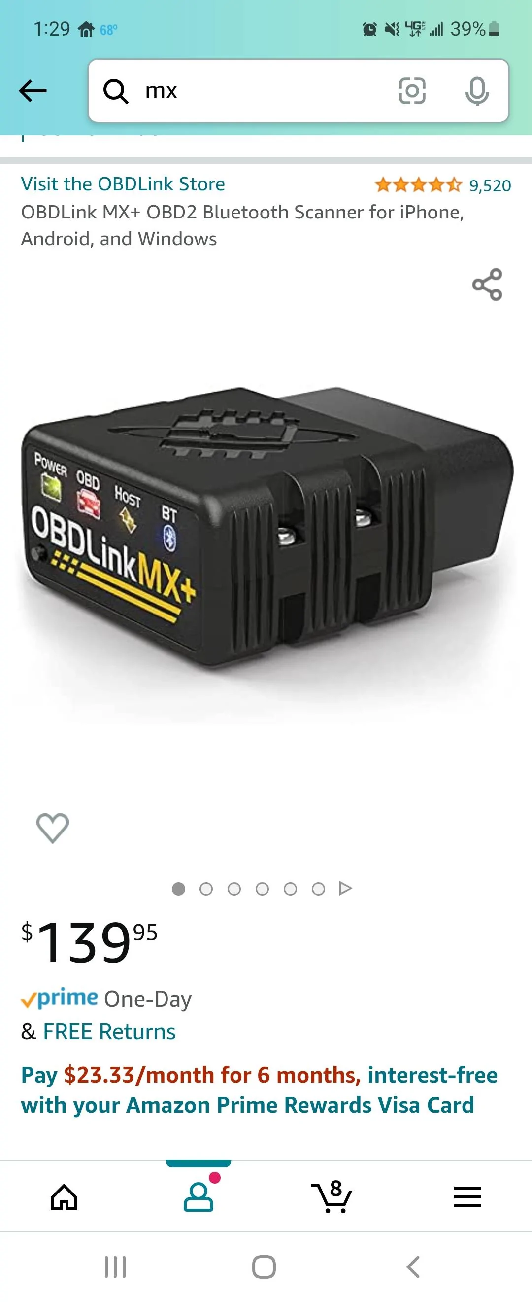

The mx+ is fantastic for wireless. Can probably find it cheaper online. It's what I use on all my cars.
