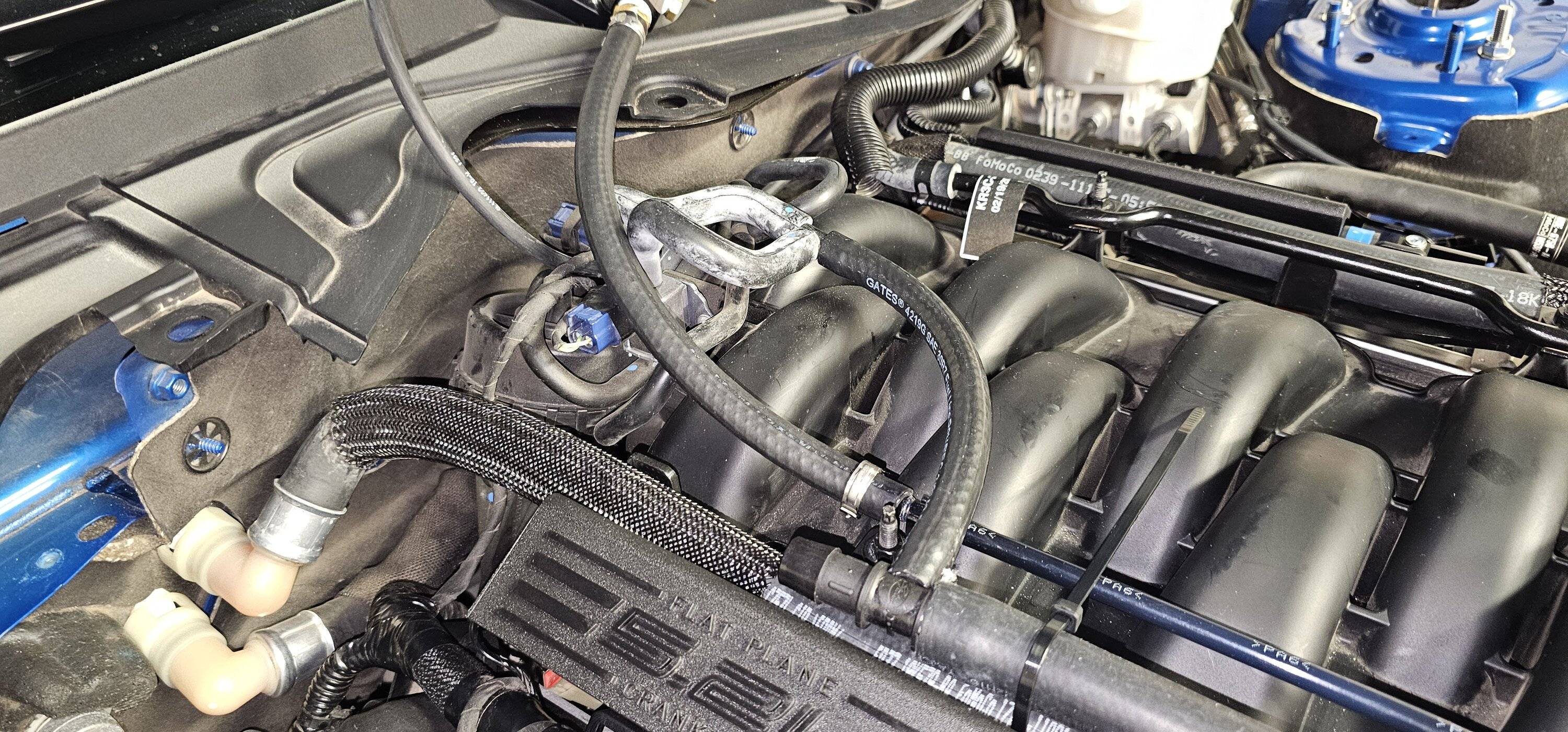

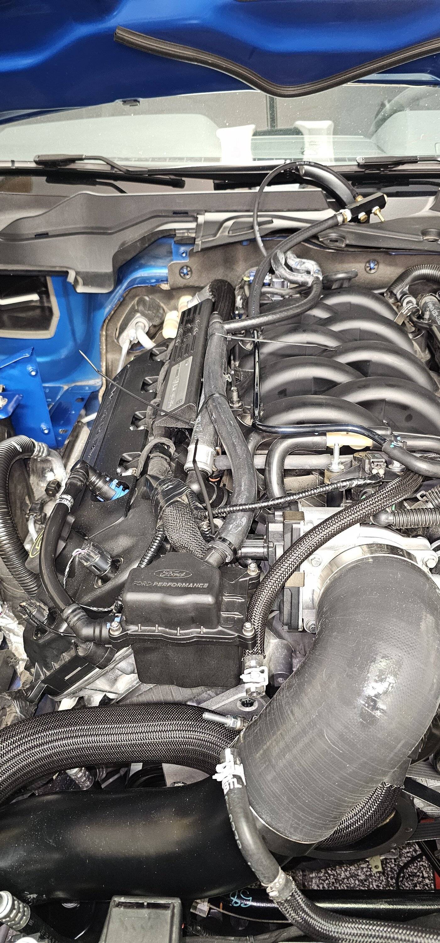

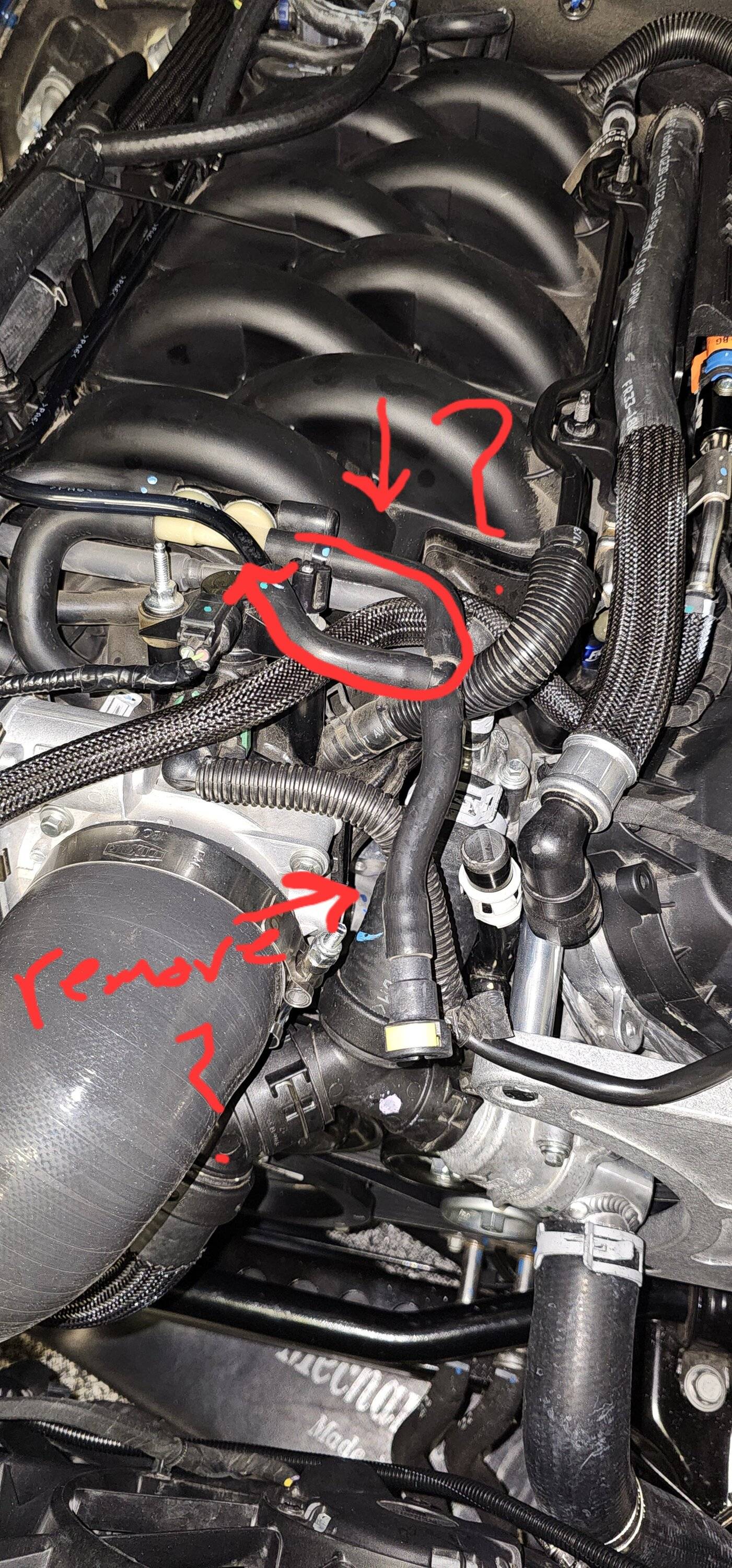

Trying to finish up my procharger install and I'm slightly confused. The instructions say nothing about the hose/connector that I've included with what I *think* I'm supposed to do in red. Also I thought it would be ok to keep my ford catch can in place and run the pcv system the way I have currently started, is this ok?
Am I running the T to the IMRC solenoid correctly also? The instructions are really not good and I've done a ton of discussion searching and image searching but see they have changed the configuration of the PCV system at some point. Any help would be great and yes I know not everything else is totally hooked up yet, waiting for some oetiker clamps to come tomorrow instead of using shitty band clamps . Thank you!

Sorry I kinda glanced at your post, are you looking to run the bov hose?
