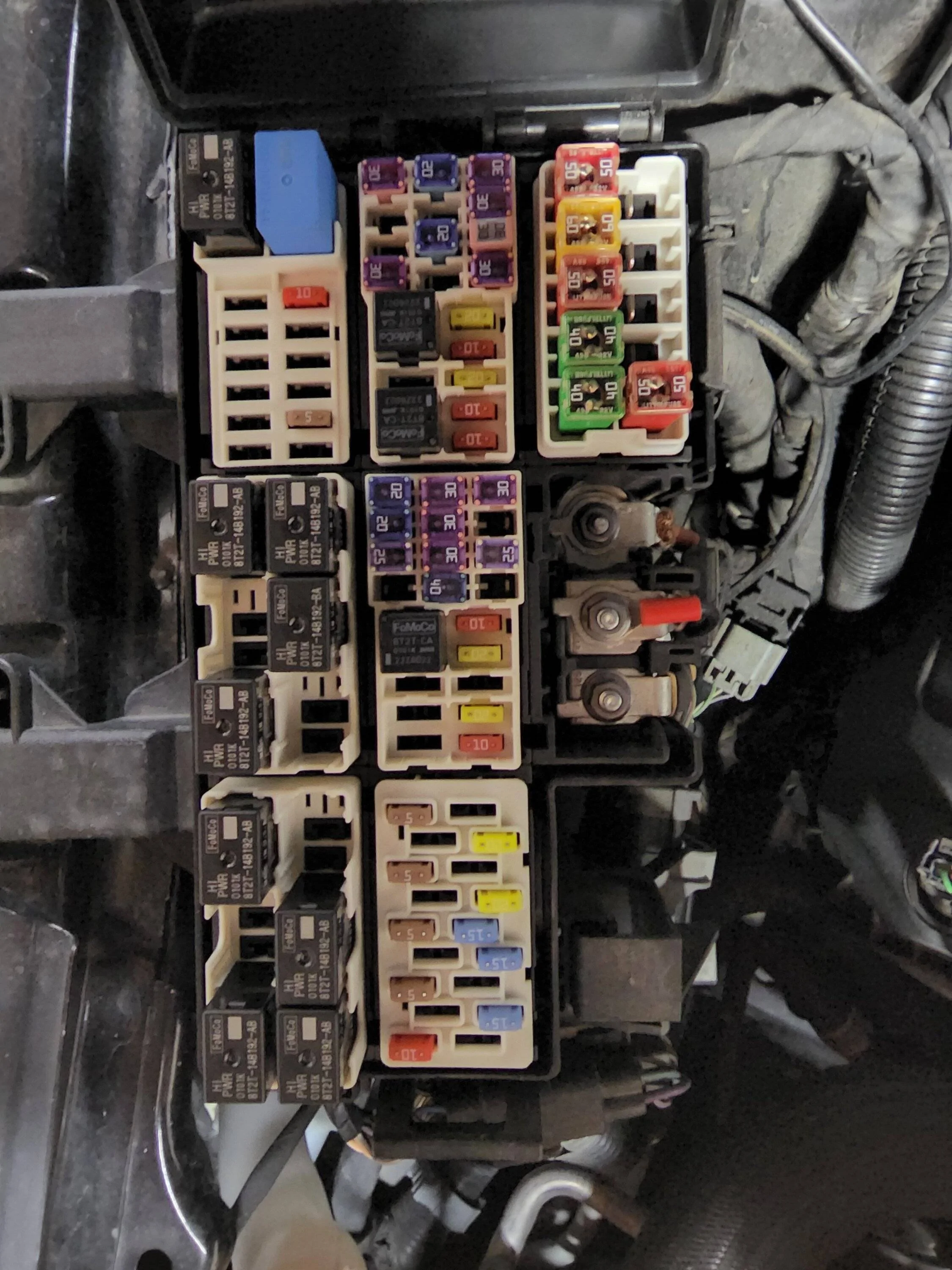

I think i may have found this issue. Could you do me a favor? can you post a pic of what your under hood fuse/relay box looks like?

Ya ive seen that. i'm looking for an actual photo of a real car tho. I think i'm missing 2 relays, but want to confirm with another GT350

Here
