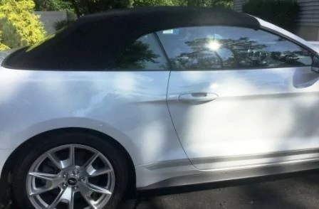

I used the 303 kit. Washed with a horse hair brush, let it dry then sprayed the top with the 303 protectant.
Here is a pic after the first light rain. I'd say it worked well!

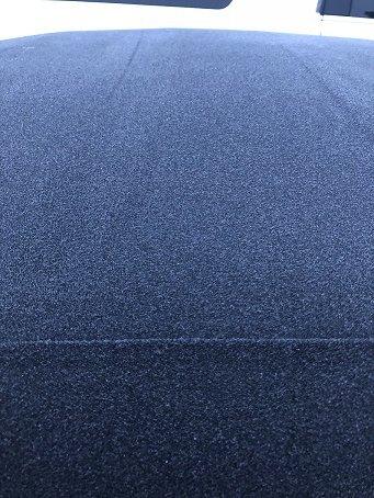

As requested, Pic provided.
Now time for some water repellent.

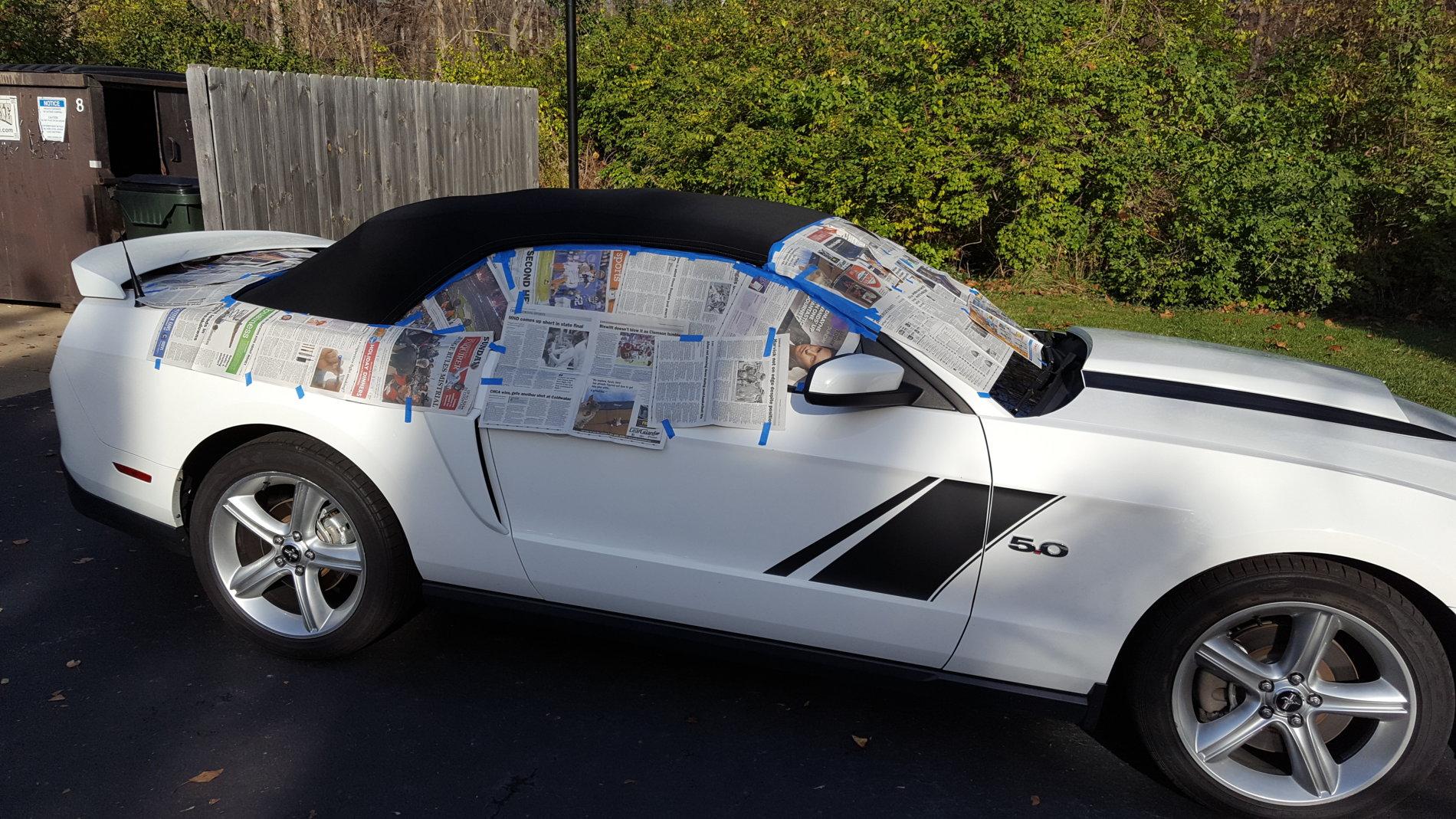

I washed my top with the Woolite for darks today and was very pleased with the result. It rinsed out very easily and very well. Afterwards I masked off the car and applied the 303 fabric guard. We are expecting rain this week so I will see how well it has worked. I can tell you that you don’t want to get the 303 on anything other than your top as it becomes a sticky mess. I got some on the glass and had to use a product similar to goo be gone to remove it followed by some Windex to get rid of the haze that product left.

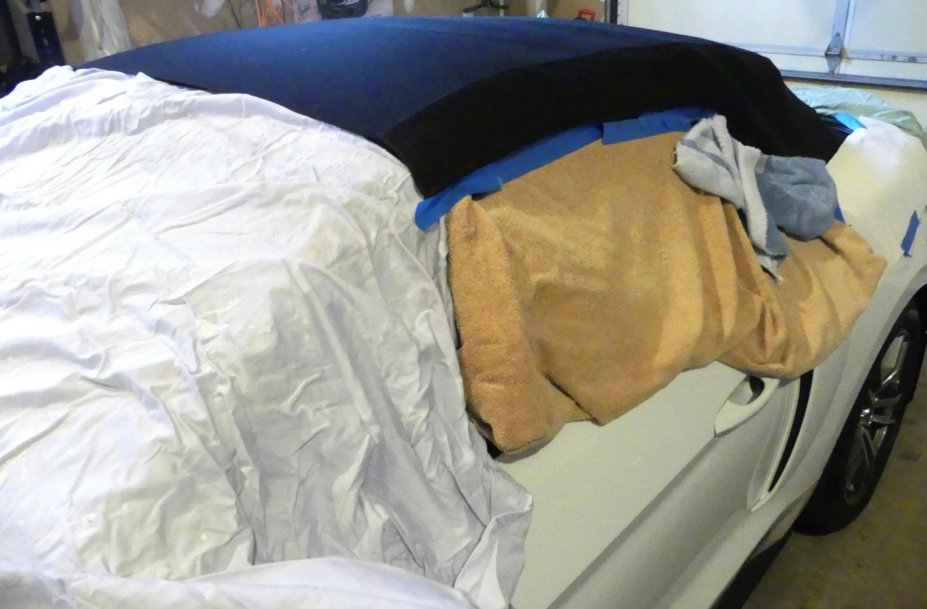

THE RITE OF SPRING!!
Washing the top with Raggtop....then waterproofing it with their spray!
We are ready for Spring!!
Yep, that is exactly how I prepare my car for its annual top treatment!
I am on my third Mustang convertible, the very first time I did this drill I did not take the time to mask it properly.
Spent hours scraping off over-spray on the glass, that stuff dries like thin glue!
