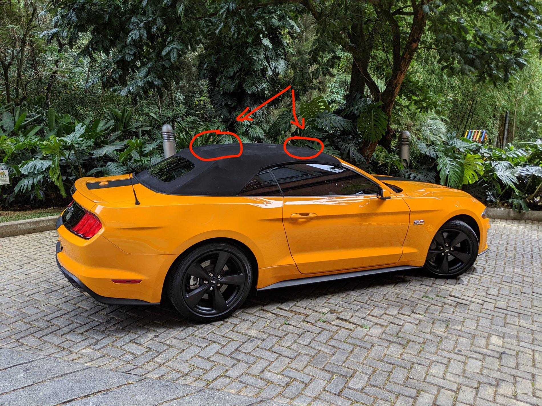

Put 303 on the convertible roof yesterday afternoon... poured it into a small pan, and used a horsehair brush to apply it carefully. Didn't bother to spray it given the feedback on this thread... Had no issues with overspray or uneven application - but ended up using the entire bottle.
Overall the application seems to have gone without any issues. I do notice some very light spots where there seems to be a bit more of the 303 substance on the roof, but assuming that all of these will fade away (Applied it less than 10 hrs ago). The spots on the photos have all but faded away (this photo was taken a few minutes after I applied 303 on the roof).

Be patient. It takes a while for the top to dry and those uneven color spots will resolve themselves after it dries. Try to avoid letting the top get wet until the 303 is fully dried. After, you should find that water beads up and rolls off the top quite nicely.

Yup - you are spot on/right. The spots have all disappered, and the top looks perfect; infact I think it looks cleaner.
As @Intrepid175 said - Patience is needed for the 303 stuff to fully dry out.
