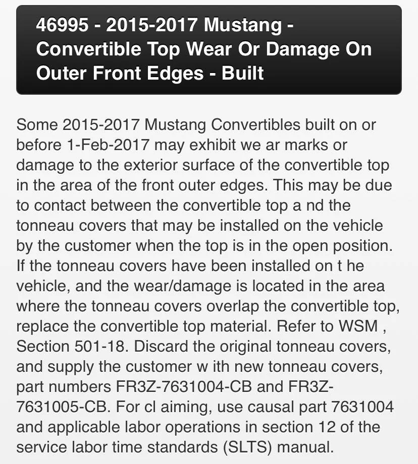

I did notice that my tonneau cover a have a large piece of thick foam glued to the underside of each. I hope this is addressing the rubbing issue I read about on the 5G's?
Actually it was the 6G's that had the problem. 15-17 verts built on or before Feb 1 of 2017 had an issue with the covers rubbing and leaving small cuts in the canvas top. Mine was one that was affected. They replaced the top and give you revised side covers.
