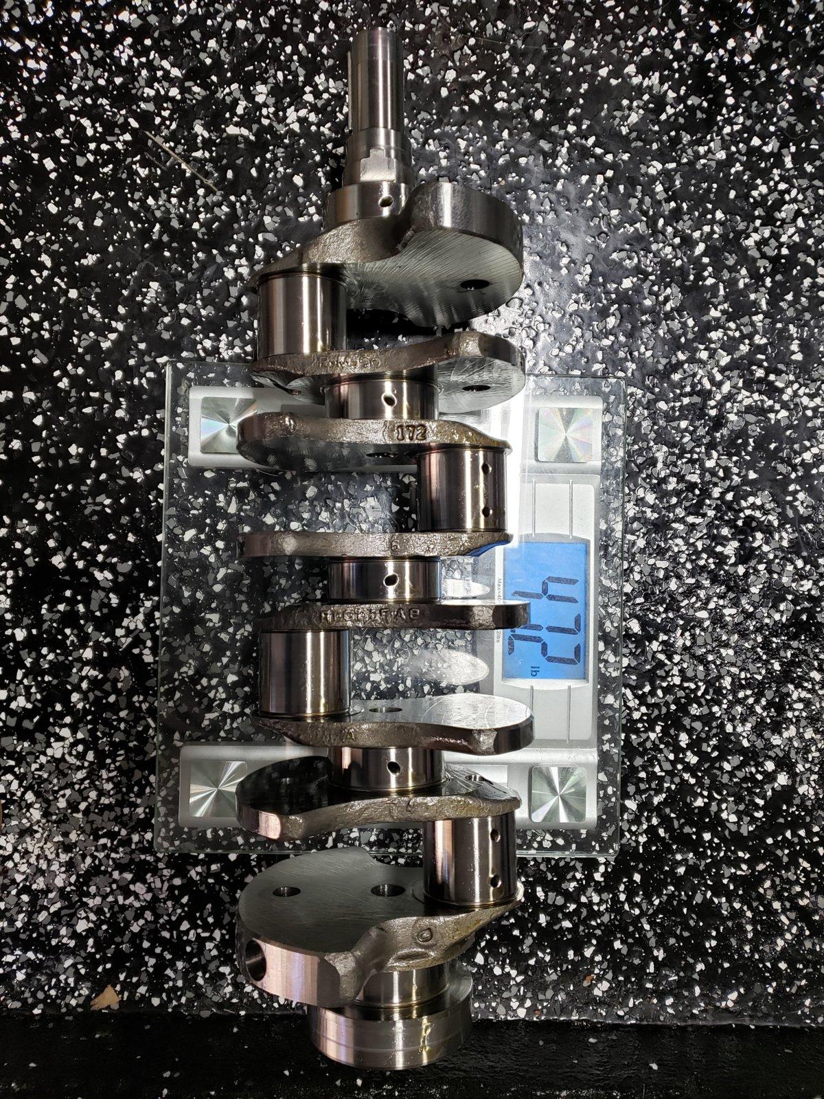

I've Googled and searched the GT350 forum and can't find the answer. Has anyone either weighed their Voodoo crankshaft or found documentation of its weight? TIA

That's incorrect. It's somewhere between 46-48 lbs. I've weighed one myself years ago so I don't remember exactly and I don't want to go through the thread I mentioned before. Even the Predator crank is less than 51lbs.

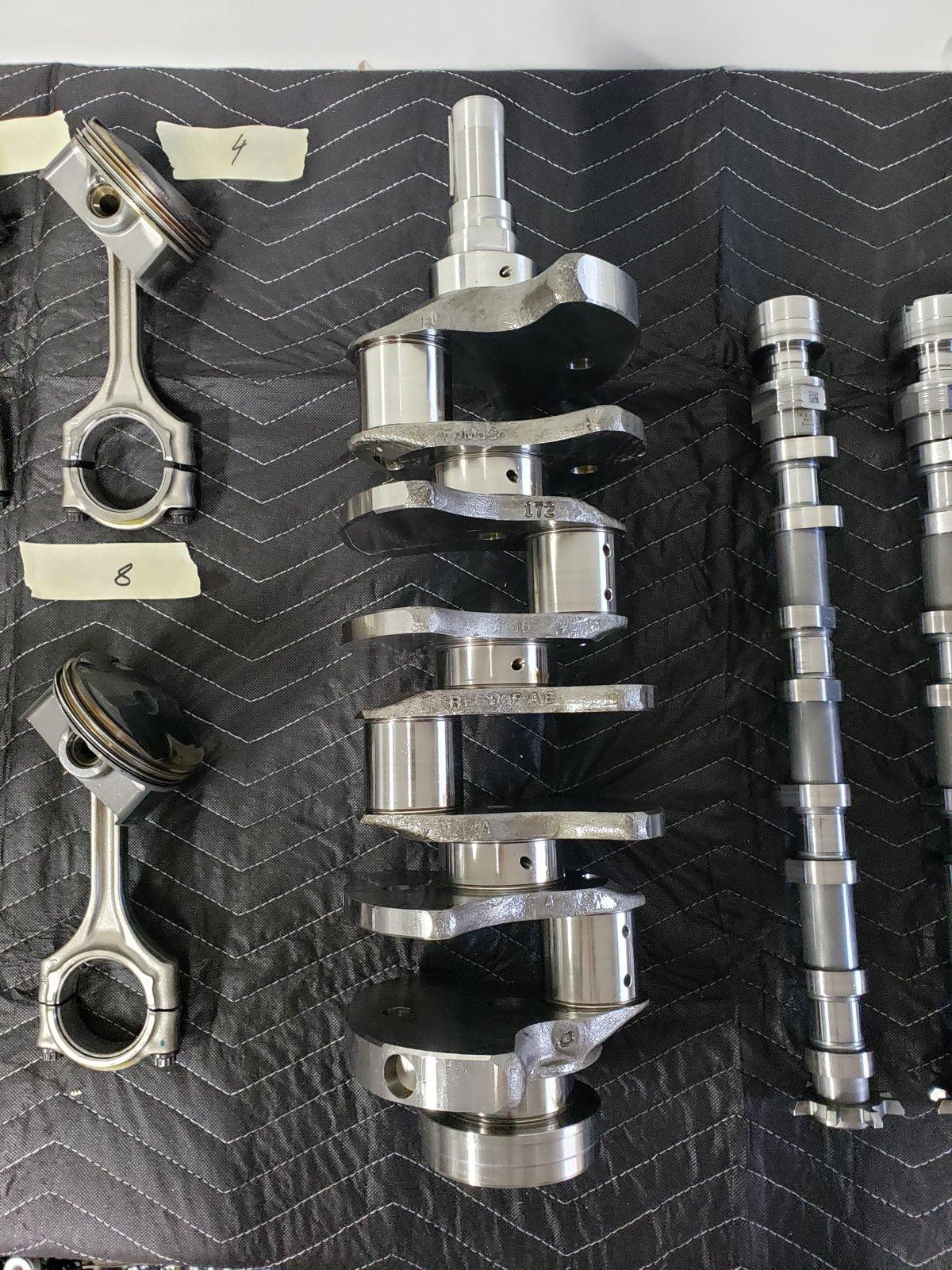

Guess there were two different readings
51 Pounds is what Honeybadger's crank weighed, 51.4 after it was re-balanced.
Here:
But later the bathroom scale said 47.2: https://www.mustang6g.com/forums/threads/gt350-engine-refresh-time.115139/page-10#post-2430932

@AceOne here you go. Looks like 47.2 lbs for me (atleast according to the bathroom scale :))

The 51/51.4 was my post to the weight of the Ford Performance 5.2 Cross plane crank weight.
