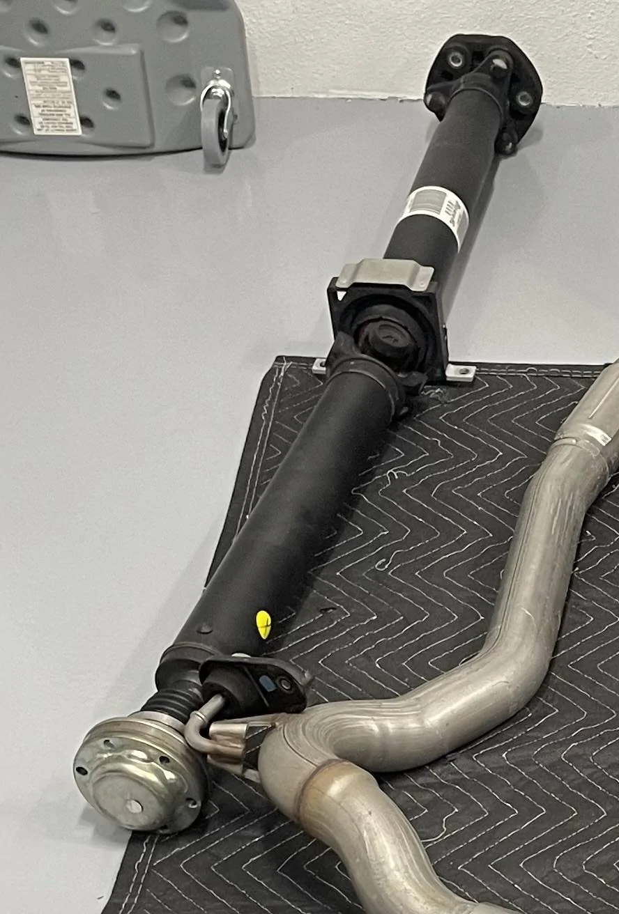

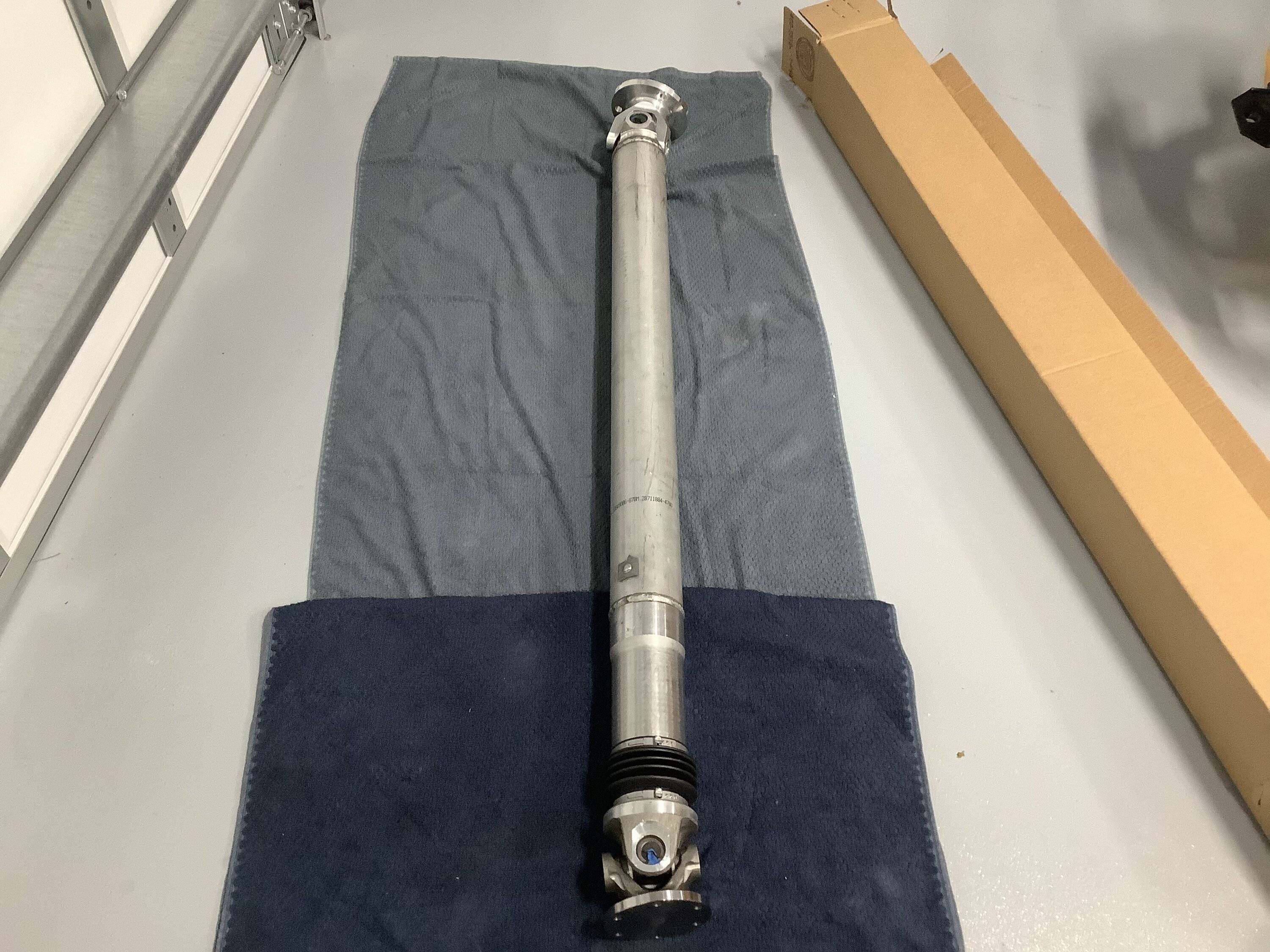

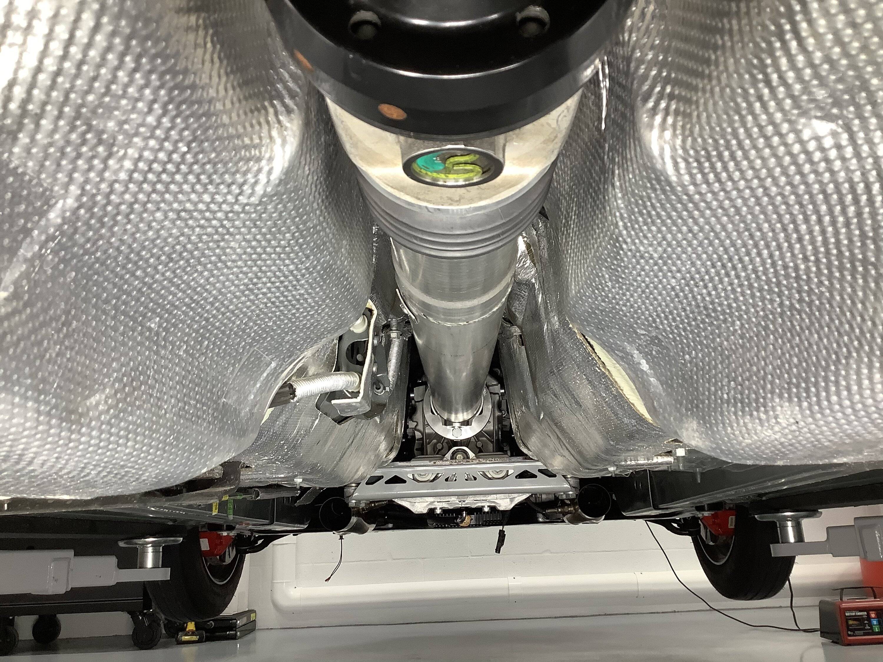

Might be time for an aftermarket driveshaft. I just installed a Steeda one piece ds in my 2019 Bullitt and so far, it’s been super smooth up to 80 mph. I haven’t pushed it past that point yet, but I certainly intend to in due time.
Factory two piece
Steeda one piece

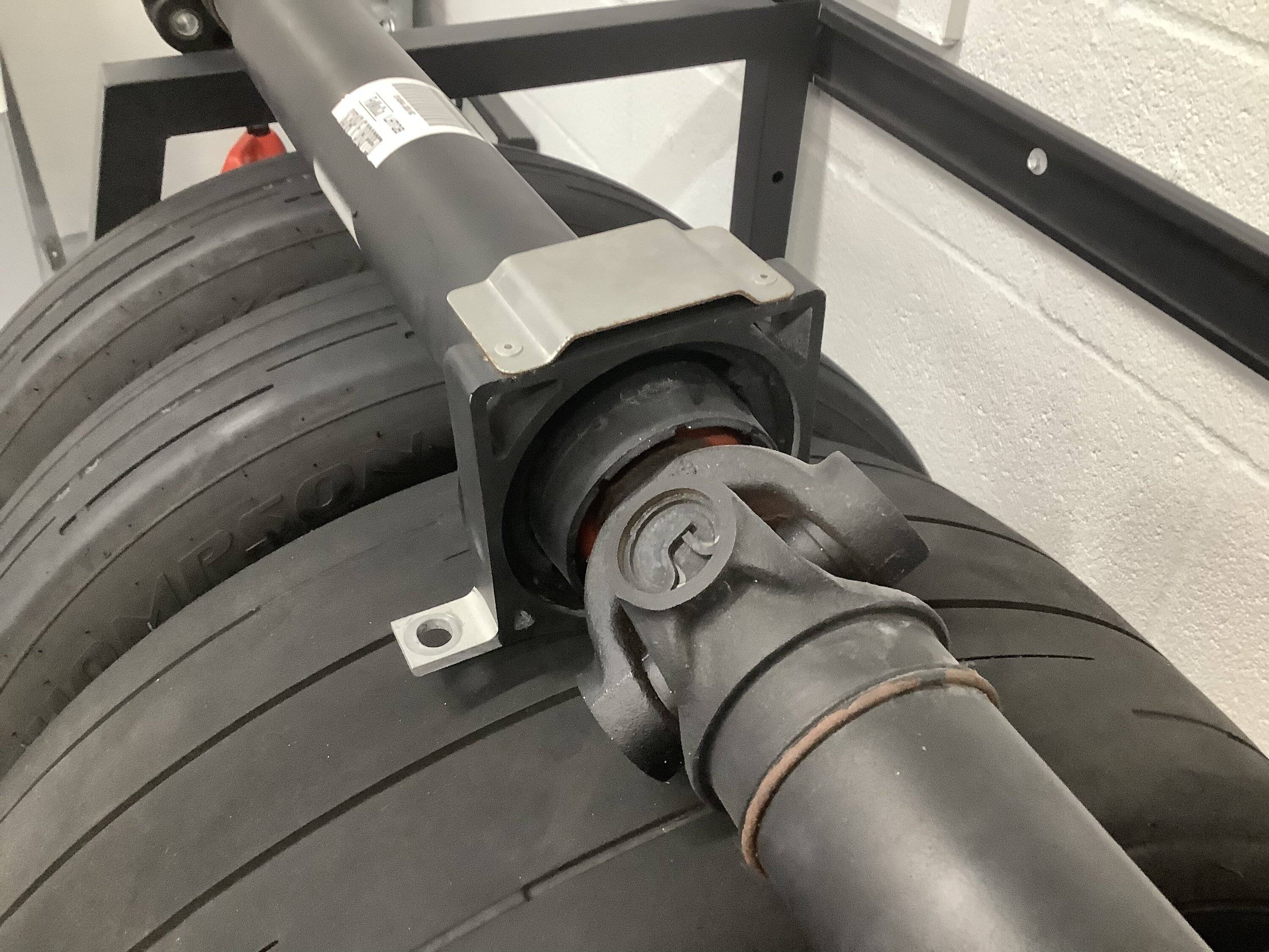

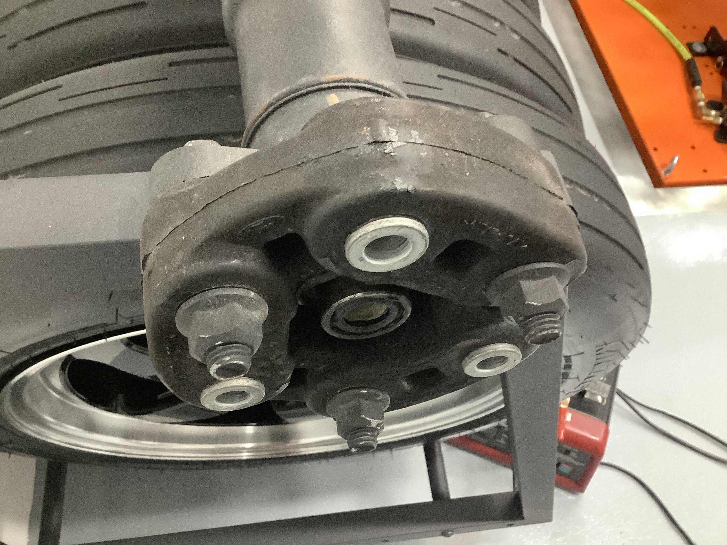

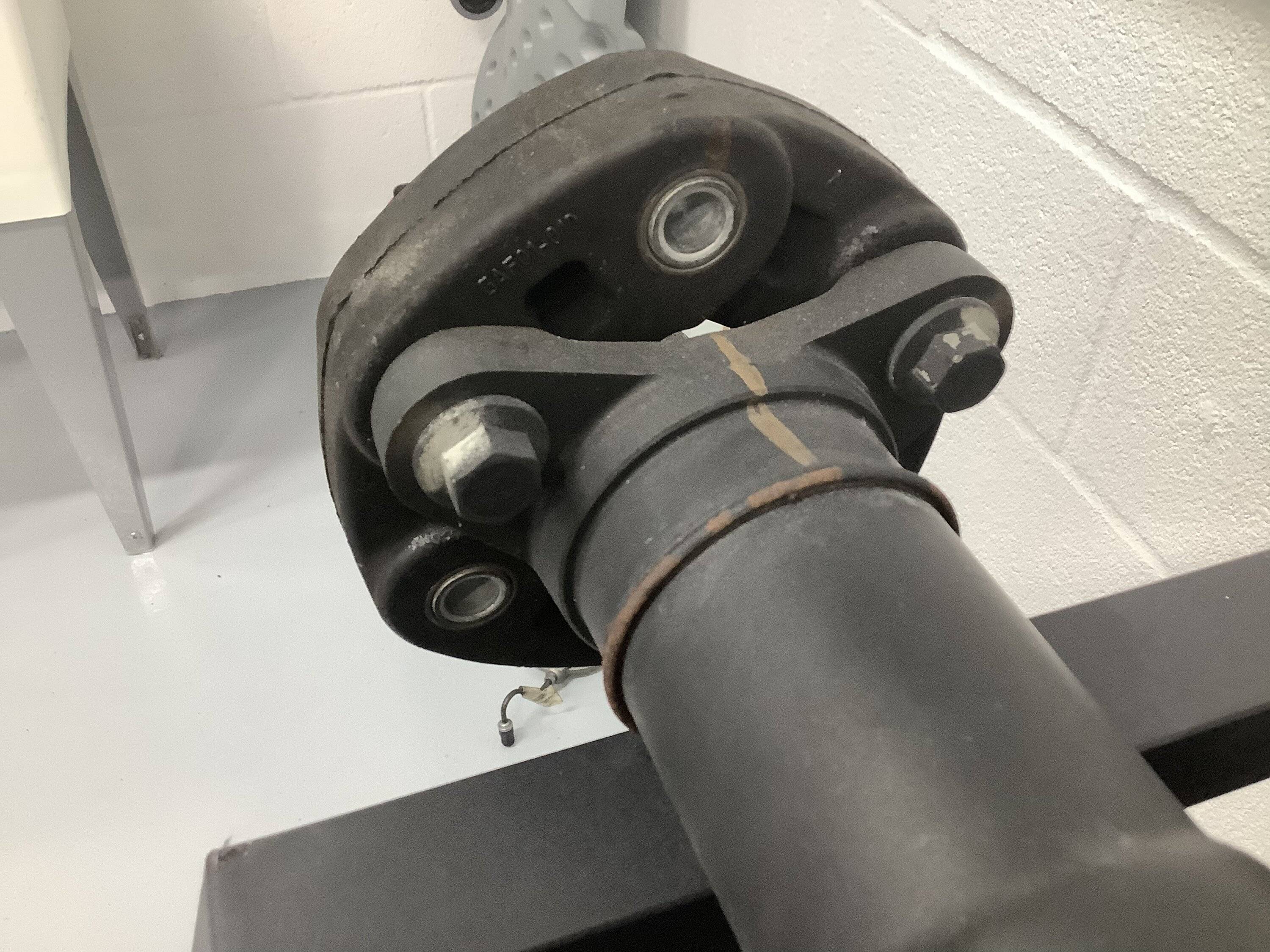

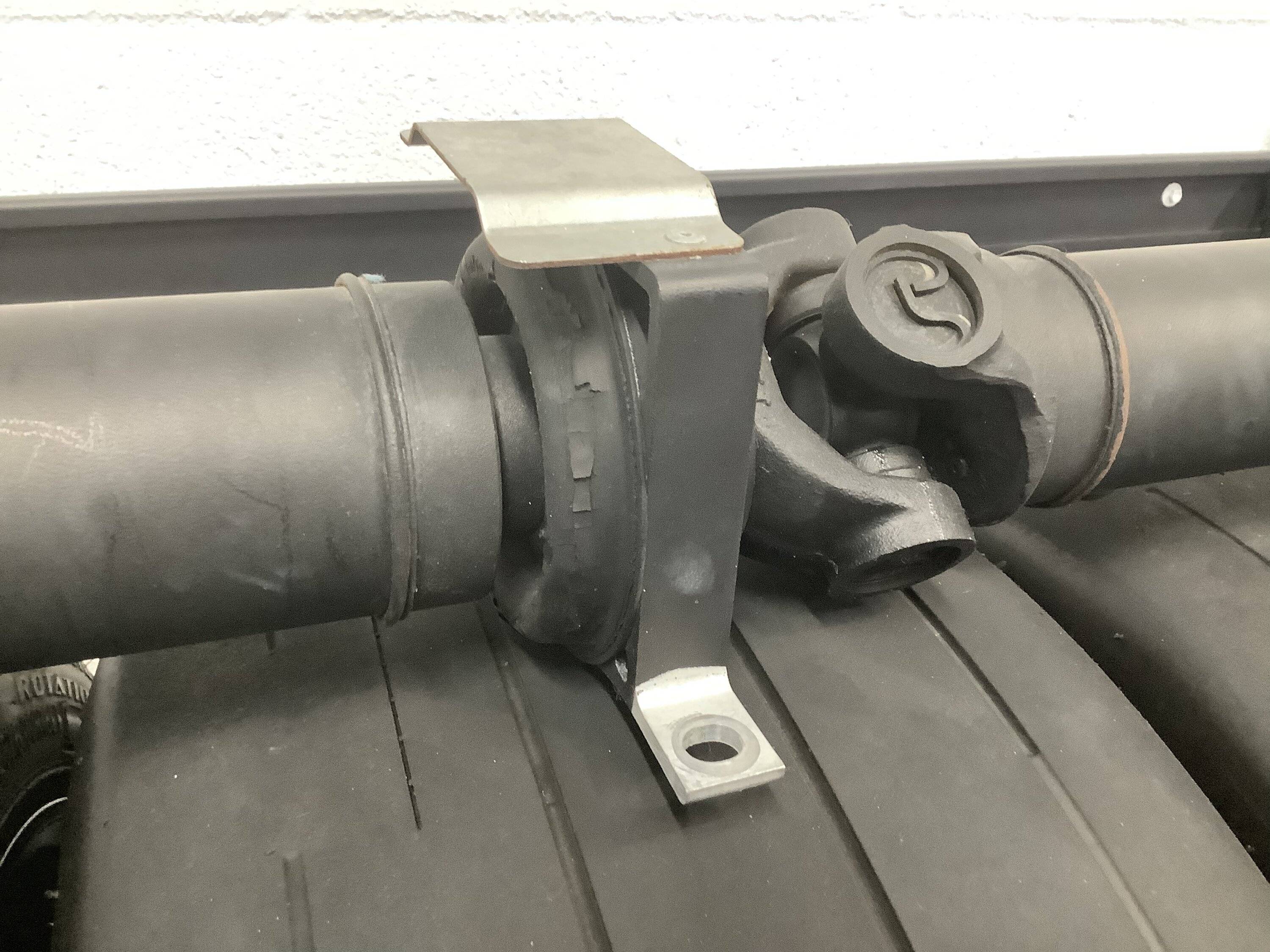

Here are some pics of the rubber bandaids that Ford uses help mask NVH on the factory ds. Why else would they opt to build these cars with a 2 piece ds over a 1 piece?

Ordered an aluminum from DSS arriving tomorrow for my Bullitt. Not looking for power gains, just a snappier and better driving experience. What's your experience?
