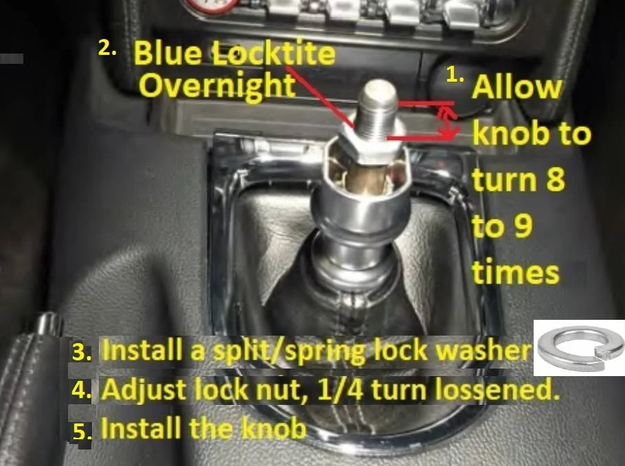

Try some Blue Lockrite, or Install a nut (if space allows) and a lock washer.
I’ll try one of those washers. I currently have the nut. I’m assuming that nut is the adjuster for how high the reverse lock goes up?

The pictoral installation instruction is for the RTR Shift Knob, so adjust accordingly for your knob.

Yes. If not tight you'll get the rattle.
My nut doesn’t go down that far. When I screwed it down as far as it’ll go, the reverse lockout didn’t clear the knub
