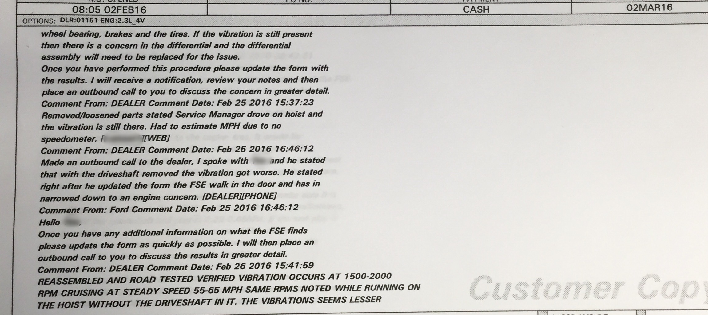

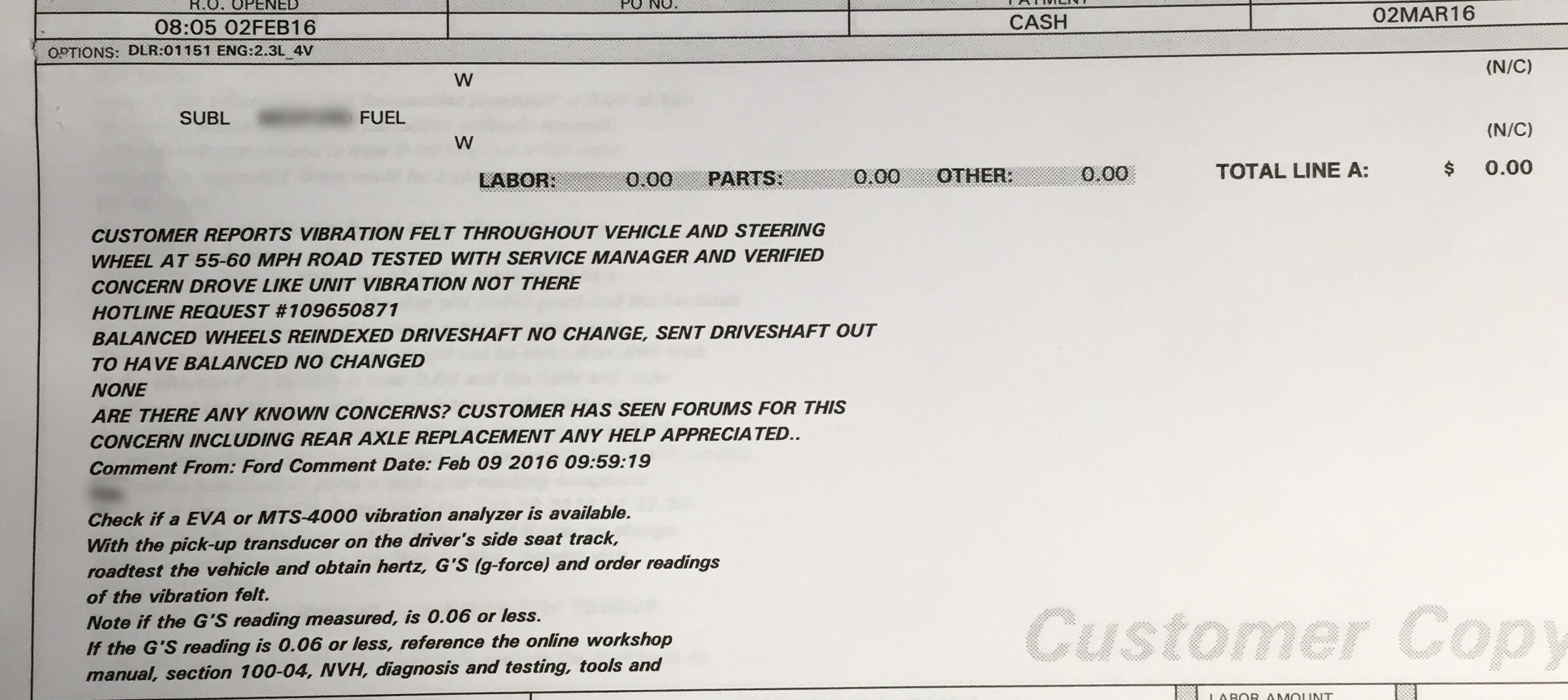

Ok - this post will contain some important info, basically an outline that will help others with the same driveline vibration issue. PLEASE READ THROUGH! My next post will contain the pertinent info that resolved my driveline vibration issues.
Partial Retraction of my post #962:
I stated in that post where the FSE never showed up at my Ford Service Center on 02/25; come to find out - that was not true, the FSE DID show up to my FSC on the day he was scheduled. I was given misinformation from the FSC Service Writer, who cannot relay information properly to Customers. This issue of the FSC Service Writer's ignorance was elevated by my Regional Ford Customer Service Rep (CSR), hopefully he'll receive additional training. My CSR has documentation and confirmation that the FSE was on site (unbeknownst to me based on what I was incorrectly told).
Note about tires:
Now, for those who have brought their vehicles into their FSC, the vibration is NOT related to the tires, even though most FSC's want to Force Balance the tires. If having a PP equipped Mustang with the Pirellis - AND temps are below 40*, the tire compound will become hard and exhibit some NVH. This is normal, however it is not the source of the vibration. Force Balancing will not resolve a genuine driveline vibration. HOWEVER it is a NECESSARY part of Ford's diagnosis when customers complain of a speed induced vibration.
DO NOT GET DISCOURAGED if your FSC wants to rotate or balance tires - it is usually the initial step in the diagnosis procedure (this has been documented many times within this thread of how many folks had their tires balanced, etc.).
The 55-65mph Vibe:
This is a genuine problem. The car MUST be brought to the FSC for them to initiate diagnosis. If posting here bitching of a driveline vibe or vibration while driving and you're not taking it to your FSC to have it diagnosed, you're really wasting your time and energy posting here. You HAVE to have a claim opened with a Regional Ford CSR to "bump" priority of your vehicle at the FSC and so that the Regional Ford CSR will be your advocate for expedited repair AND communication between the FSC and Ford's Engineering Teams.
FSC notes:
The Ford Service Centers have to follow "protocol" via the available repair resources they have at their disposal. This "vibration" issue has not been documented via a TSB (yet), so the FSC's are at the mercy of Ford and any other available references such as the Ford HOT LINE, the Ford CSR/FSE communication and/or Smart Customers who can supply references such as to point them to this very forum. Getting irate with the FSC Service Writer will not solve anything - they did not build your vehicle, they did not cause the issue - THEY are trying to help YOU, even if it takes weeks on end. If you are short tempered, believe that cussing, screaming and yelling will get you far in this world - you're not going to have any better luck getting the problem resolved with Ford OR your FSC Service Writer.
The FSC must diagnose by process of elimination - you must be patient during this process..

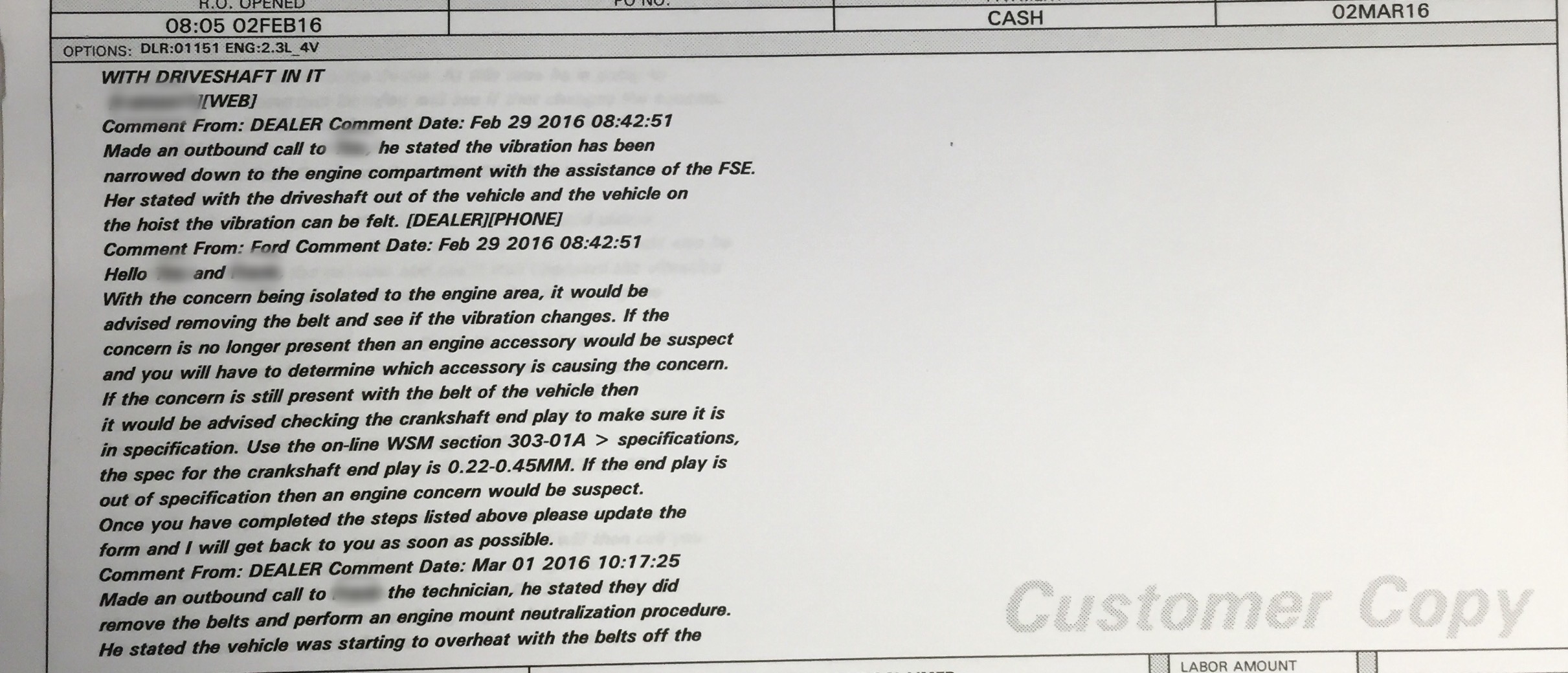

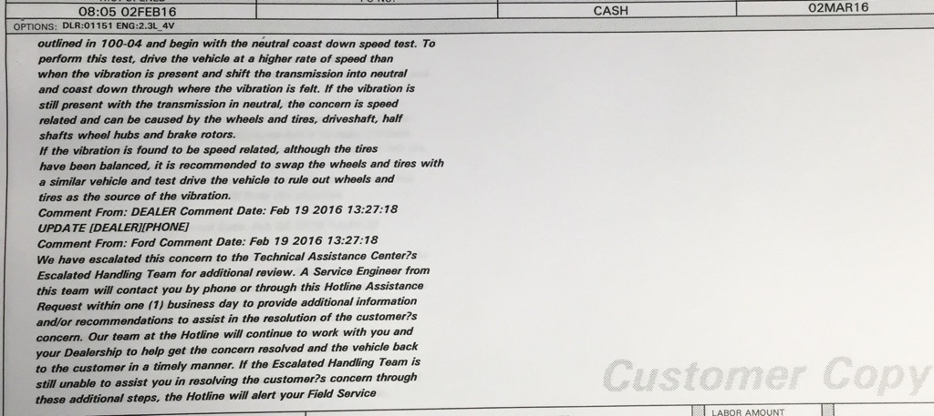

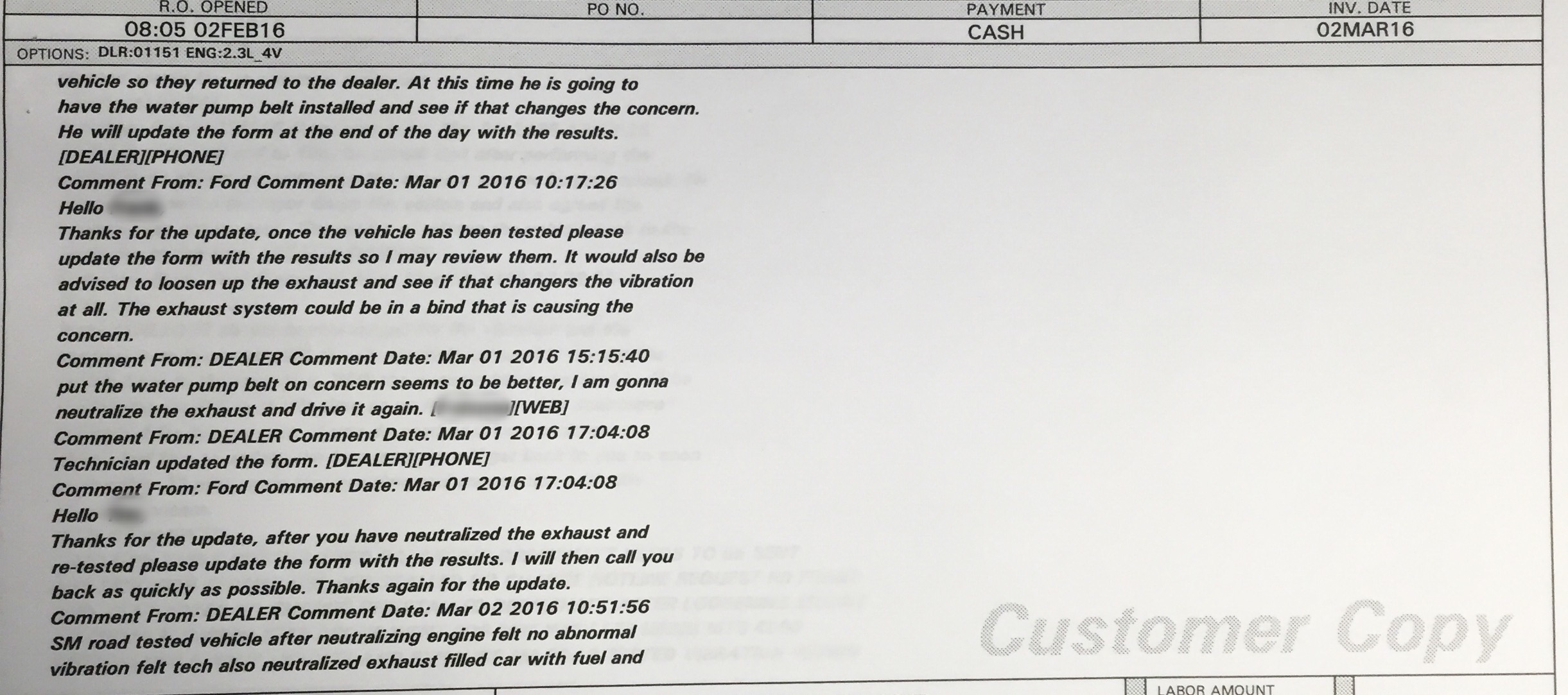

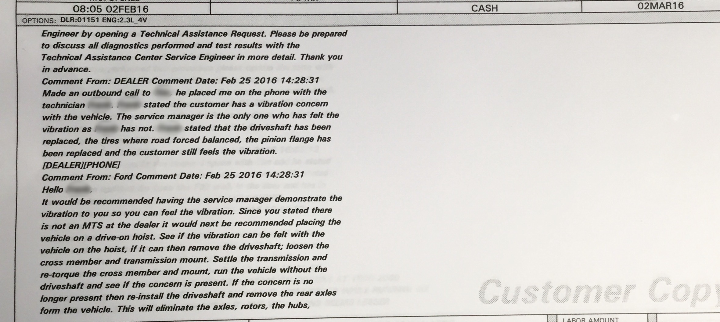

My next post will document what my FSC did to resolve the driveline vibes on my 2016 EB Premium w/PP. My invoice (work order) was open from February 02, 2016 through March 02, 2016. The car was at the FSC for 1 week, then back again for 2.5 weeks. During the entire time my FSC had possession of my vehicle, I had a loaner vehicle from them.
Cobra Jet
Feb 12, 2015
771
17,584
20,016
PLEASE NOTE:
The below images are of my actual Ford Service Center invoices. I have omitted the headers and footers that contain personal information as well as Dealership information. I have also blurred the names of the FSC Techs, their Lic #'s and the Service Manager due to privacy concerns. All content as seen is 100% legit and my vehicle is 100% fixed as of March 3, 2016.

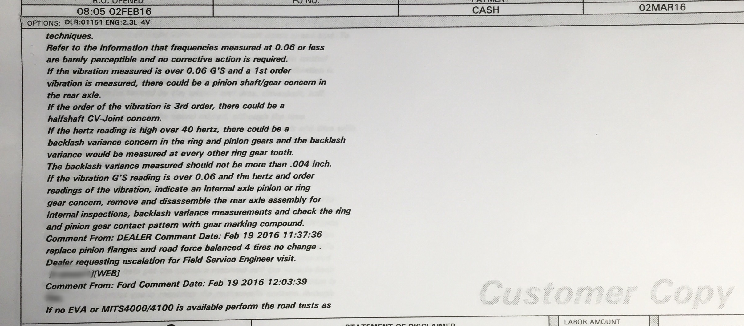

Pages 1-10 are what you want to show to your FSC if you have a genuine driveline vibration! There are extremely detailed notes between my FSC, the FSE who came out to the site location AND the Ford Hot Line Engineering Team. READ THROUGH ALL DOCS - it gives a very detailed synopsis of what parts were replaced and the final resolution.

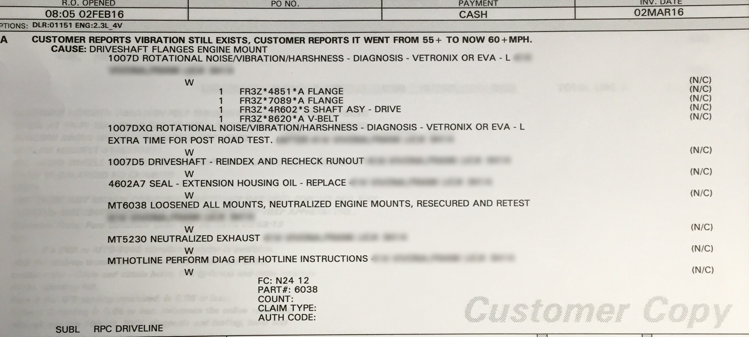

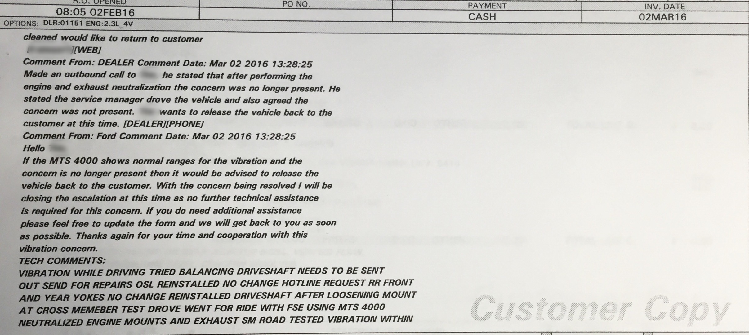

Believe it or not, once the FSE and Engineering Team requested the tech to "neutralize" the ENGINE and EXHAUST, it was relayed by my FSC that once those steps were accomplished, the driveline vibration was no longer present. THIS IS A VERY IMPORTANT STEP THAT NEEDS TO BE BROUGHT TO YOUR FSC's attention!
My Mustang has NO NVH at all after picking it up. The only things I feel or hear are the normal "buzzy" 4 popper engine and road surface noise while driving. There's absolutely no vibrations while driving in ANY MPH range - all the way past 75mph - its SMOOTH! In fact, the car feels 100% better than when I had taken initial ownership!
The neutralization of the engine and exhaust (along with the driveline parts replacements) is the definitive fix!

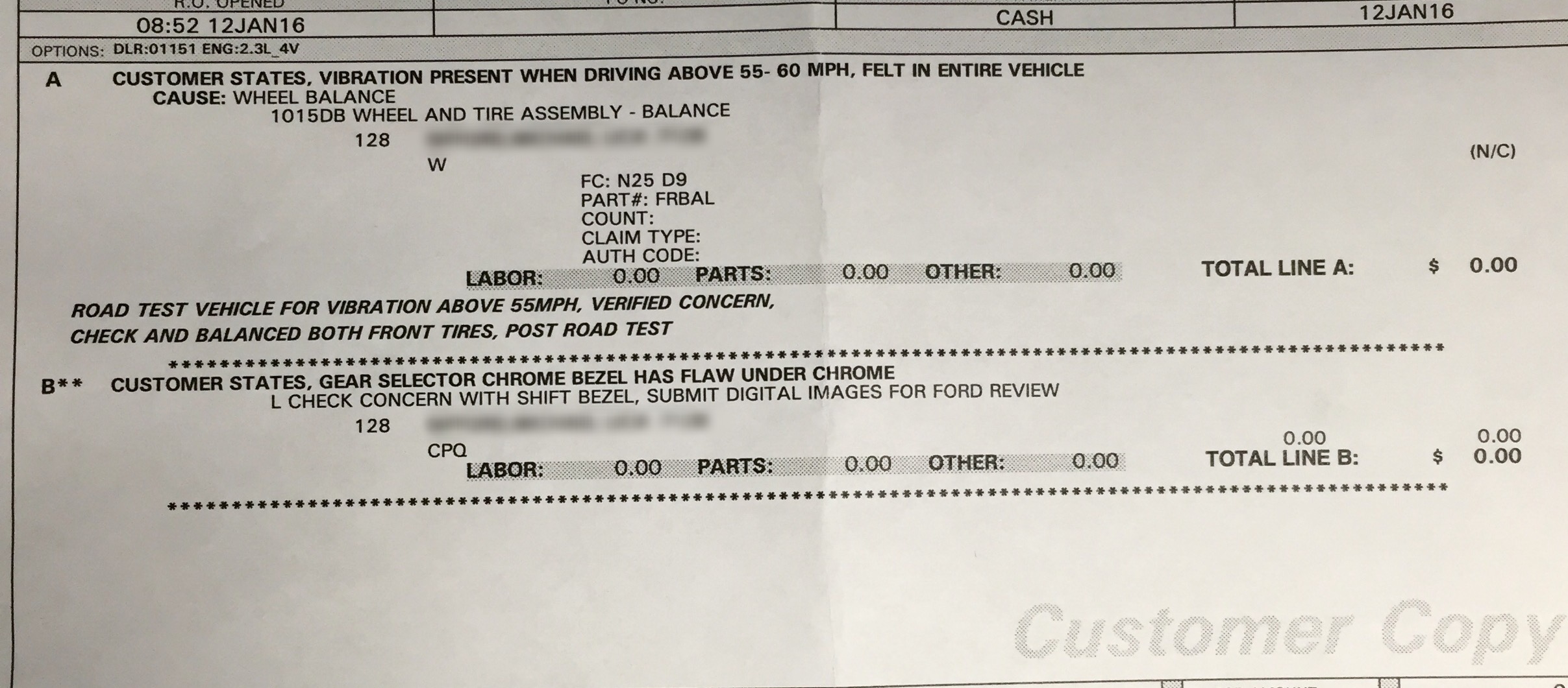

Initial visit to my Ford Service Center on January 12, 2016 (page 1 of 1):
Second visit to my FSC on January 12, 2016 (page 1 of 1):

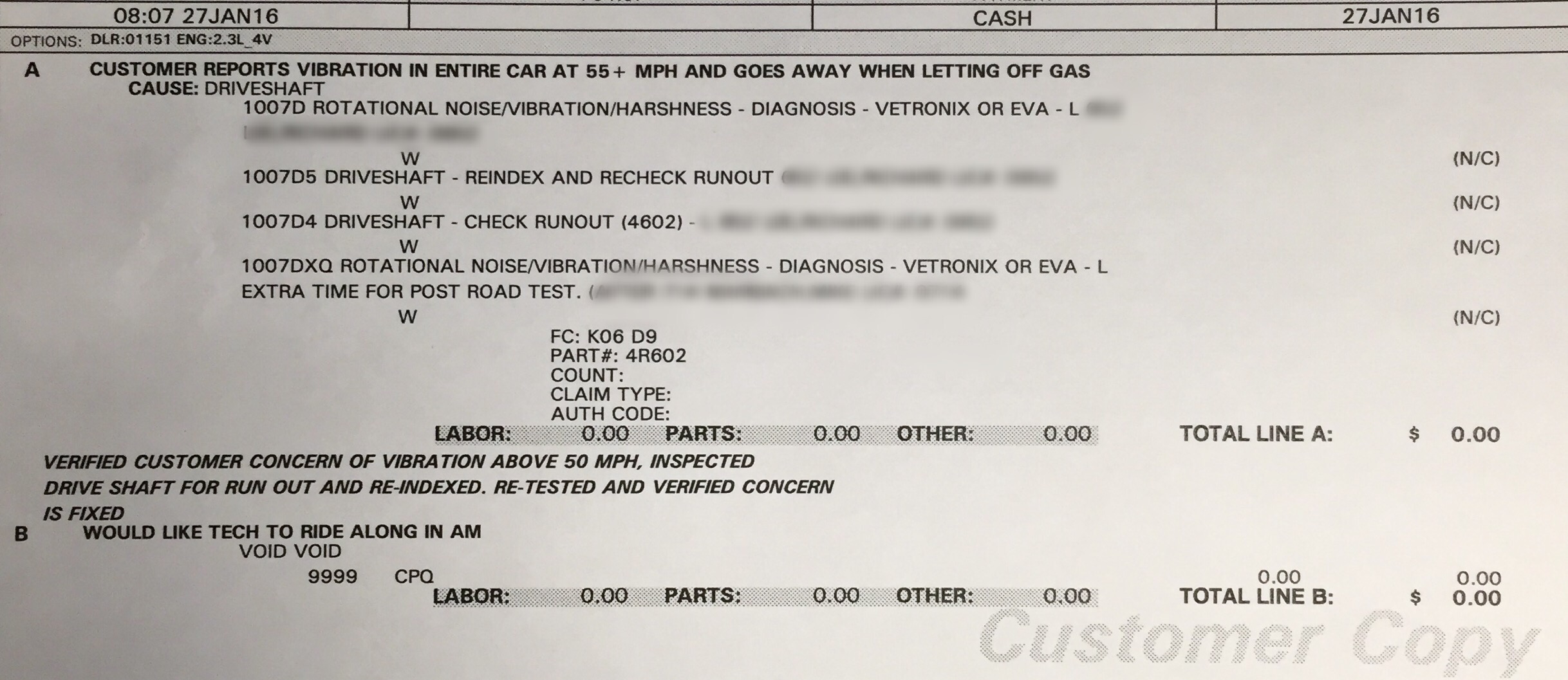

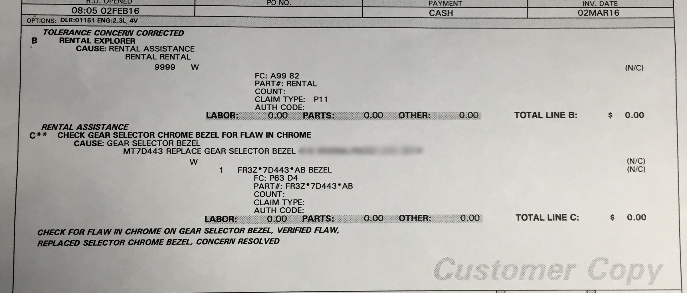

3rd and 4th visits to my FSC - February 02-08, then February 15-March 02:
