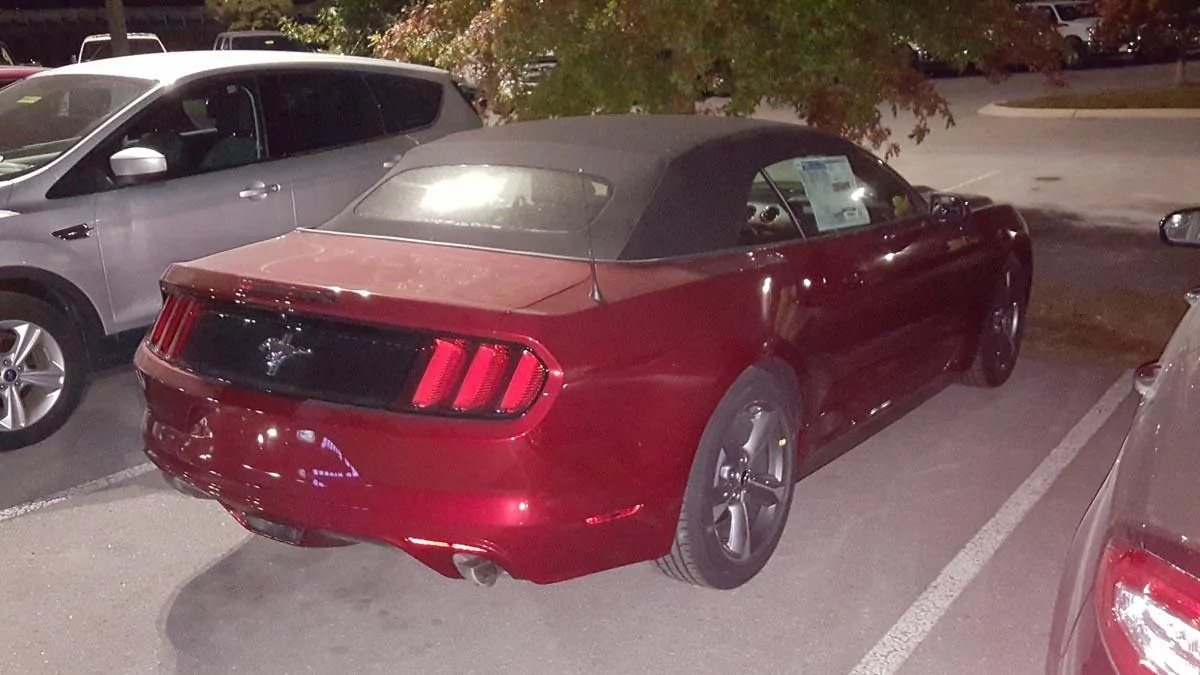

Just got back into town and went straight to the dealer to see if my replacement car was really there. It's really there! I will be able to pick it up as soon as Ford gets the paperwork to the dealer; it should be in the next couple of days!
Very nice, icarumba! Congrats again!!
