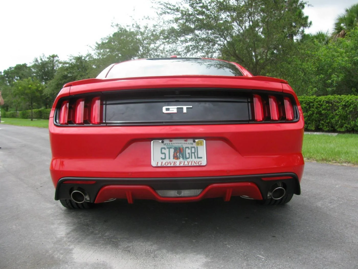

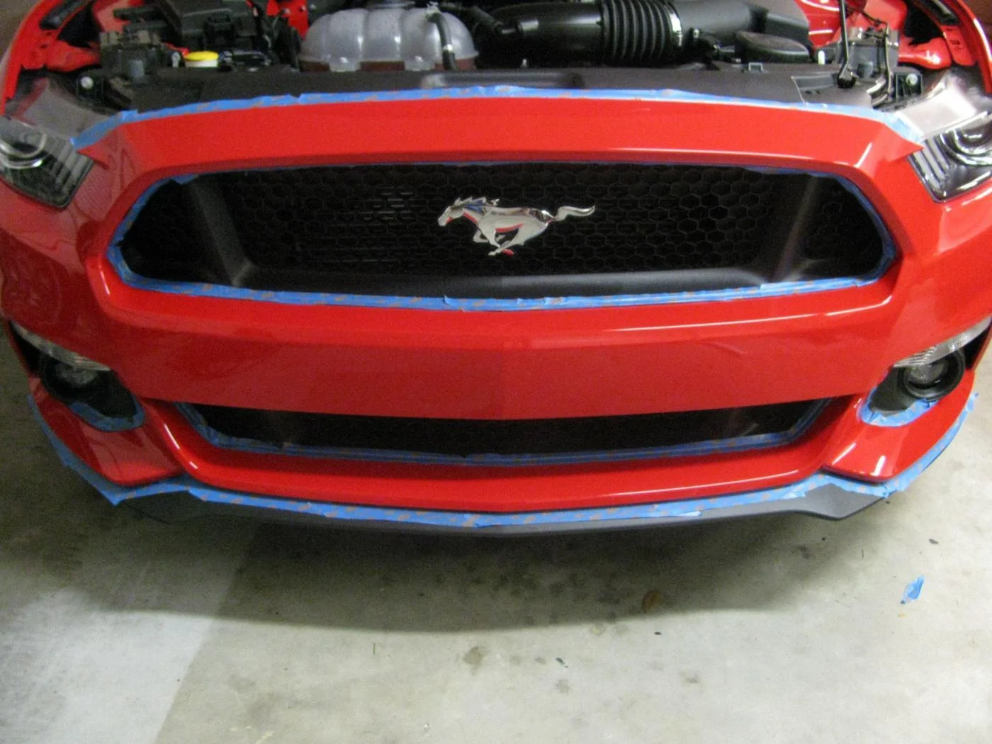

Thank you Deysha We will PM you,a few pics of Tiffany she taped all the black trim for her 2 day wax job! We are taking ours out today for a short drive on I95 to run 70mph how all goes well..Thanks

You’re very welcome, BOBS550! It does look great!
