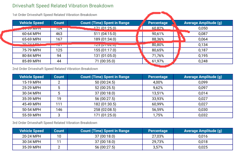

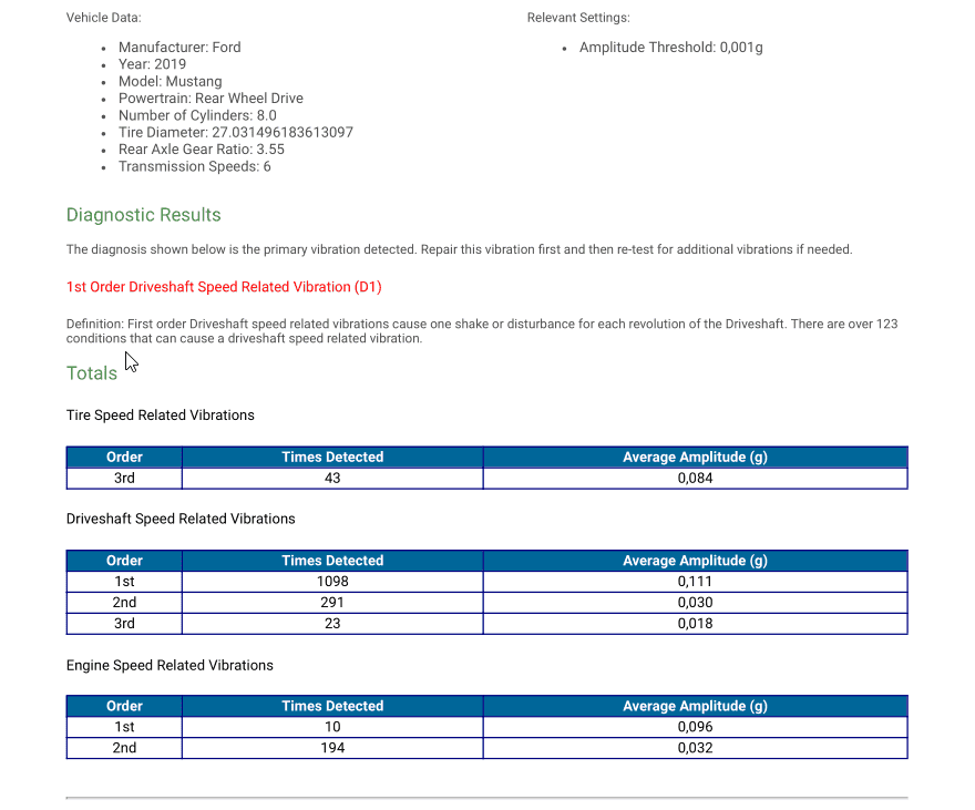

Below is an example of an analysis I did with the software on my own car. In this example I’d driven about 19 minutes on the freeway (Autobahn in Germany, of course, for legal reasons) and something that spins at the same speed as the driveshaft (and which gives 1 vibration per rotation, i.e. imbalance, 1st order vibration) is what gives the most vibrations, percentage wise.
It says transmission speeds 6 for unclear reasons, but in this particular case it does not matter because the vibrations are the same regardless of which gear is used. If you have vibrations that seem to stem from the engine, it is more important to get the gearing of the transmission right.
It’s also possible to break down the info into additional steps. For example, what percentage of the time the vibrations are detected as a percentage, see below.
In the example above, you can see that the vibrations from the part (driveshaft itself, most likely) that spins at the same rotational speed as the driveshaft are registered about 80-90% of the time at "normal" motorway speed.

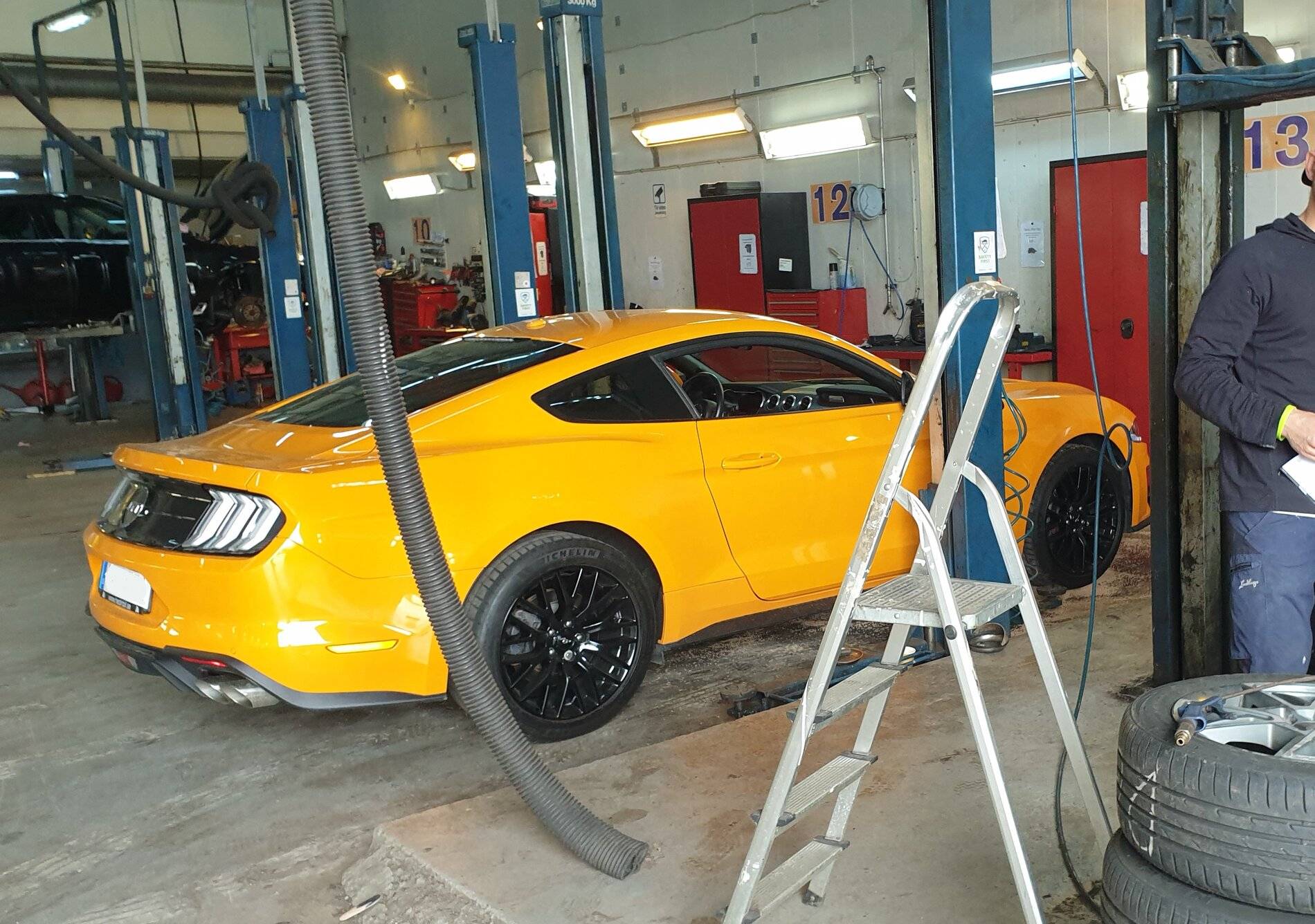

So, just had the car in at ford for hose clamp balancing.
Short story is they weren't able to do it. Nothing's fixed.
I'm gonna try another dealer.

The slightly longer short story is that they measured the driveshaft etc, in accordance with the Ford Service Manual, and found that everything was within spec. They drove the car (again and again) and couldn't pinpoint where the vibrations came from. They therefore did not try even the hose clamp method. Since there's only licenced dealers in Sweden (not "real" Ford dealers per say) they were unwilling to do any work on the car that they were unsure that they would get paid for. The particular dealer I went to with my problem had very little (or any) experience dealing with vibrating drivelines. I should have understood this earlier and just gone with another one, but Captain Hindsight arrives late sometimes (for those of you who get the South Park reference).
I've managed to get hold of another dealer that (I think?) is the one that sells the highest number of Mustangs per year in Sweden. It's about a 2 h drive away from here, but I figure it's worth it if they can fix it. I rang them up and the technician I talked to on the phone had fixed around 20-30 vibrating Mustangs. In 95% of the cases a simple hose clamp system balance method had fixed the problem. In the one's that he couldn't fix they exchanged the entire rear "axle lump" with the diff, rear axle etc etc, since that had been the culprit in 4-5 cases and (surprisingly) not the driveshaft, at least on the newer cars.
He'd gladly take a look at the car and give it a try. I've booked a new appointment with him instead. They were very busy before summer vacations and the first available appointment was on june 29. I'll provide a new update after that.
