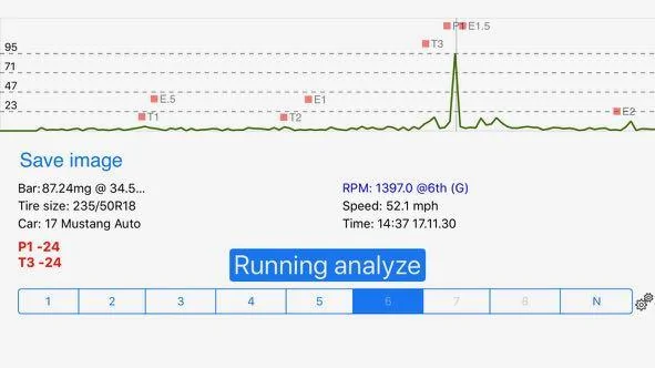

Thanks for the advice but I've driven it all day and... it's worse than before they replaced the diff assy.
Did make another discovery though. I showed the plots from the NVH app to my friend who owns a driveshaft shop. He noticed that the software is picking up three different vibs at the same time: 1st order DS, 1.5 order Engine and 3rd order Tire. He suggested that there could be some coupling happening.
