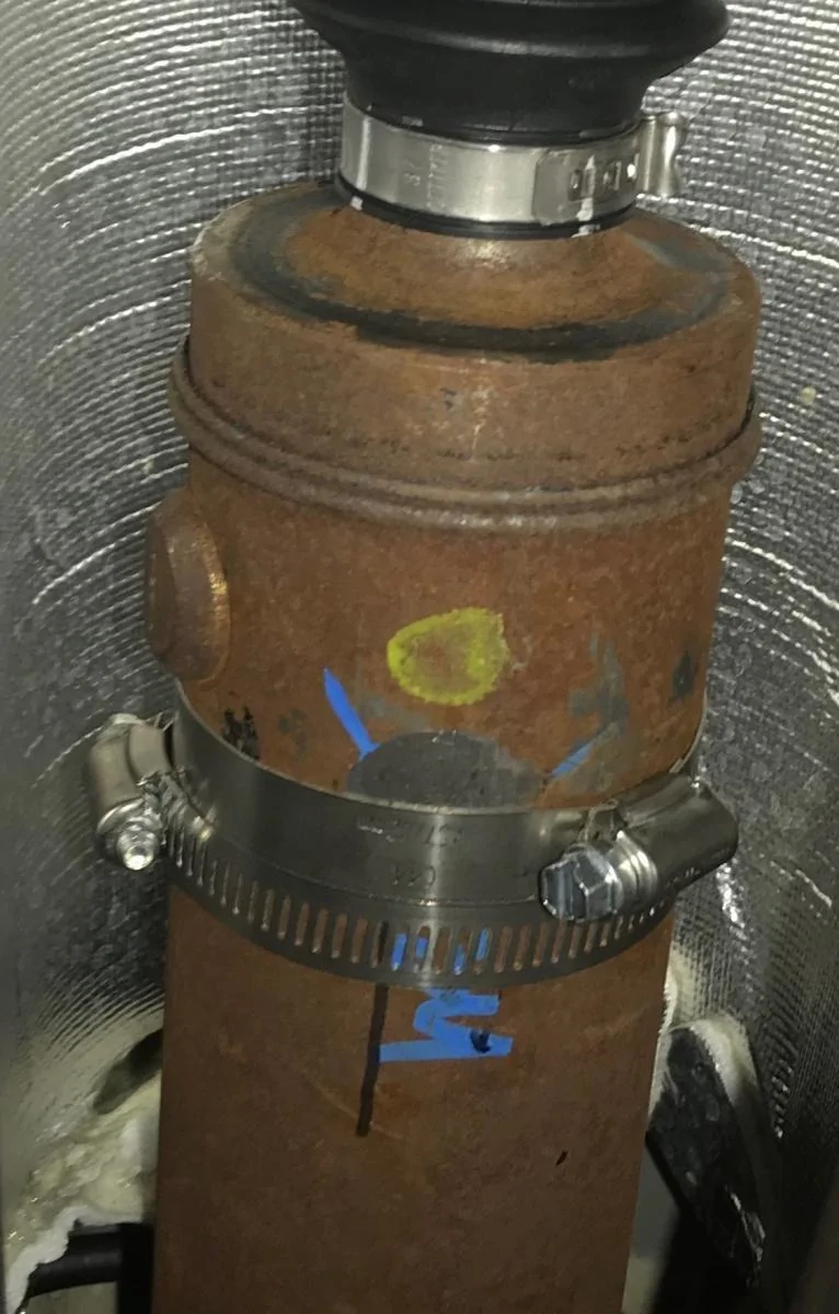

Well good news on this front, I took the car in this morning to have the engineer from Ford look at it, and had the car back by 5pm vibration free. Guess I really did need to try that second hose clamp.... They used the vibe tool, balanced and bam, no more vibe. Two hose clamps installed.
You can still somewhat hear this deeper rumble. But it never changes, especially at speeds 80+. (Prior DIY attempts with one hose clamp only solved things at the 50 to 70ish range). And there is no more steering wheel / window / rear mirror / radar detector vibrations going on, so thats a huge plus.
Overall everyone was very helpful and nice about it. I was given a new 18' F-150 as a loaner, and am really enjoying the vibe free car. I would say if your looking to get your mustang fixed by Ford, but the dealership is not doing anything about it, call BBB Auto line, open a case about driveline vibrations and things start to move a lot quicker.
People are reporting the vibes coming back sometimes, you should take a paint pen and draw a line across the clamps and driveshaft to see if they ever move out of position.
I was actually just thinking drawing the line would be a good idea if the vibes ever came back. I did see where some guys went another 1,000 or so miles and it returned.
