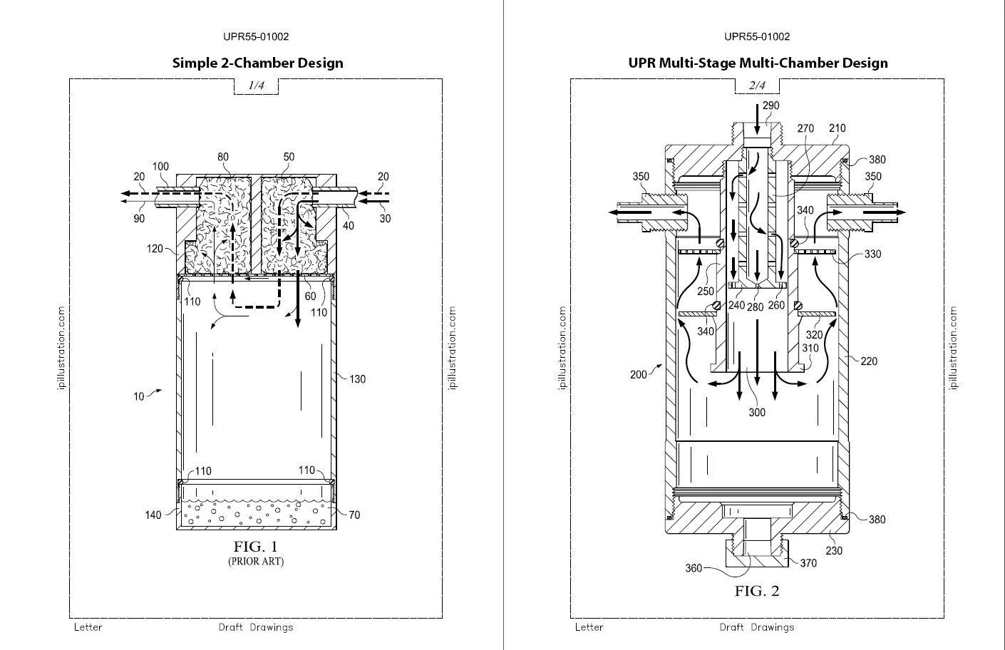

Here is the technical drawing difference of UPR's system vs. a traditional condensing unit which is what the ford performance unit is.
Personally i have been very happy with the UPR in terms of quality and OEM look and the fact that its tucked out of the way. The only downside IMO of the UPR is that they don't give you any installation instructions. Now its not rocket science but isn't 100% obvious from pictures either. A one page set of instructions would go a long way to speeding up the install.
