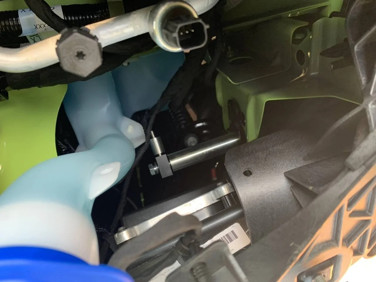

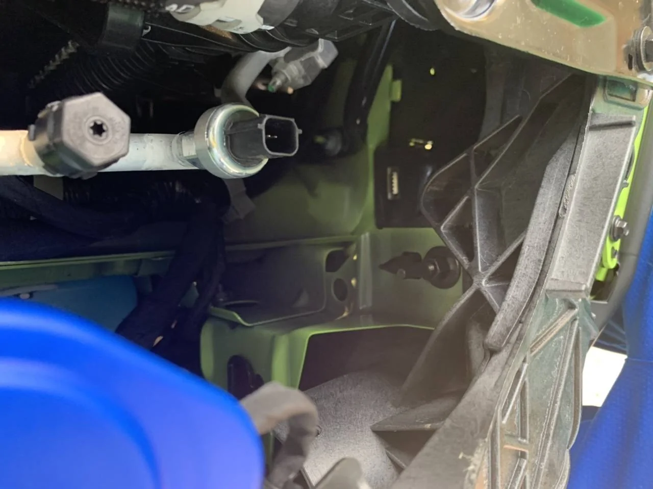

Guys,
Anyone have a UPR catch can setup on a ‘19 or preferably ‘20?
I feel like Ford may have moved some bolts around as the one it’s supposed attach to is awfully close to washer reservoir. I don’t think can is going to fit the there properly. I can barely get a socket in there to tighten down the mounting arm
Theres a youtube video and some pics i’ve see it look like the can sits over to the right about 6 inches and a bit higher.
Pics for reference. The second the one is where I think it should go.

The 2nd pic is where it goes, I just installed mine a few weeks ago. You will need to remove the stud as well.

Exactly. That is how mine went on in my 19. Installs nicely
