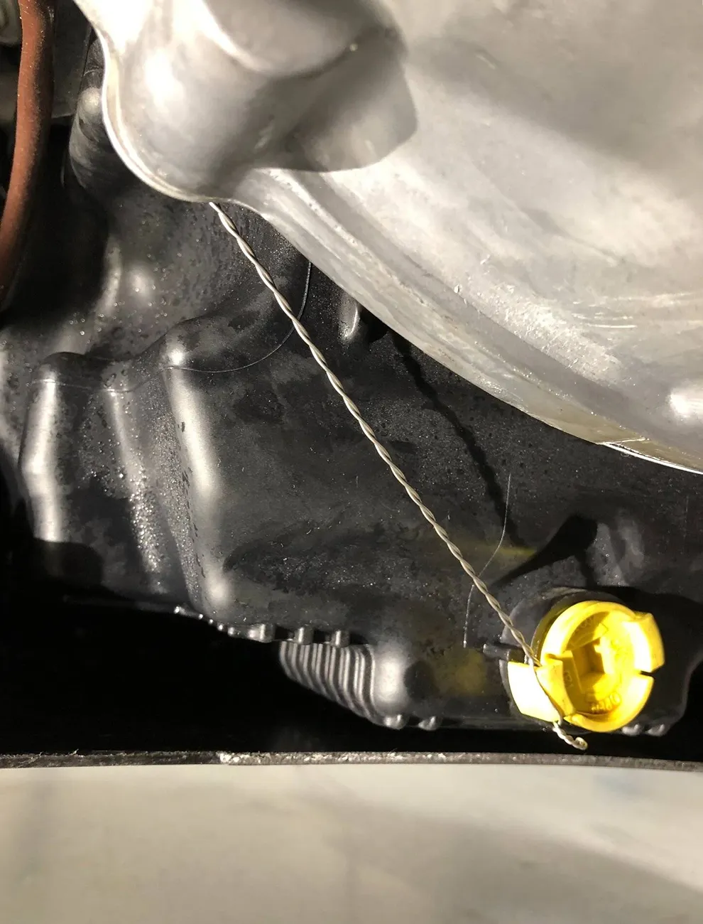

Oh, and you can also safety the factory plug as well!
