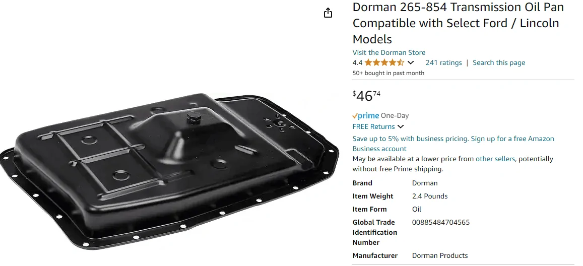

What are your thoughts on this aftermarket transmission oil pan with a drain plug? Has anyone installed one of these? I am thinking of installing one of these for quick and easy fluid changes every few track days. Also, if I routinely do an oil drain and fill without changing the filter would that cause any issues? I have a transmission service scheduled and the dealer says they do a transmission flush, but everything I read says to avoid doing that with a 6R80. That's why I'm considering just doing it myself and installing one of these while I'm at it.

I just remove the pan replace the filter. I don't like the idea of a drain plug . I prefer to be able to clean out the pan ,it does collect some fibers. I do it around 60k klm.

I love a drain plug. It makes pulling the pan easier. If you track often you can change fluid and every other time change the filter.

I really prefer a drain plug on the trans pan as well, makes the whole process less messy. That being said I used a Doman pan with drain plug on my wife’s Jeep to replace the OEM pan. The pan was ok but the plug itself never stopped leaking. It wasn’t a small leak either, football sized puddles over night. I ended up returning it and getting an AFE aluminum pan that also had a drain plug and it’s been leak free. I have very little love for Dorman products, working in auto parts I see all the warranty parts that come back.
