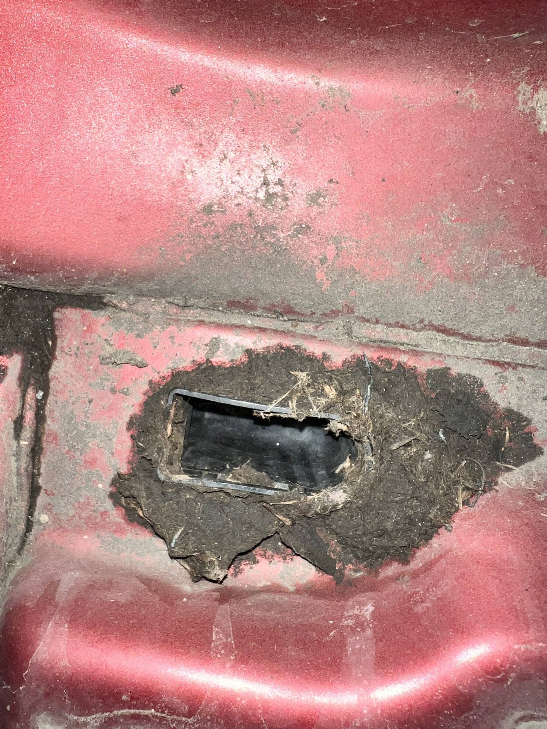

Hi all, first post here unfortunately a bad one, owned my 2017 ecoboost for about 3 months and now have a water leak when ever there is rain, (on the drivers side floor) I’ve been reading endlessly on here and other places about drains , seals and welds etc but most threads are on the US spec cars or convertibles so it’s all slightly different. Before I go to any dealerships this is my last hope to try and find the problem myself.
I’m clueless with cars But can’t find any drainage holes under any covers in the engine bay, pulled out my battery and the duct under that was slightly dirty as if it had water through it but definetly wasn’t clogged, ( picture below). and also I don’t seem to have the stickers on the doorframes like some do. So I’m absolutely stumped and of course my warranty doesn’t cover this so it’ll be coming out my pocket.
any pointers for places to check before I go and get fleeced would be nice, baring in mind I’m Right hand drive

Did you dump water into the drain in your pic to make sure its not blocked? I ran into the same issue where my passenger floor was flooding. That drain was clogged and I have to stick my finger down in there to push out the little leaves that got caught down there.

pushed it throigh and it just seems to be an empty cavity underneath

Try dumping water into there and see if you hear it hitting the ground. If it's flowing straight to the ground, they you should be good...unless the water is coming from somewhere else. When I took my battery tray out, there was a good 6-8" of water under it. I have not had any water intrusion after cleaning out the drain. Hopefully you get this figured out. Good luck!

is this infact a drain then yeah? I’ll give that a go tomorrow and see what happens, cheers 👍🏻👍🏻

Yup, that the drain for the cowl. You should be able to hear the water hit the ground when you pour it down there. It drains behind the front tire. Let us know how it plays out.

Spot on cheers mate, meant to be raining tomorrow so might be a job for the weekend or next week, will update back if that’s the problem

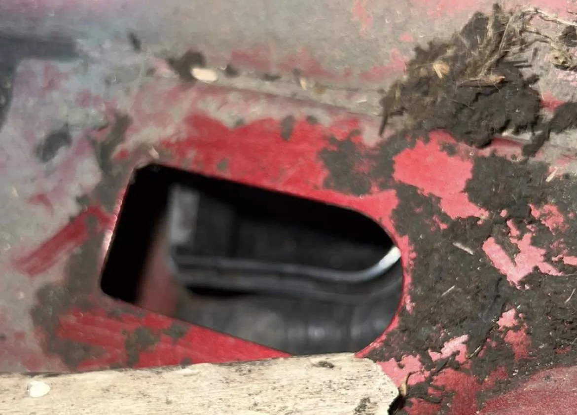

Looks like a lot of debris residue there likely plugged just water test it then get an air nozzle wrapped with rag to seal hole and blow the junk out.
good shout but wouldn’t really have access to the air hose lol, I’ll try and get a long wire to clear it out possibly
