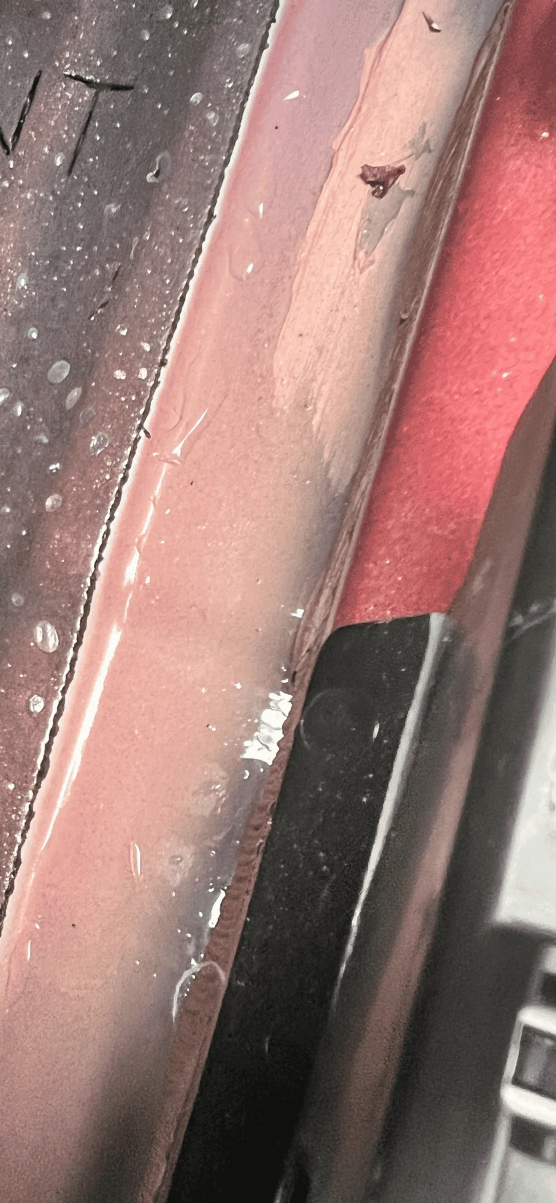

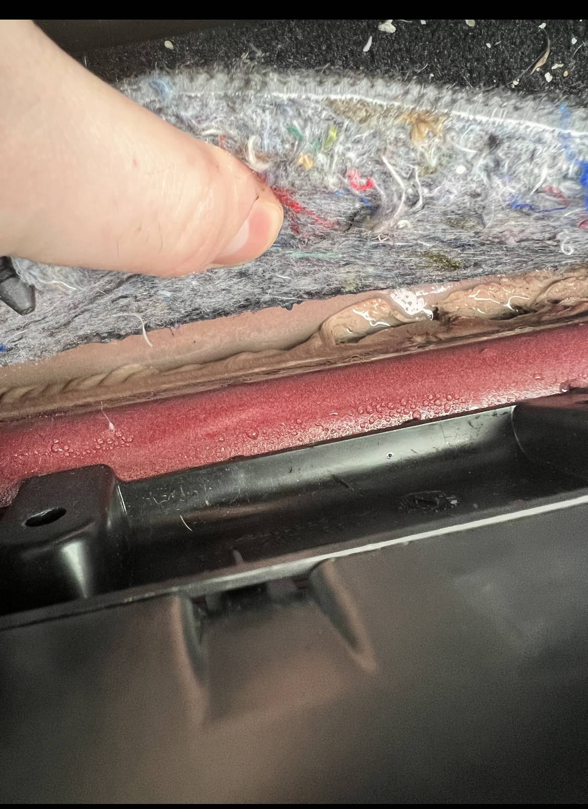

Cheers for that Kristian87, don’t really suffer from too bad condensation to be honest it’s more just pure wet floor when it has rained, praying it’s only a drain over flowing and I’m not needing to get the whole cabin re sealed as that looks
££££y, I’m gonny go and try clear out this drain under the battery tray and see where I am after that before heading to the dealer. That being said when I lifted up the carpet, the seal along the bottom of the floor/side wall isn’t the cleanest of jobs with lots of small gaps so it may well be that this is my problem too.

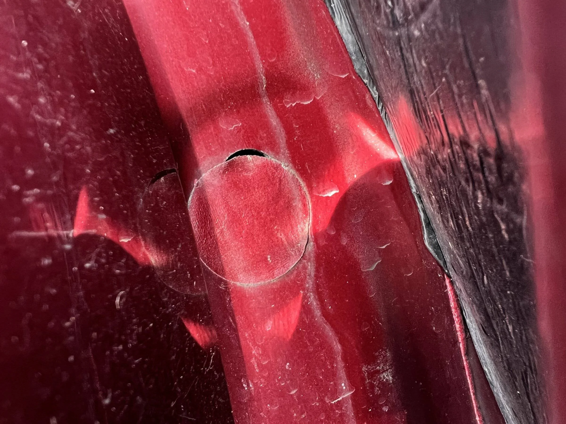

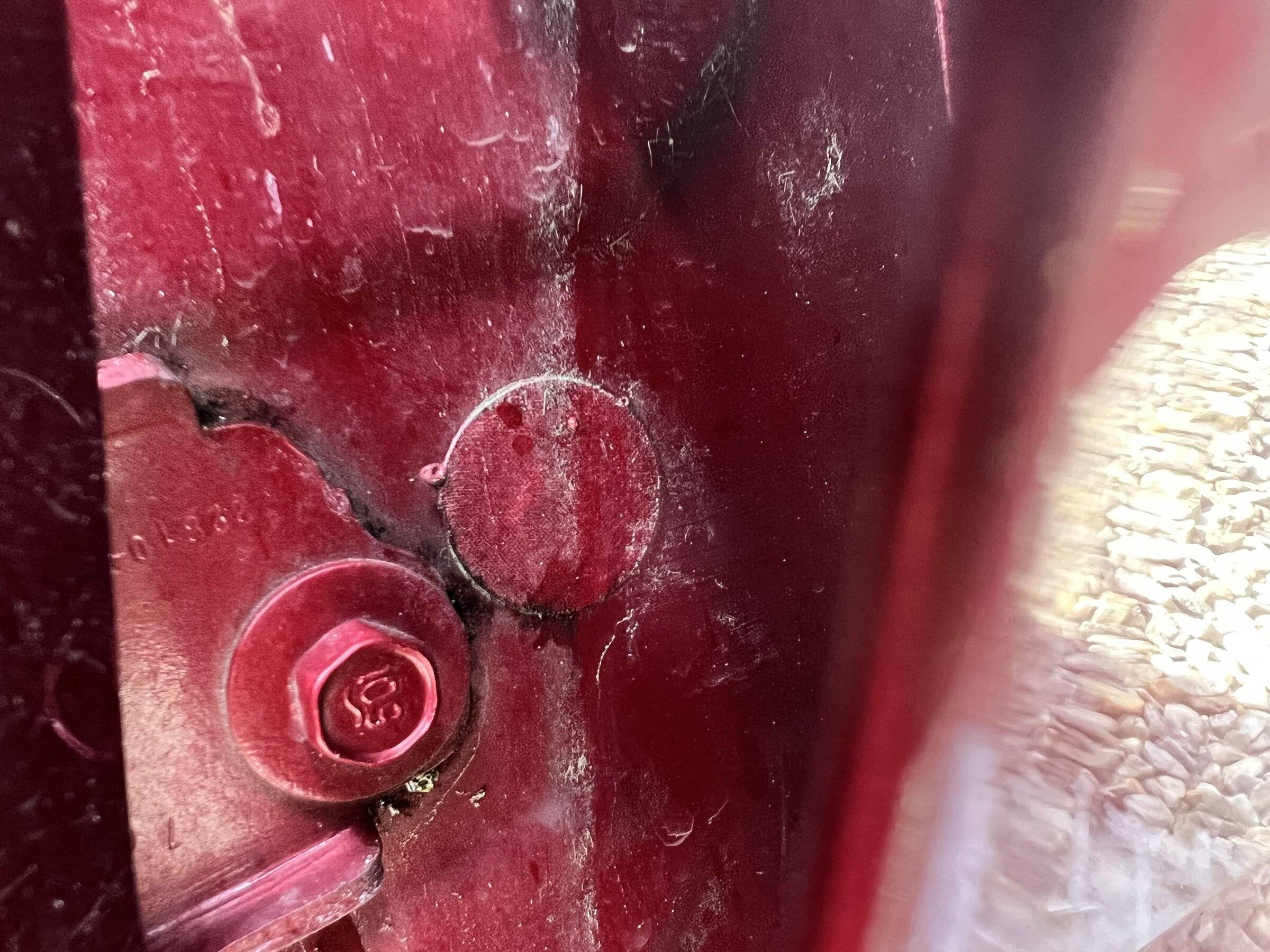

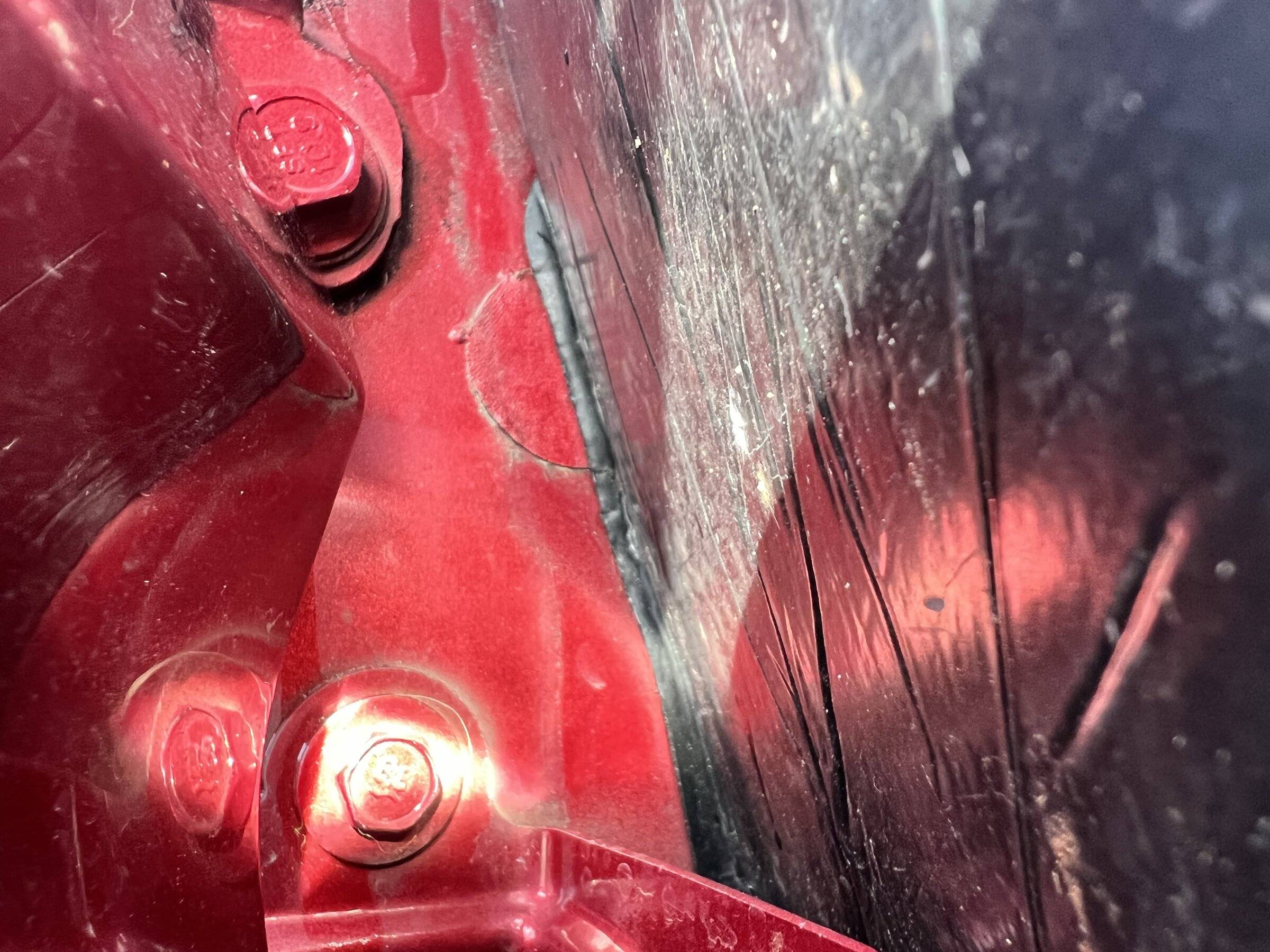

Well hopefully I’ve found the culprit here, had looked a few days ago but obviously not well enough, Turns out I do indeed have these daft stickers and they are just weltering away. So I’ll get these holes sealed up and keep an eye on the situation.

Good find :like:
I don't think they have failed, it looks like one of those was never stuck on correctly in the first place ... :frown:

I didn't mean that as in they were still good and not leaking.
I meant that they hadn't failed with age / use.
It looks like it was a failure to apply one of those properly in the first place i.e. its leaked from new :like:

I’ll get some gromits in them and seal it up with silicone and see where we are after that
