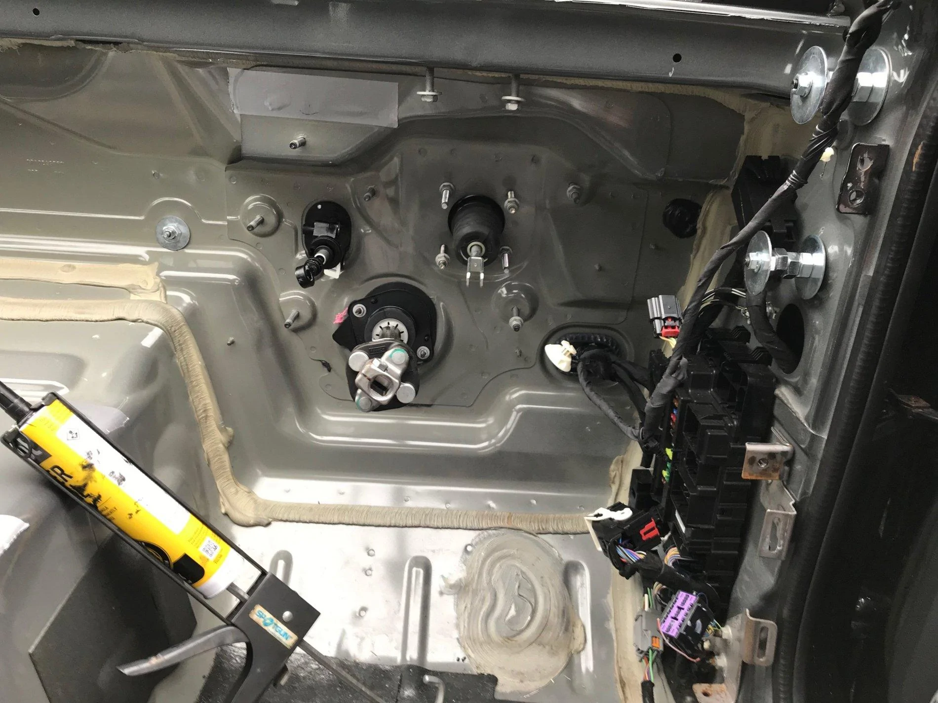

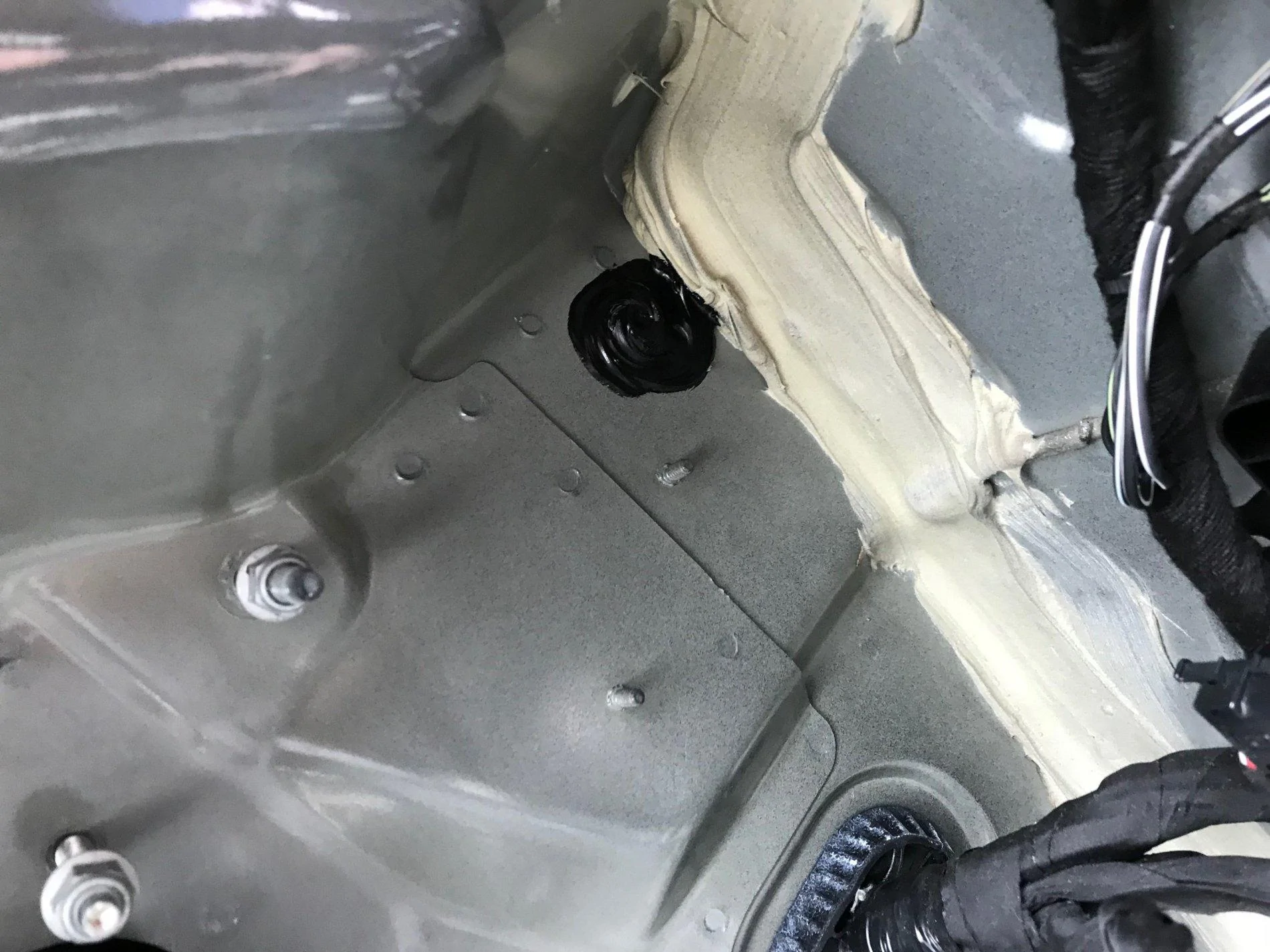

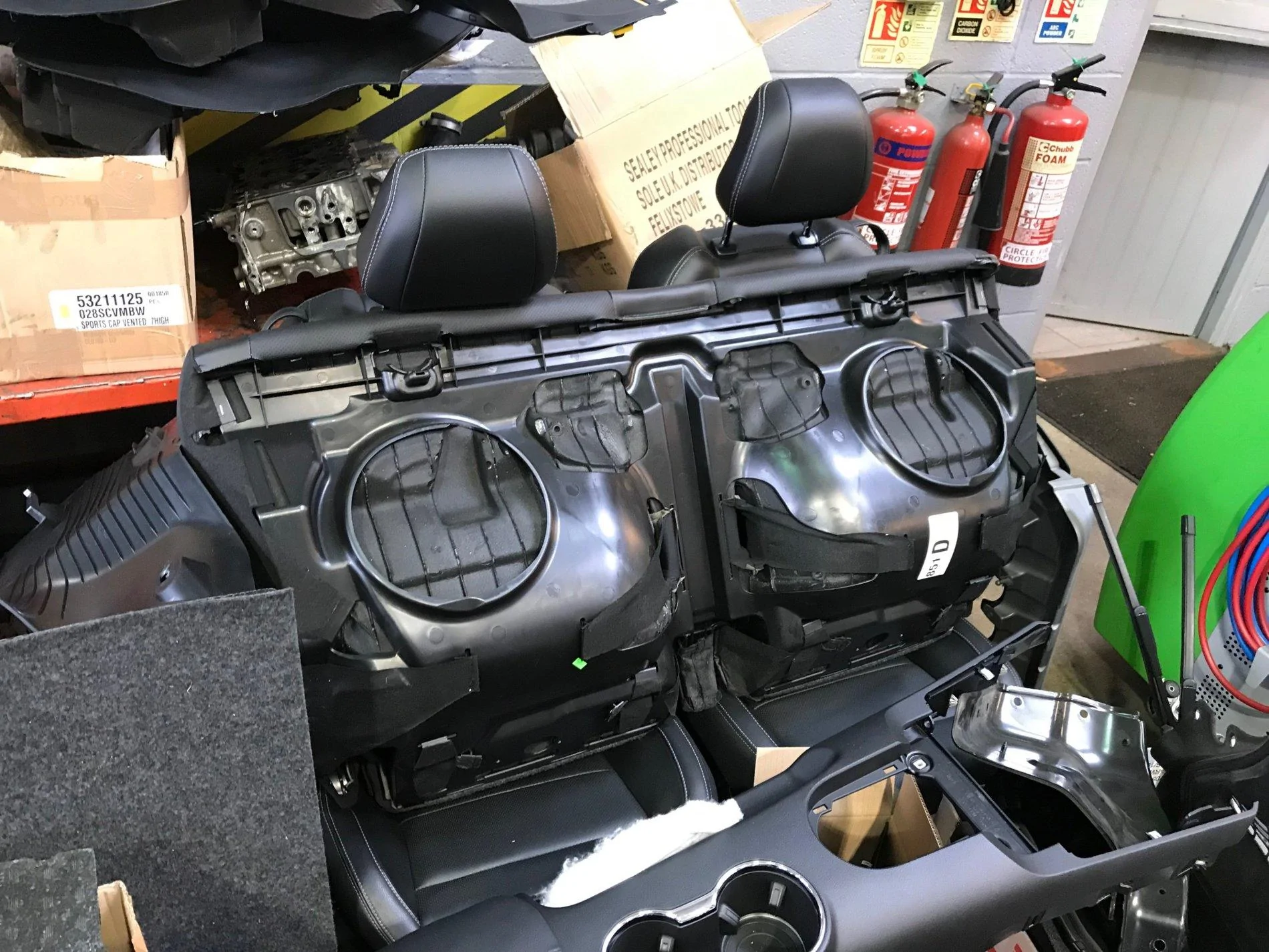

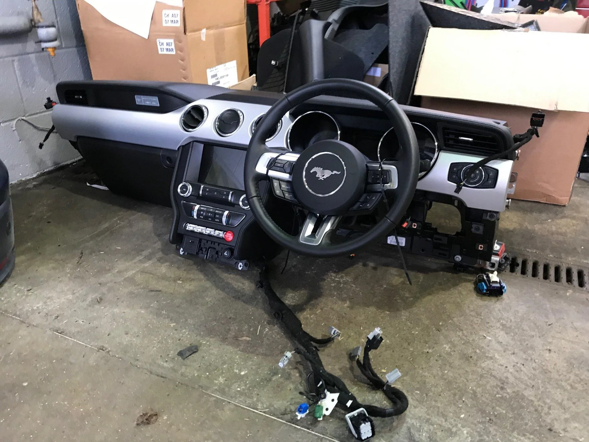

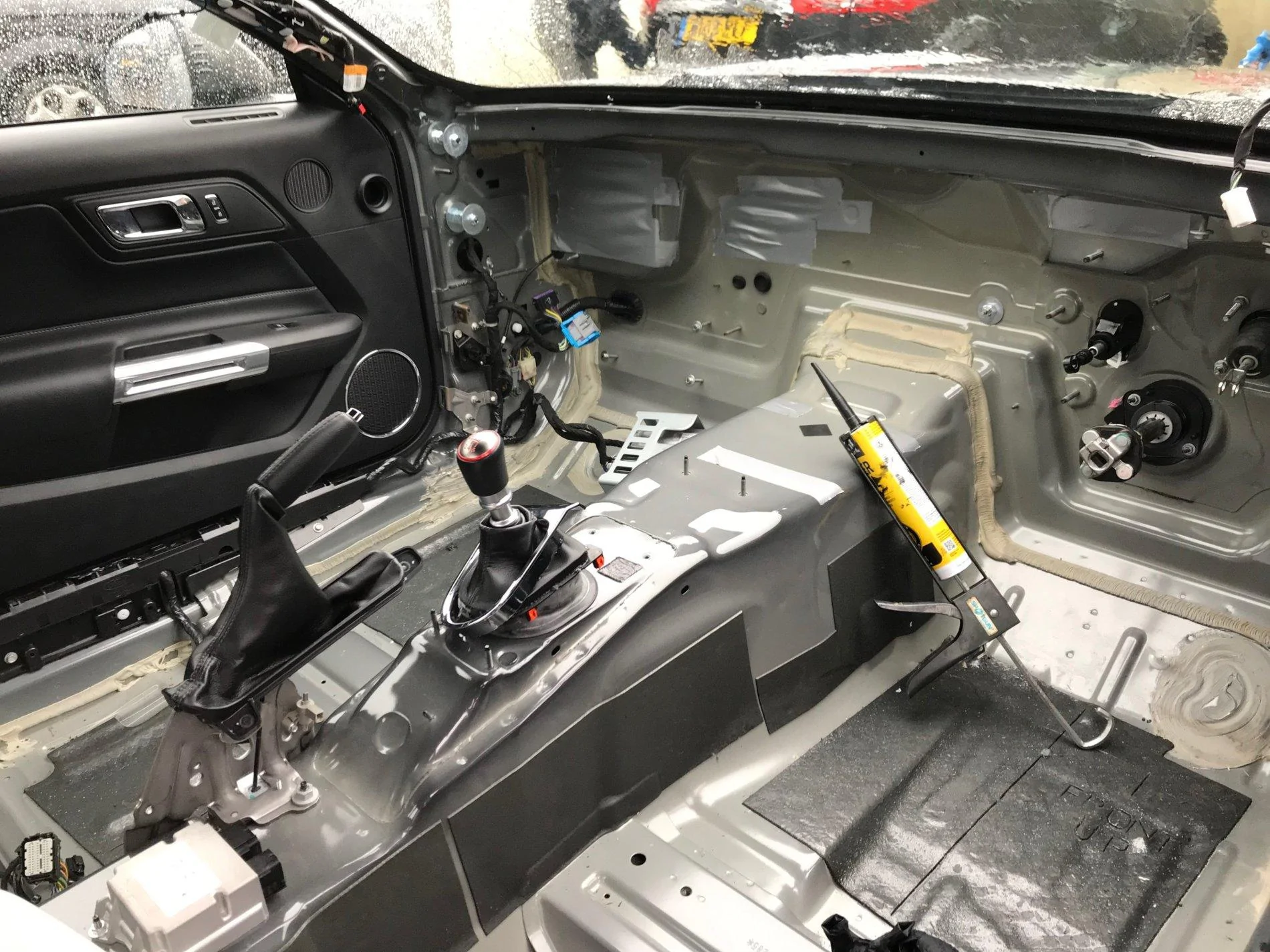

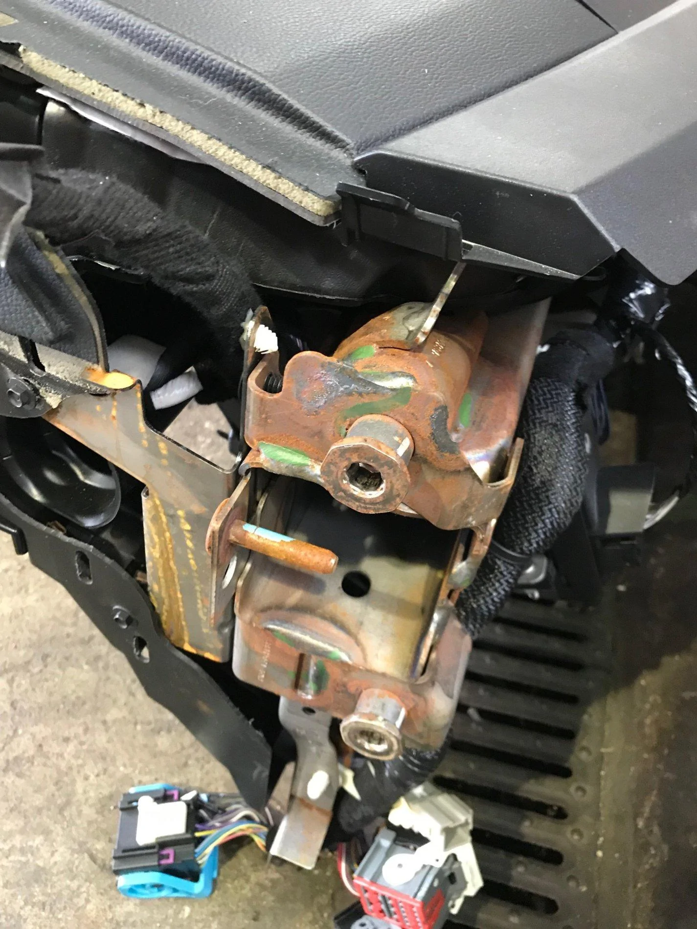

Today was a good day. Status = leak is fixed.
I've said it before but these guys in Hungerford are brilliant. I really experienced that in full today - they've done an outstanding job so far, couldn't be happier - all things considered!
To sum up the fault here - it's that "known issue" of that crappy firewall grommet. Only through some "extreme water testing" (as they put it), could they see the water come in through a tiny gap - basically poor design. For me, as I say in a previous post - the extended period of time combined with outside storage & plenty of washing, a little drip here and there amounts to a decent amount of water getting in. The biggest issue that caused me was obviously the wiring loom damage, but secondly - as I learnt today, the sound deadening behind that dash was essentially holding on to whatever water did get in, hence my consistent condensation. All makes sense, and was a weight of my shoulders to see it for myself.
The sound deadening & carpets are still soggy, so they are drying at the moment. The next step is to replace the damaged wiring looms, ensure everything is 110% dry before it goes back in, then reassemble the entire car! One concern is the surface rust on the structural bar that the dash assembly is attached to. That needs to come apart to replace the wiring loom so I've asked that they attend to that. As I said to them - it would make me uncomfortable knowing the metal is in that state once the car goes back together. So still a large amount of work to do but I'm glad it's on the way to going back together now.
Ford have a lot to answer for on this...
Anyway...of course I took some pics!
Close up of the now sealed grommet (tiger seal on both sides - a few layers). This was done last night, and since then - no more water coming in.
A wider shot - grommet towards the top right hand corner. If you look at the purple terminal connector for the wiring loom - you can just about see the corrosion.
The bare interior! Pretty much the headliner and gear knob was all that remained
Surface rust on the dash assembly
Dash on the floor, with the rest of the interior :)

:like: Its taken a long time but glad you have finally got somewhere with this! As horrible as it must be to see your car like that, at least you can see things are being done properly. Fingers crossed for some proper compensation.
These pictures could be invaluable for anybody who suffers similar problems in the future. I have to admit this is the first time I have really understood the location of that grommet. Out of interest, whats on the other side of it that would make additional cleaning an issue?
Exactly why I'm keen - and happy to share it all. I drove myself crazy trying to find similar stuff online when I didn't quite know why I was still having issues, so I'm hoping this will be of use to someone. Other side? Meaning the engine side? I didn't see it but I think it was just a case of sealing it as best as possible, short of welding a piece of metal on there!
