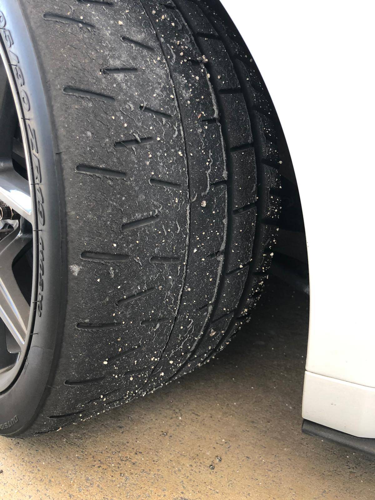

Sportlines worked great at PBIR. car felt really planted. no bottoming out or drama coming into the brake zones or coming WOT out of a long turn anything. put down 1.09 lateral Gs. No rubbing or anything. tires were a dream.
with 2.8 front i got pefect wear. i started at 25 PSI cold. warmed up to 32. Posted a 1:40 flat with a few uninterrupted laps.
