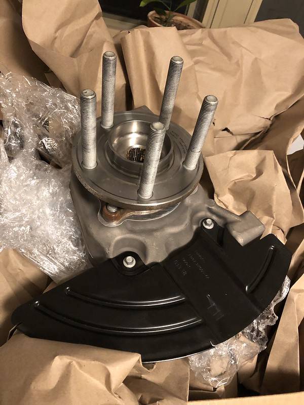

How long are those studs? They look longer than the ARP ones I haveGot my long stud wheel bearing setup in the mail the other day:
GT350R_Hub-01 by clair_davis, on Flickr
They came attached to GT350R spindles, so that setup is providing some food for thought. Initially will just swap the wheel bearings and throw a spacer on there and ponder how much trouble I'll generate trying to incorporate those aluminum beasts. FWIW, 18.5# for what you can see in the photo.
The portion you can see is 3.395", tip of stud to hub face.How long are those studs? They look longer than the ARP ones I have
Sweet. I got my bearings/studs today and you can tell they’re shorter. They’re just the standard 3” offeringsThe portion you can see is 3.395", tip of stud to hub face.
I think if I didn't have Magneride, I would have gone that way. The Optimum Performance stud set looks good, too:Sweet. I got my bearings/studs today and you can tell they’re shorter. They’re just the standard 3” offerings View attachment 418247
