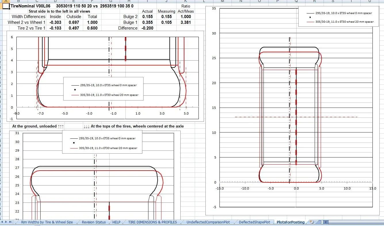

I'm seeing your 305/30 setup needing just under 1/8" more inboard room at the max tire section width and about 5/16" at the wheel flange. These are nominal dimensions but I could run a similar plot if I knew the actual tire dimensions on their respective measuring width wheels (tire makes and models is usually enough for me to find that information).
The plot considers tire dimensional changes if not mounted on the measuring width wheel and the spacer thickness as a separate data entry.

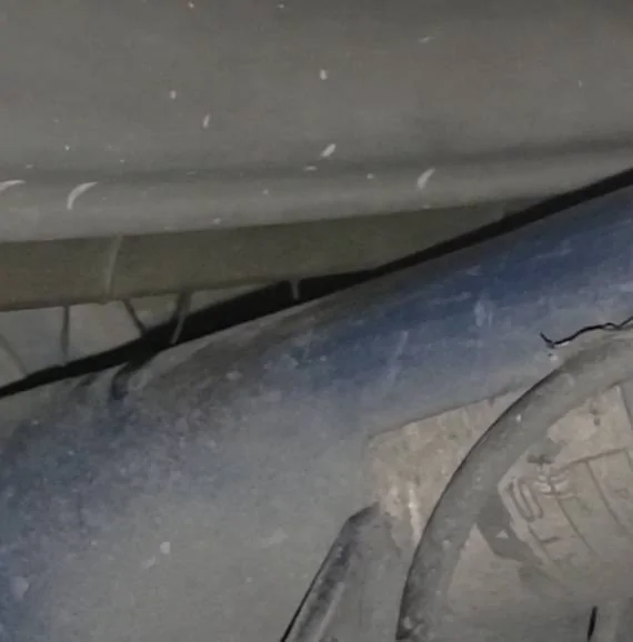

Hey all, I have a question that I'm not really sure can be answered but I'll ask anyways. I checked my tire to strut clearance again last night to remind myself how close it was. Its close enough that I wouldn't want it any closer.
How close?

How close?
I can't measure with the suspension loaded, way too tight in there. Best I could do was use my phone and record a video. Let me get a screenshot and upload it.

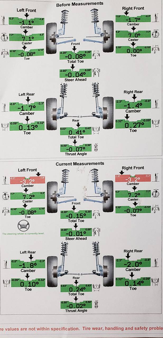

No probs man. The attached pic is with "normal camber" and theres enough room to throw a party up in there. Here are my Before (like the posted picture) and after (track) specs.
The after specs has a clearance very similar to the strut picture you posted. Hope that helps.

Have you tried your setup with a normal camber? I won't be running that aggressive of a camber for my car.
unless you're doing camber with bolts (don't) it doesn't matter what the camber is. The whole assembly is pivoting together.

Great feedback and question. What concerns me the most is contact with the fender if the tire protrudes too much. I honestly don't care too much about poke at least not from a "how it looks" perspective. The current clearance right now I can barely fit my hand between the tire and the top of the fender well. I'd hate to come off an HPDE session (whenever that ever happens again) and find that stuff is damaged.
As for camber, I am trying to stay as close to stock as I can within reason. -1.5* of camber +/- 0.8* is what 2morrow shows above which sounds about right. I believe @NightmareMoon touched on how these cars get finicky about camber changes and I'm not experienced enough to really venture into custom alignments at this moment.
