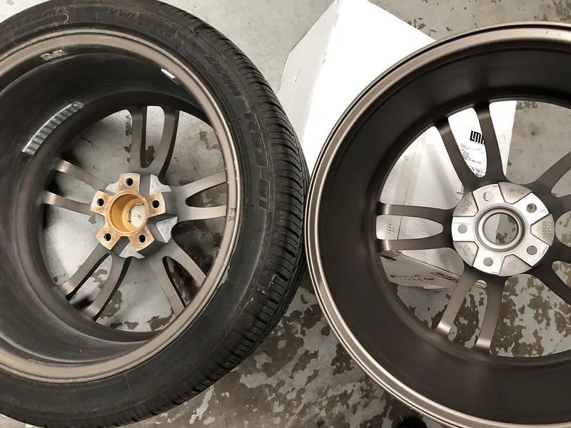

So, I tried to check this and ran into a snag - the 10" SVT GT-7's have a very different mounting face than the 11's. The difference in the pockets between the lugs is enough that I couldn't mount the 11" wheel to the hub. The stock lugs were longer than the 1" spacer plus the much smaller gap between the lug holes:

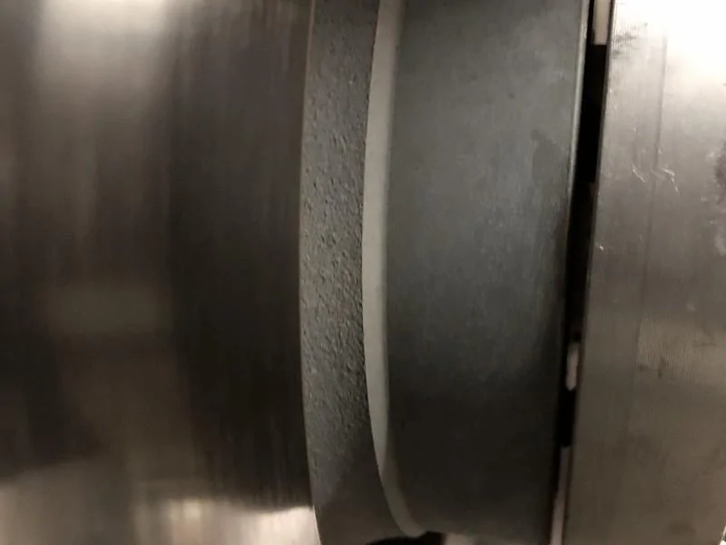

This resulted in a fat 1/8" or ~3mm-ish gap:

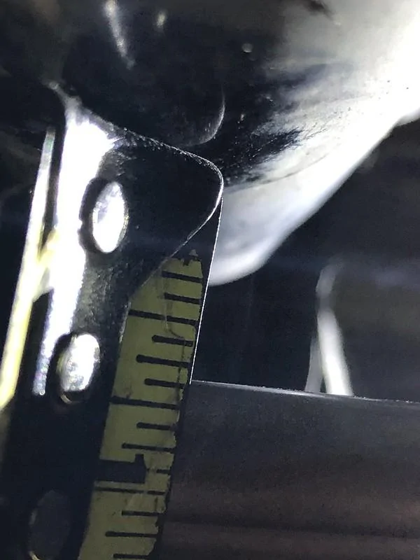

I went ahead and rotated the wheel on the hub to get the gap to settle down, and took a couple measurements anyway. Looks like an easy 1/2" clear between the wheel edge and the strut body with a 25.4" spacer in place:

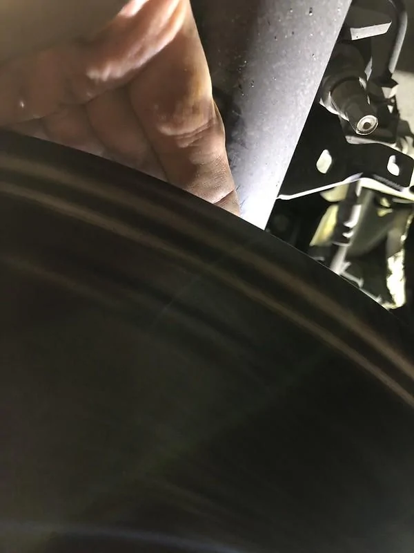

Plenty of space to slip your fingers between the strut and wheel, probably if you removed the 1/8" gap as well:

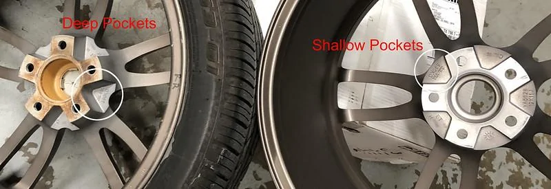

19x11_Fit_Check by clair_davis, on Flickr
I'm afraid I'm not following this very well either. For starters, can you circle up what you mean by "pockets between the lugs" and explain a little about how they might be keeping the wheel from going that last eighth of an inch?
Or is it the center hole in the wheel not machined correctly and the wheel hanging up on the hub's center?
19x11_Fit_Check by clair_davis, on Flickr.
This picture is with a spacer or without one???

The 11" GT-7's are cast & machined differently on the hub face than the 10" wheels, so I couldn't bolt them up properly with the 1" spacer/adapter I used. The spacer is one from my parts bin and has a 4.5" bolt circle, but has lugs pressed in and uses lug nuts to attach to the axle flange. When the adapter is bolted to the axle lugs, the axle lugs extend past the face of the adapter interfering with the wheel, so the wheel can't bolt down properly.
With 11" wide or wider wheels you want the thinnest spacer that works (i.e. no strut-side rubbing).

Pic of the area that is different. Had the 11" wheels been deeper between the lug holes like the 10" wheels, I wouldn't have had to explain how the test didn't work perfectly and to not spend money on what I was reporting.

All measuring pics are with spacer - and gap - in place.
It looks to me like a 20mm spacer will probably work with maybe 5-7mm clear to the strut, but for me to actually bolt these wheels up and verify, I have to have the long studs installed.
Now I get it.
FWIW, those adapter-style spacers make me uneasy since you can't check the torque on the spacer's own lug nuts without removing the wheel, and then you get to retorque and later recheck those.
I'm seeing about 17mm clearance, so minus the 3mm gap gives 14mm. 5mm less spacer makes that 9mm, subject to tolerance/measuring accuracy. Should easily be OK for 305/30's, might be a bit tight for 315/30's.
