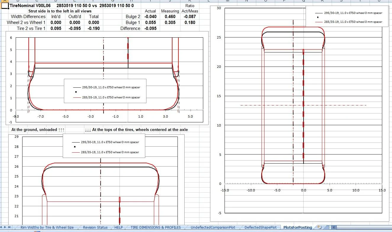

Ok so would you think the 285/35r19 would look taller and fuller Than my current set up? Falken Azenis 295/30r19? or would I’d be at the same level of tallness from the 295/30
A 285/35-19 will be nearly an inch taller than the 295/30-19, or about half an inch more sidewall height. The 295 tire will have just a little more sidewall curvature (can't really call it 'bulge' for either size). Both sizes are slightly 'stretched' relative to their "measuring widths", an inch of stretch for the 285/35, half an inch for the 295/30. This is generally a good thing for turn-in response and steering precision, at a little cost in terms of ride quality.

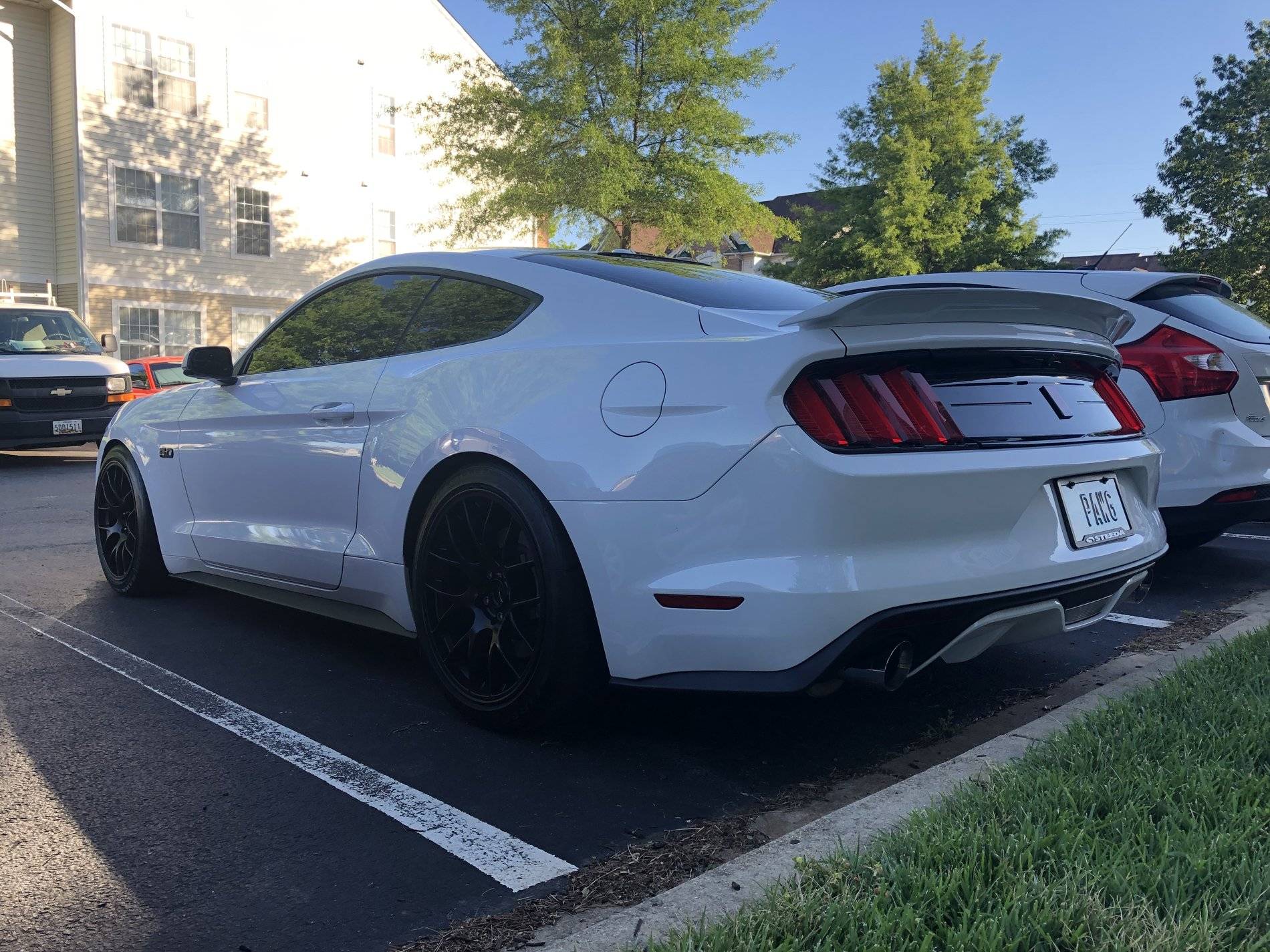

In real life, the 285/35 on 11 will look about like this (the difference between my 18" wheels and your 19's is irrelevant as far as sidewall shape is concerned).
