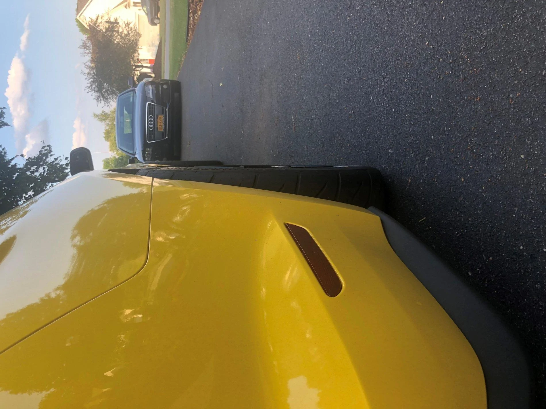

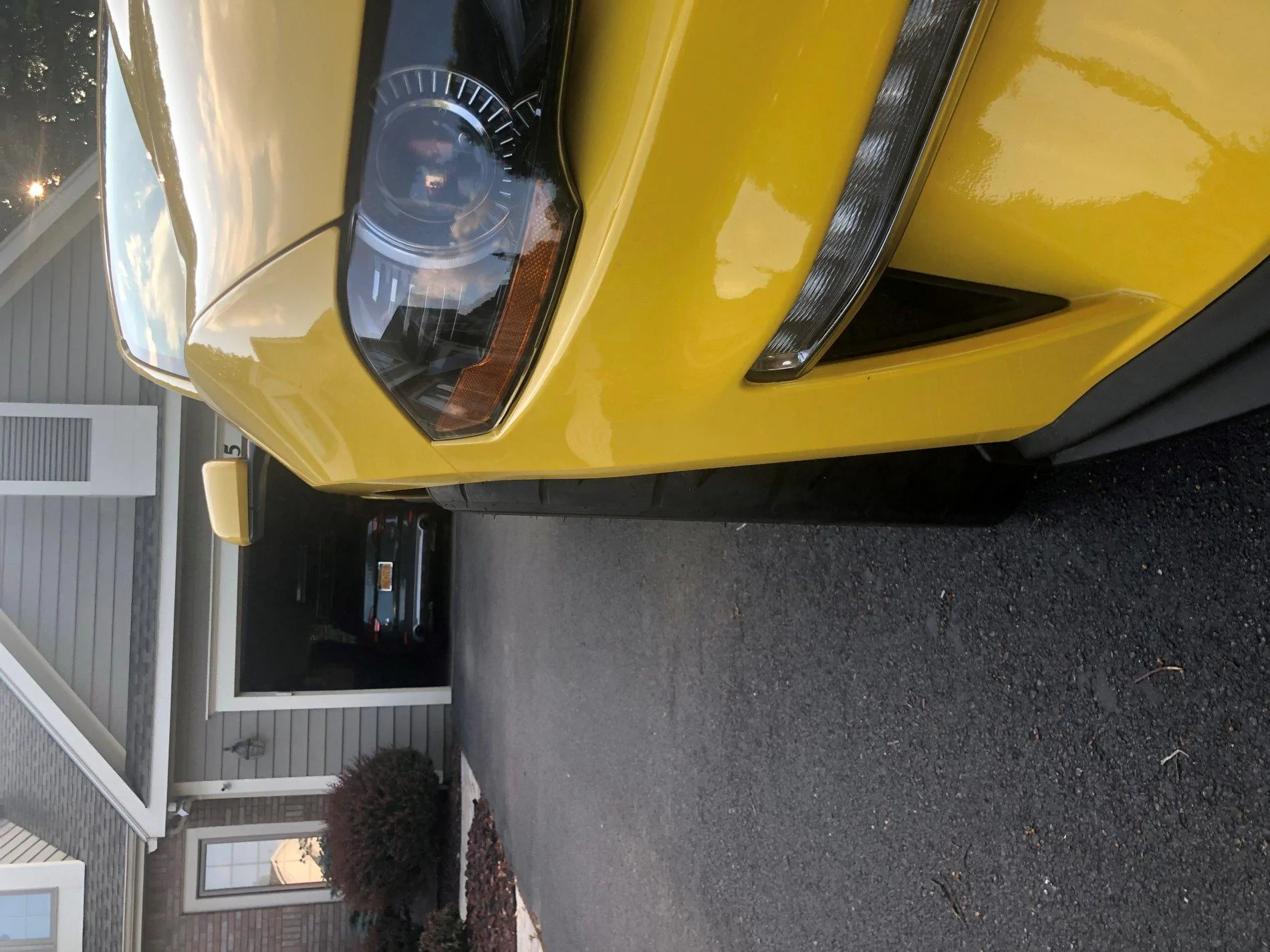

2015 Guard GT Base, M/T
Square 19x11 50 mm offset SVE SP2 Replicas.
I went with the long studs and spacers.
ARP 100-7733 1" longer than OE
CJ 1" spacers
Tires 305/30/19 RE71
Need MOAR front camber!

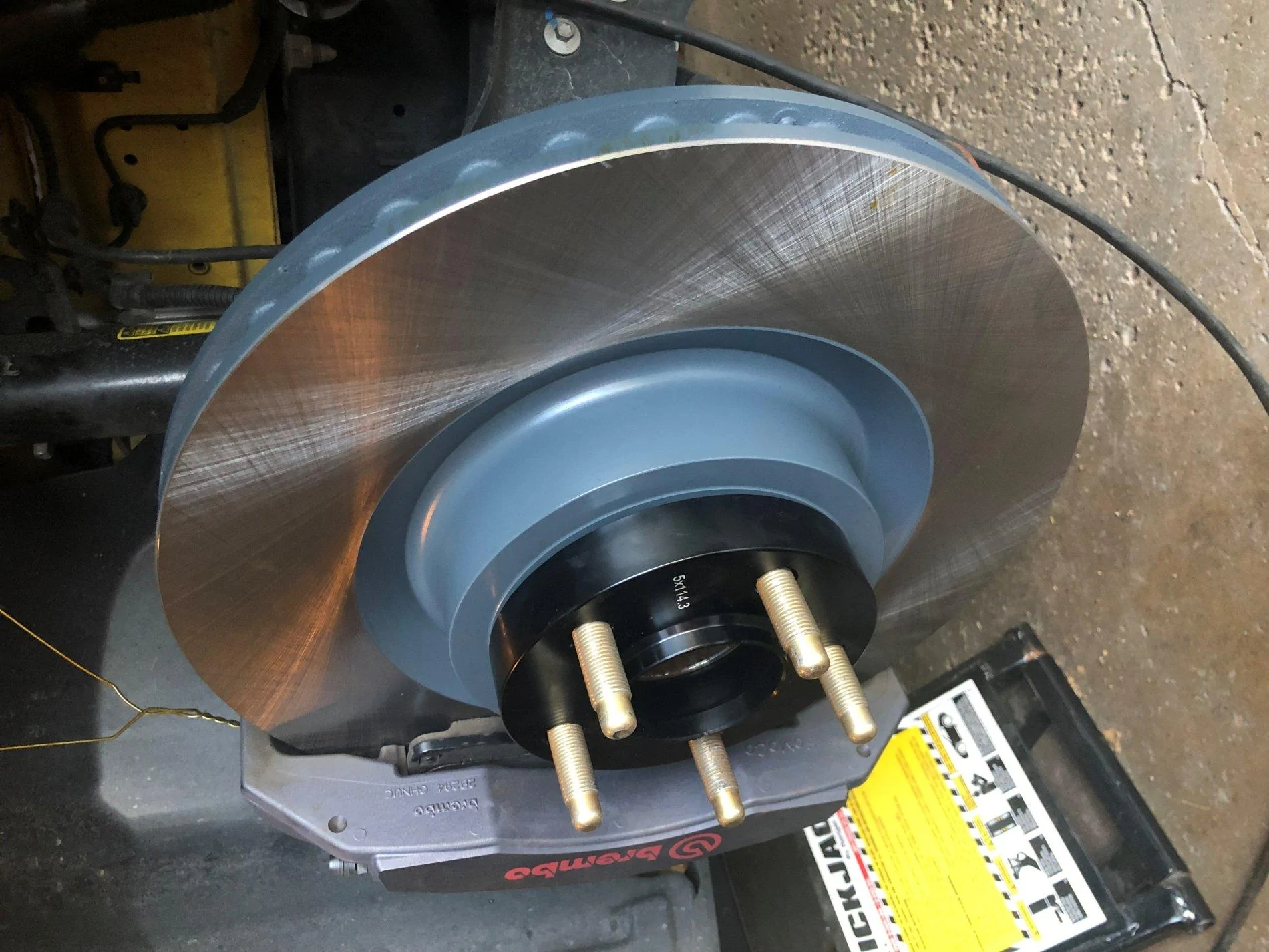

Fantastic! Such clean parts - did you put new rotors on for this upgrade? :)
Also, did you press the ARP lugs into the stock hubs, or did you order new hubs to start with? Looks like the PP1 hubs are cheap enough to think about doing that, or even getting the Ford Perf. hubs with ARP lugs already installed... but the GT350 hubs (with not long enough lugs) are like 3X the PP1 price.

Installed studs into stock hub with Lang 754R - 14mm x 1.50 Threaded Wheel Stud Installer

Another question - this time on the spacers. Did you find that 1" was the bare minimum you could go with, or was there enough clearance to the strut to go with a 20mm spacer? I'm hoping that 20mm will do the trick with your combo, since it will be dang close to mine.
And did you get around to resetting your camber?
Thanks!
With stock style struts, you'll need 25 mm.

Mine are stock style, but Magneride - I don't expect them to be thinner than normal struts, but I haven't gone out to measure mine yet. Maybe I'll go see if I can check that without pulling a wheel... too much work to do lately to spend any time in the garage...
They're not. You'll need 25 mm to ensure clearance.

Got it. That's a good start for me, as I've got some 1" spacers from a previous project that I can start checking things with.
Just for a data point, I finished my office stuff and took a look at the front strut - slipping a digital caliper between the wheel spokes and over the rotor, I measured 2.135". Once I can slip a bare wheel on the car, I'll get some pics of what the clearance looks like with a 1" spacer.
