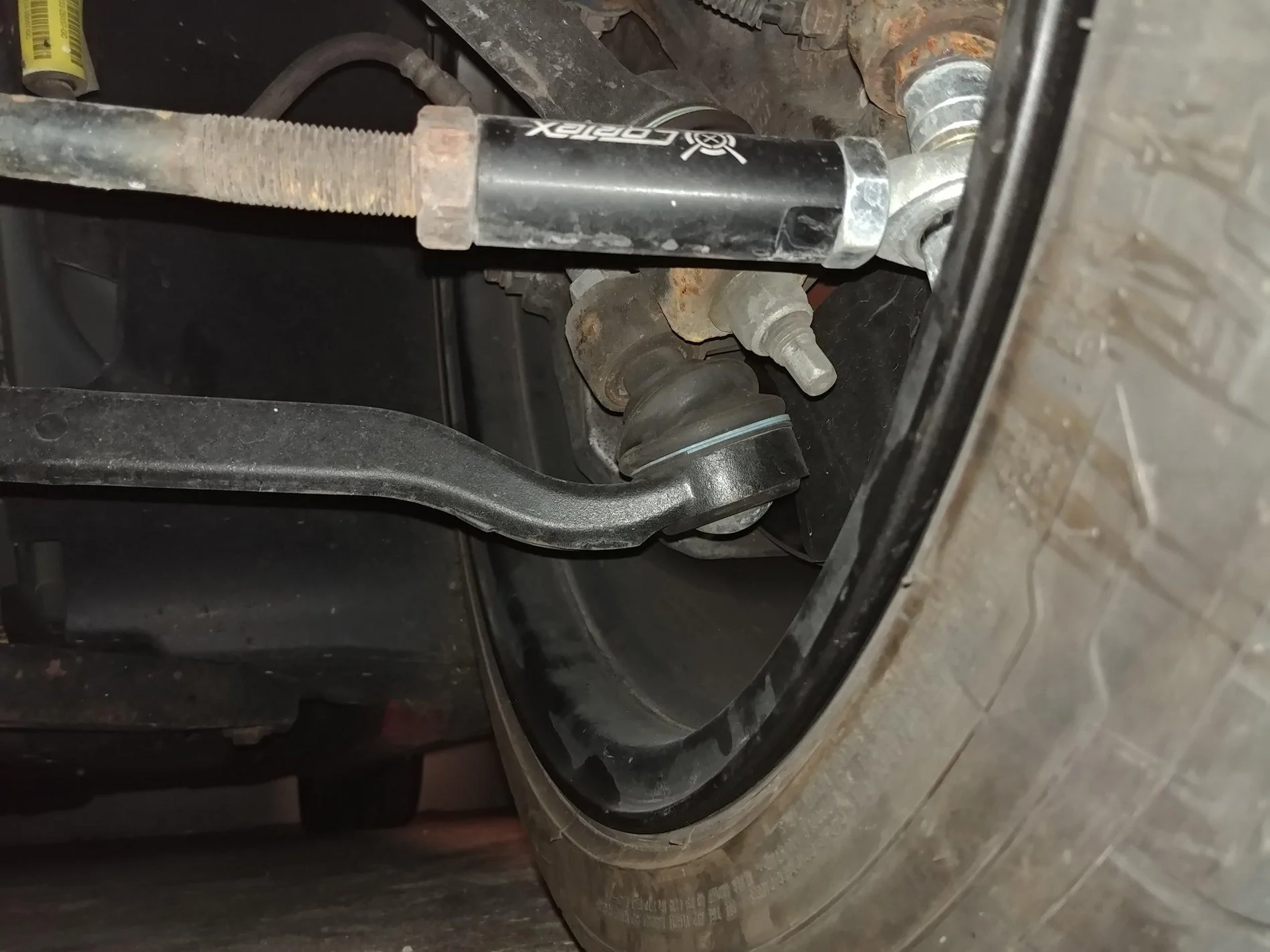

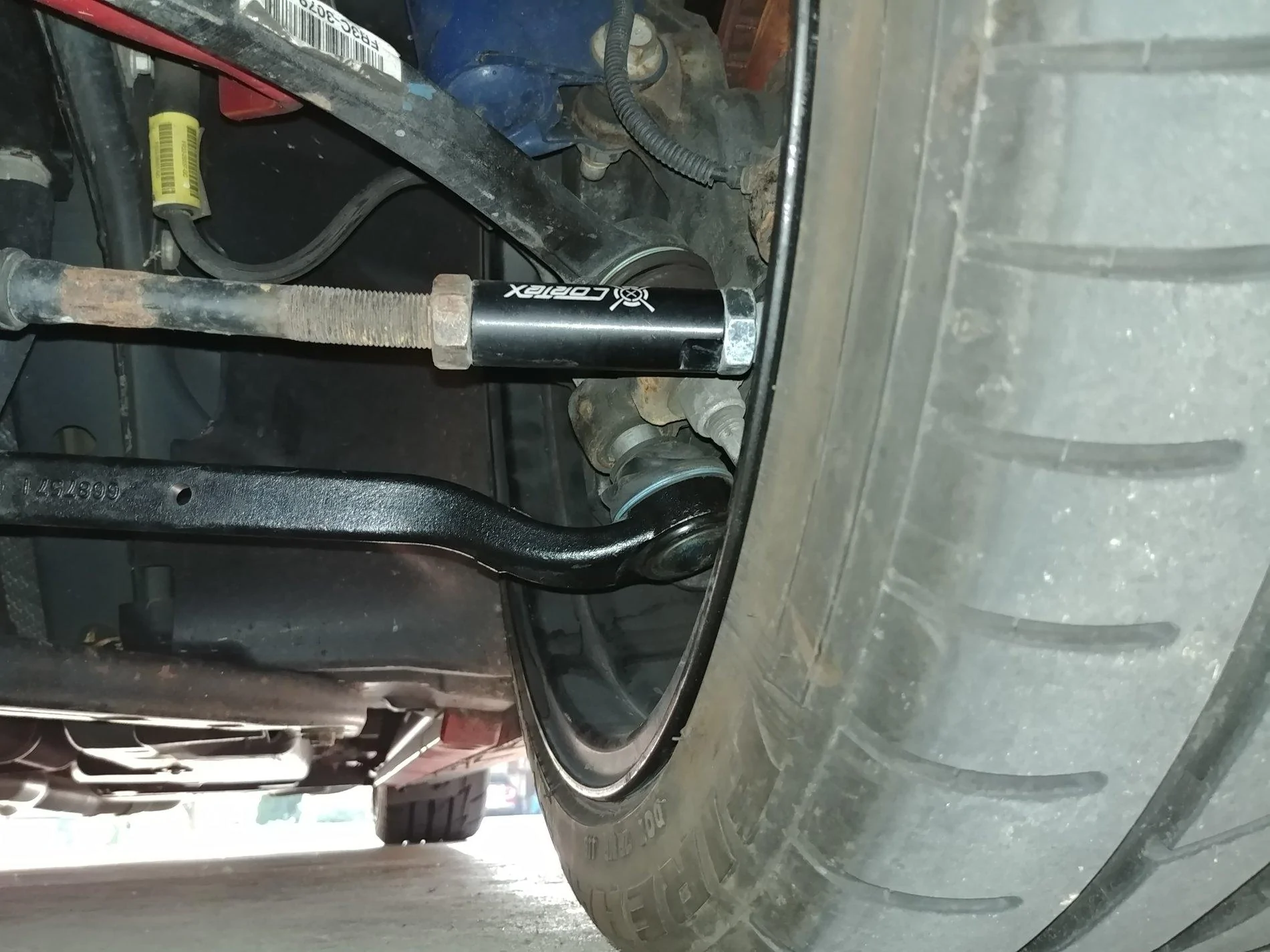

I actually found out why I was not able to get more last night. Let's just say I should fire my chief mechanic. Top: before. Bottom: after. Prize goes to the first one who spots it that I haven't already told :party::facepalm:
What was it?
