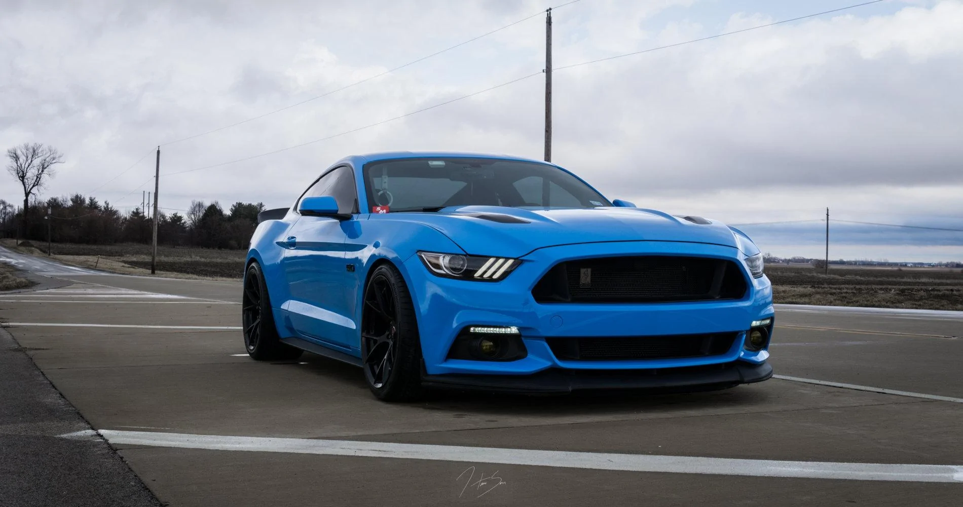

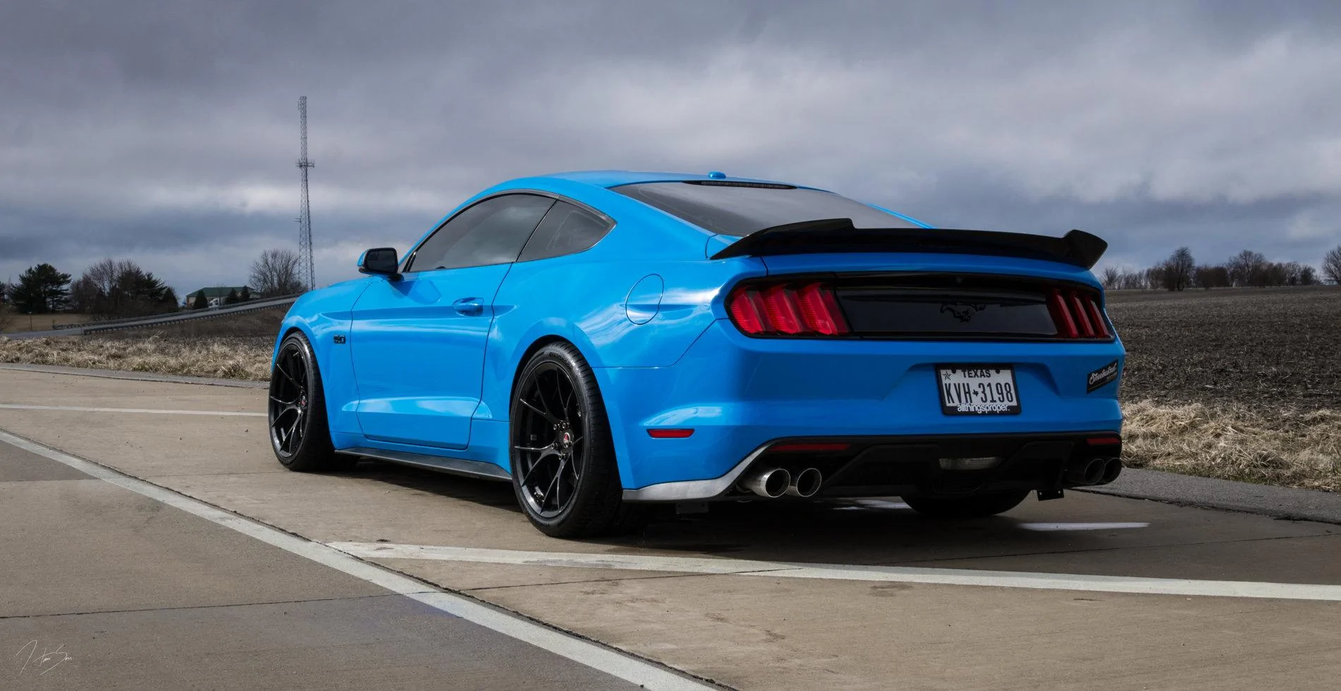

This thread helped me out immensely, so I'll share my two cents / setup.
I went from Stance XR1 coils back to stock struts and CJPP Springs (1.5" front, 1.1" rear drop).
Combined with a BMR camber bolt on the front, I was able to get about -2.8 degrees of camber in the front. Rear is at about 1.5 degrees.
I have P6GR 19x11 +24, 19x11.5 +56, which are specs made directly for the GT350.
Tires are 305/30/19 front, 325/30/19 rear. Excited to throw on some more suspension parts and go to more track days this year. Car was way too low on coilovers and in Illinois, it's much more forgiving to be on springs vs coils for my only car.

Gorgeous car man. Love Grabber blue with black wheels. Your set up looks nice. How do you like rolling on that set up as your daily, was the added expense worth it? Any terrible tire wear or too soon to tell? Do you do a lot of track events or just a handful each year? Sorry I just posted a thread about this subject so ur opinion would be helpful.
Thanks man, I appreciate it. I only do a handful of events a year, and haven't really had a chance to try out this setup quite yet this year. Personally, I think the added expense was well worth it, even just on springs it's a huge head turner at cars and coffee because you don't really see too many mustangs with a 305 up in the front. Tire wear is completely normal after the alignment, since toe and caster are all still in order. Have about 3,500mi on the setup now and tread looks almost new.
@hson10 Got any bright daylight photos of your car? Looks awesome!
Always appreciate it :) here are some pics in bright(er) light! I'll be going out soon to take more pictures when it's sunny
