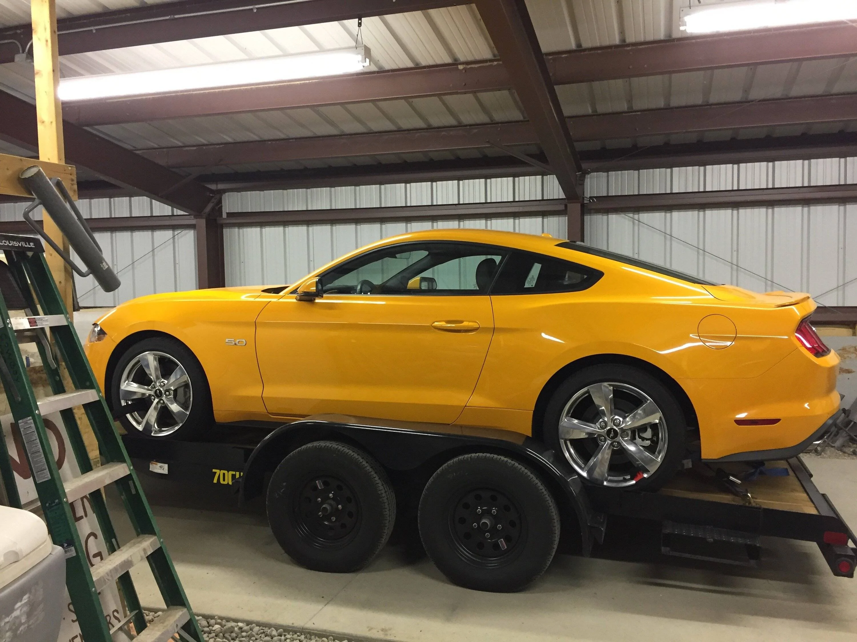

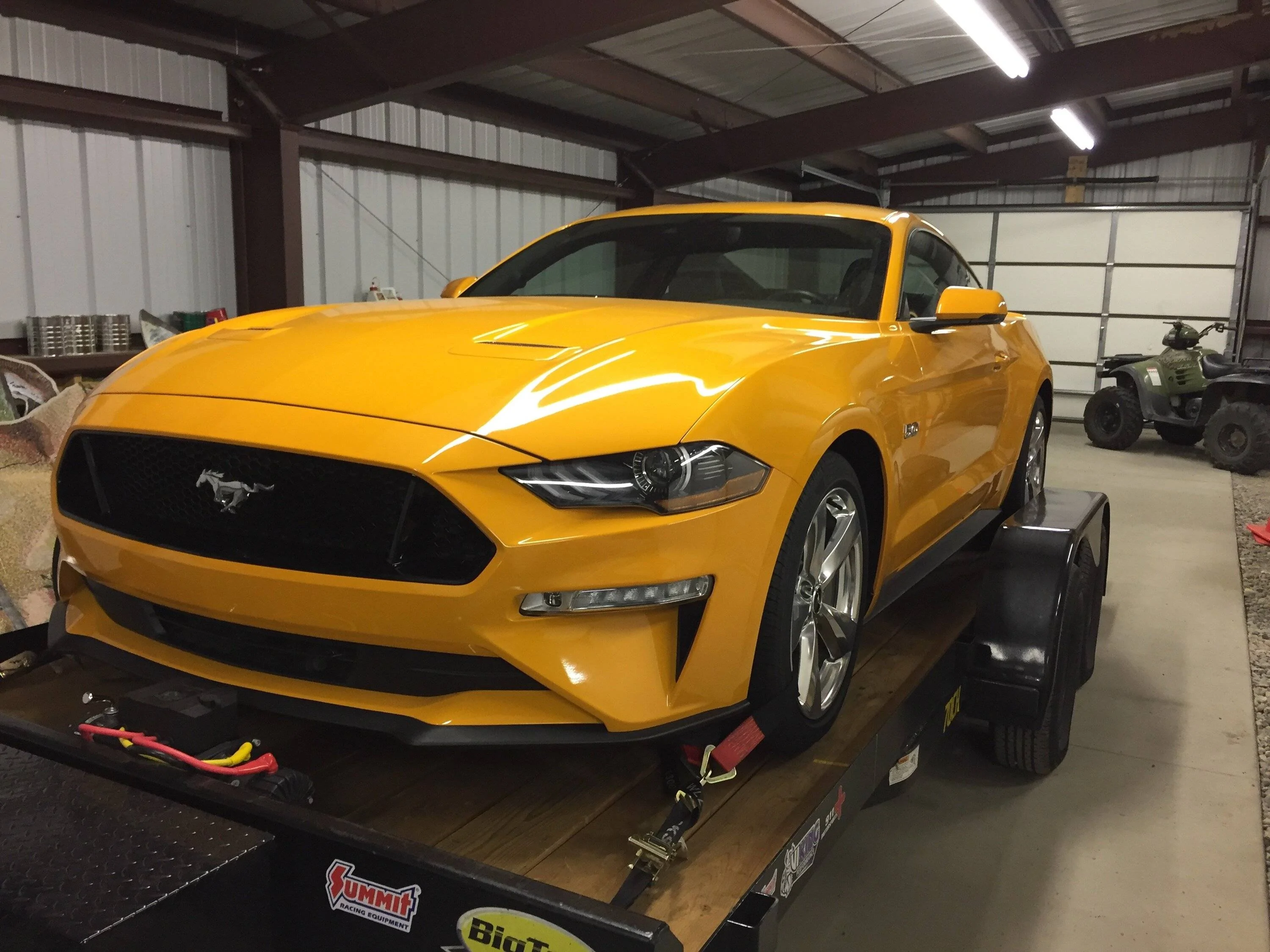

Big Tex CH-70-18 works great for me! Added the winch & tool box, bought 7' loading ramps as my car is lowered.

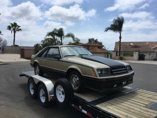

Are there trailers where the trailer fenders sit lower than the doors of a car?
I mean sure, if one has a winch kit, they can offload the vehicle easily enough, but unless you’re a toothpick or a Duke Boy, I can’t see how some folks can get into the vehicle on a trailer like the above image.
Fenders are held on with two bolts, takes maybe 30 seconds to remove it. Door swings open with a lot o' room to spare once the fender is removed.
That's why - when you look for a trailer - you look for one with removable fenders - like CH70 from Big Tex - this was the cheapest trailer in early 2021 in my area and I have one too - over 10k miles on it and so far nothing to complain about. Paid $3200 with spare tire, brakes on both axles, recently same vendor had them for $5k.
For a lowered car you also need to consider ramp angle (and usually get something like Race Ramps) to be able to get it on the trailer without rubbing.
Any trailer will really work for Mustang - just need to be long enough.
