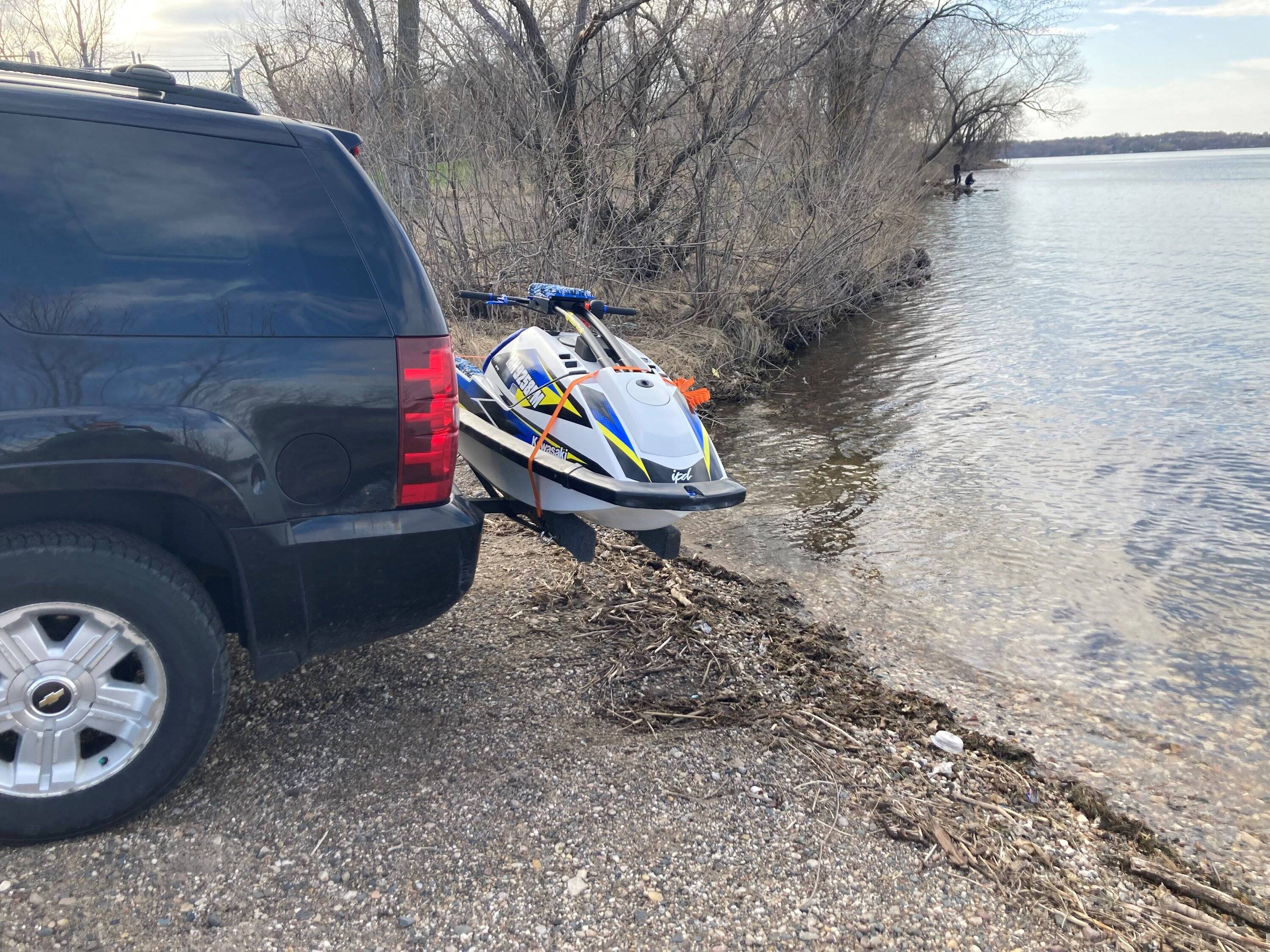

just send it. Sure it adds weight and the car might drive slightly different. I doubt you'd ever notice a difference on the street. As far as handling it, If the receiver is rated for it, it will be fine.
I can put a jet ski on my hit hauler which extends my receiver out 24" and I've still pulled my 3300 pound bout behind it. That's with a factory hitch.
