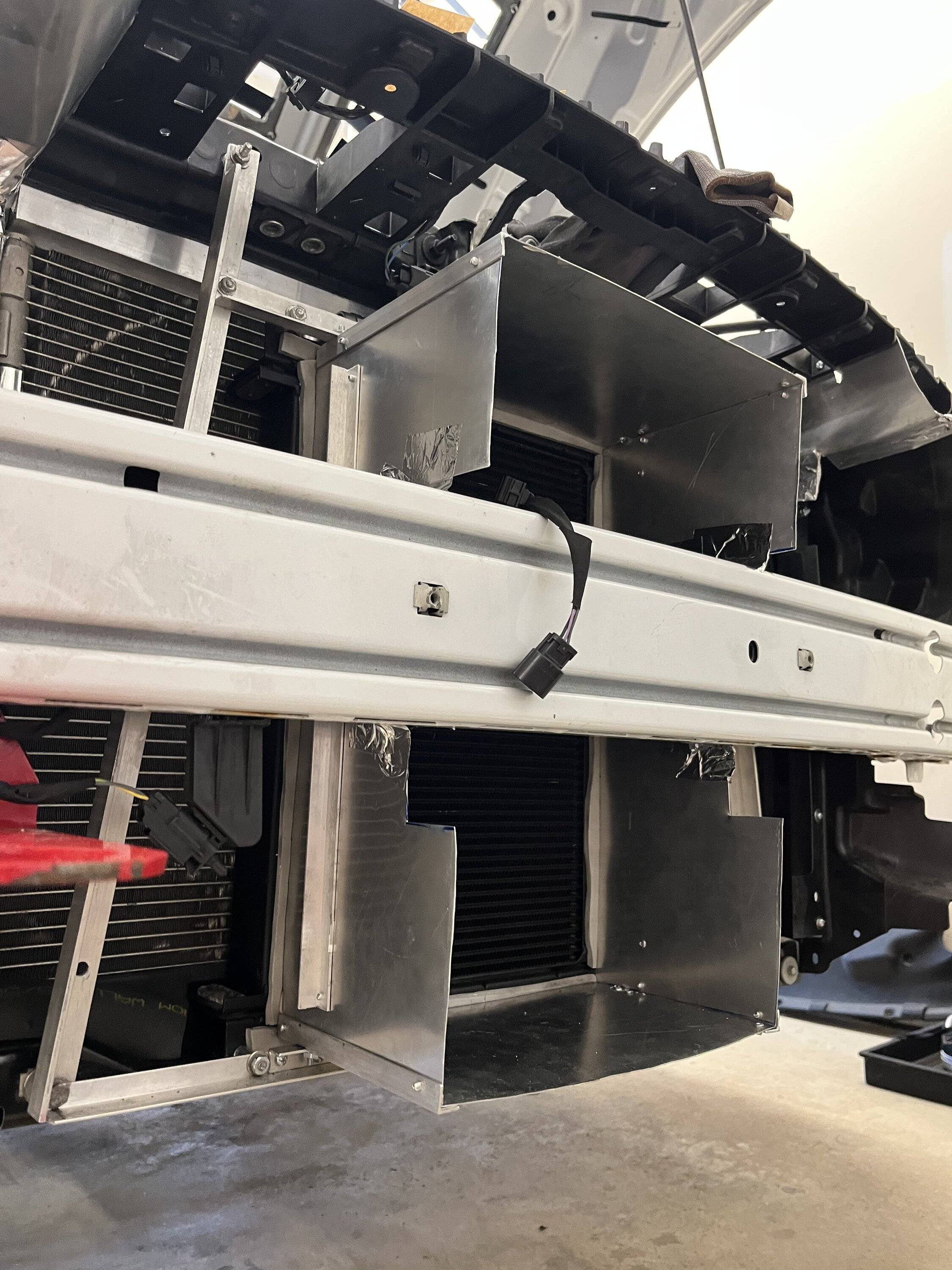

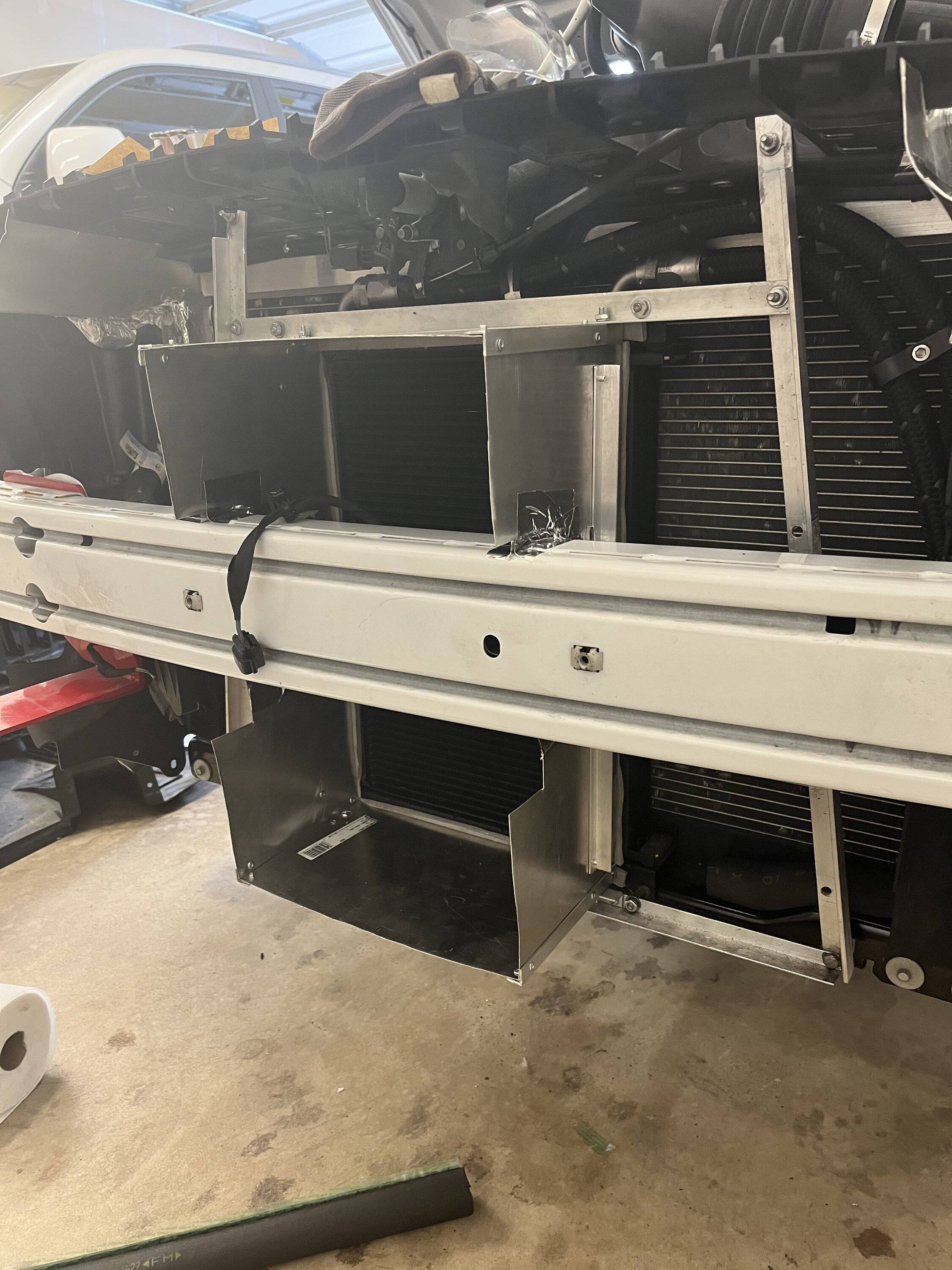

When you mentioned this "sealing" thing and it sent me off to investigate the merits. Low and behold I found 30+ deg reduction in CHT and drove the creation of the chart on post 278. So thank-you for your contribution 👍.
The guys chiming in here also helped to define the chart on post 362, the benefit of removing the stock factory oil-water cooler. It's hard to isolate those mods on the track (unless its the only mod and data is scaled for conditions), but not so difficult to do analytically.
But yes, there is some unfortunate chatter along the way. However, I'm looking forward to supporting the following summary with the final piece of track data next month. The last piece is when I run with the larger grill. Preview below:
Best Cooling Mods to Make to address high CHT from an effectiveness, cost, and weight standpoint (2020 GT PP1 A10 experience):
#1. Sealing
#2. Open Grill
#3. Hood Vent
#4. Fan shroud mod (only if don't have a lot of stop and go traffic miles)
If #1 - #4, aren't enough. Then suggest...
#5. Replace factory water-oil cooler w/ air to oil cooler away from the radiator.
#6. Larger radiator (more surface area than PP1)
#7. If A10, then move the factory trans cooler away from the radiator (this is #7 assuming the trans temps are okay, if not, then this should be done in parallel with addressing CHT)
Just my two cents ... based on my track data/experience and analysis. Cheers.

After some advice from the Forum, inspections of the OEM cooling system, analysis, mods, and track time, I now have the cause and solution ... which is outline in the simplest possible form in post #278. As they say, a picture is worth a thousand words.
Took 8 months to have enough data, mod time, and analysis to be able to make that chart ... and a lot of interesting discussion and additional data from other members along the way in this thread.
So whoever is reading this now and wants the bottom line (cause & solution for post 1), go to post #278. On long threads, I usually start at the end and back up.
Very good details and analysis over time! Thx all who contributed. Unless I missed it, how and what material did you use to seal the radiator surround areas with? I will tackle this first as we're getting into hot summers here for tracking. My last event last month at Big Willow, towards the late afternoon I get fuel cutoff or felt like it after 3 laps, didn't check CHT, could be because low fuel (~1/4). I was monitoring more on diff temps, which was still OK at about 255 (exhaust wrap only).

Oh boy 🙂 ... it's never ending. I'm with ya. My only advice is to just picture yourself as an air molecule and you will want to seal the entire cavity between the grill holes and the back surface/plane ... seal up every hole/opening/slit. etc ... all around the perimeter of the radiator/condenser on the ... sides/top/bottom. Plus the engine inlet area and the opposite side too. And part of that is to cap the frame ends. And then turn around and look at the backside of the front clip/grill ... and do the same. It's painful but worth it. Good luck 👍.
@trackd ... see post #96. That will get you started on the sealing project. It's not an elegant or super robust approach, but it's easy and effective. If you do step (A), that will get you 50%. Easy stuff. 1 day job. To get the remaining 50%, you will have to remove the front clip/grill/bumper assembly. I thought the front was 35-40% of the leak back then, but now I know it's more like 50%.
The only thing I would caution you on is if you are going to go for the ~100% sealing effort, do the front clip (part B) 1st. Cus if you do part A 1st, you will have to remove some of it in order to remove the front clip. Not the end of the world, just adds ~2 hrs of redundant work. Have fun and good luck.
