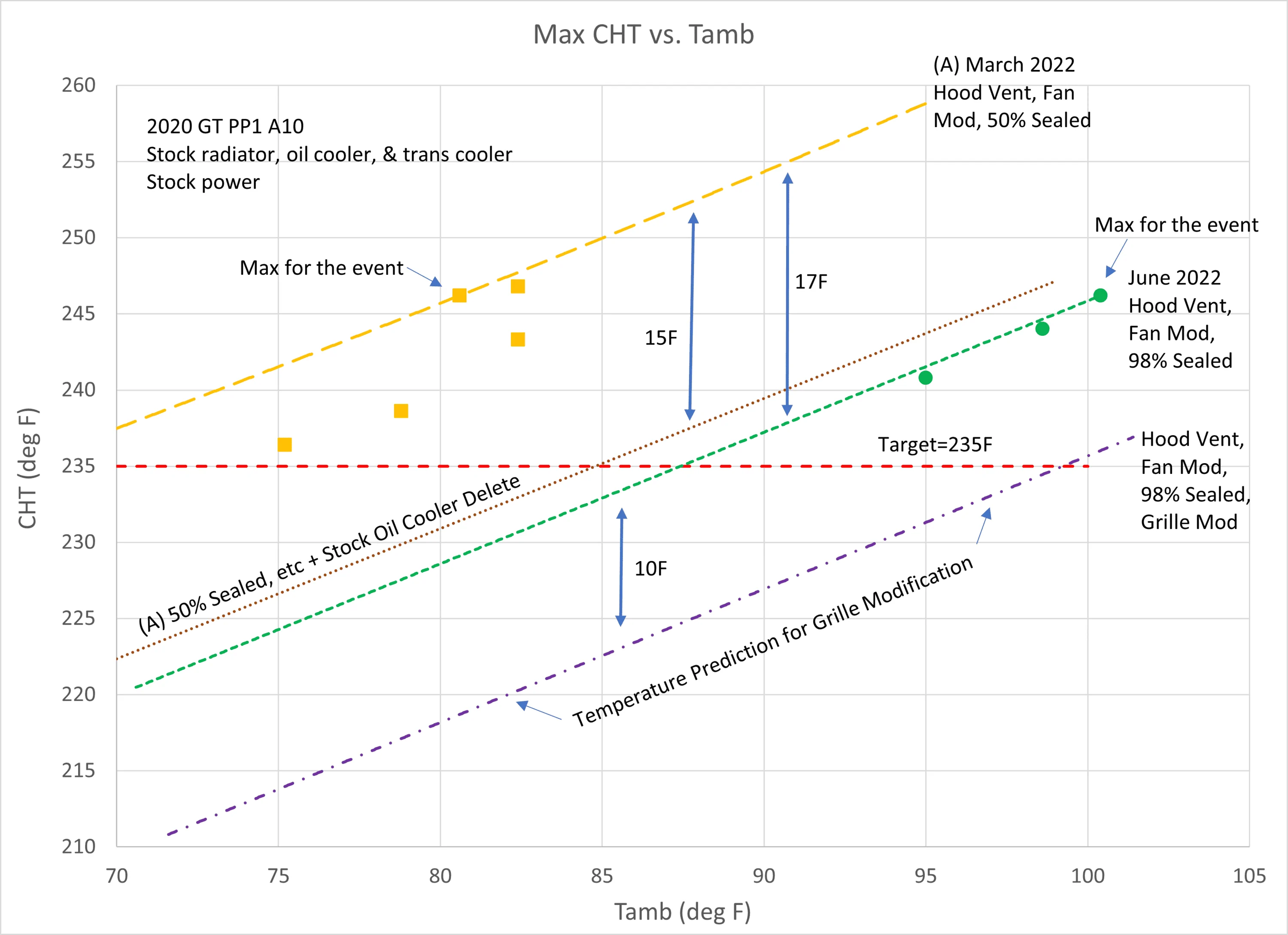

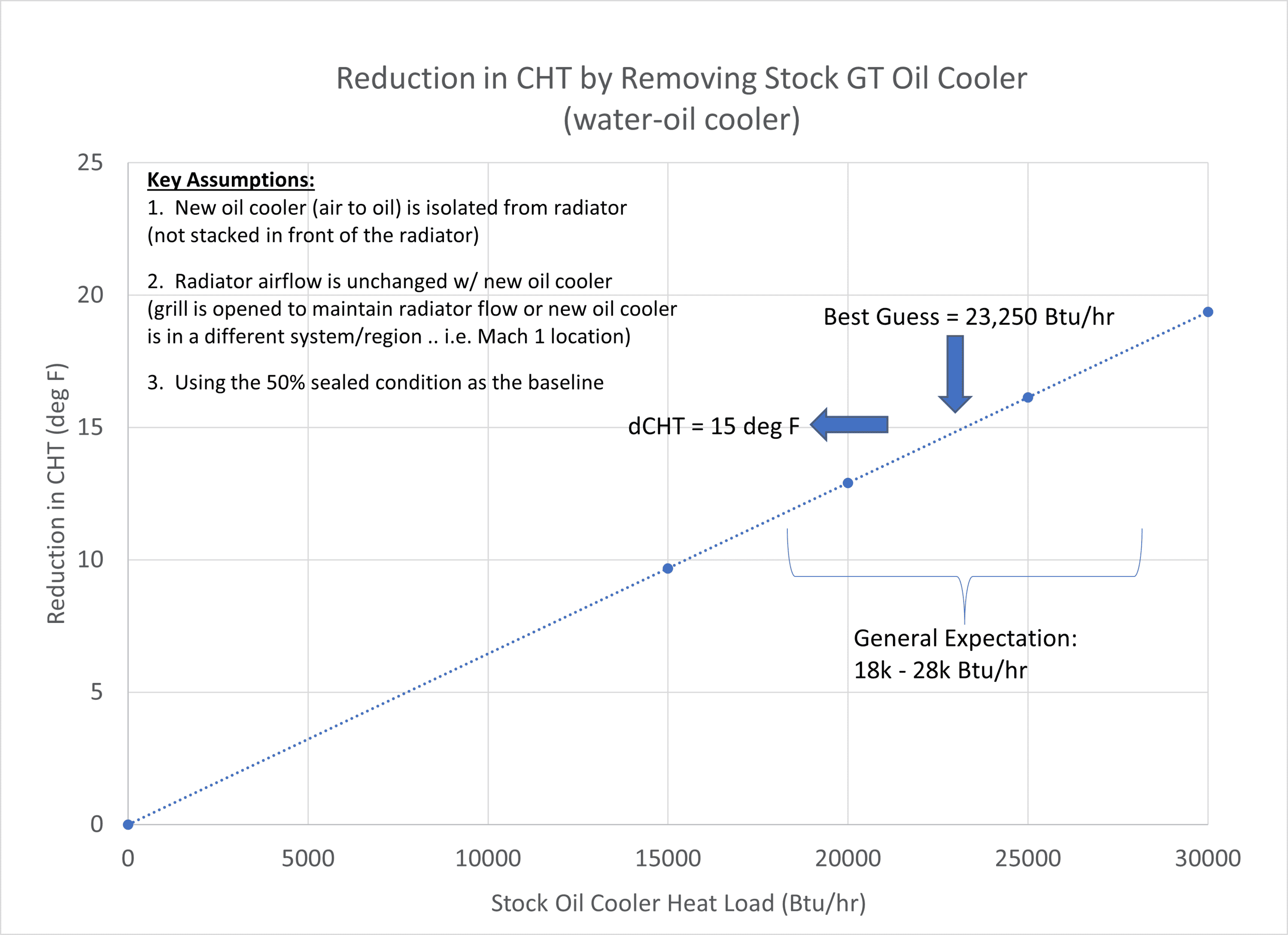

@GTP, as promised ... I ran the calc's on the benefit of removing the stock GT water to oil cooler. Glad you pushed me to do it. It's an interesting study. See attached.
First, the stock oil cooler is a lot smaller than I thought. I took external dimensions off of mine and it's tiny. So my 30k-60k btu/hr guess from previous post was way off. No way it can shed that much heat. I think it's in the 15-30k btu/hr range. Best guess at this point is 23k btu/hr which provides a 15F reduction in CHT w/ the assumptions specified. Overall, I think this is pretty solid benefit.
Next up, is the "summary" chart. I dropped the oil cooler delete in the previous chart I posted to see how it compares. Basically 50% sealed + deletion of stock oil cooler gets you roughly equivalent to the Fully Sealed all-stock condition. To say it another way ... 50% reduction in leaks = stock oil cooler delete. ... that's how powerful leakage reduction is w/ a stock grille.
What this also means is that for a fully sealed system, the goal of 235F Max CHT can be reached by either... (1) opening the grille or (2) removing stock oil cooler and adding an air-oil cooler away from the radiator. (1) has an aero hit and (2) has a weight hit. Decisions decisions 🤔
Hope this helps a little w/ your decision making ... and maybe a few others that might be on the fence or struggling in general w/ cooling issues. Cheers.
