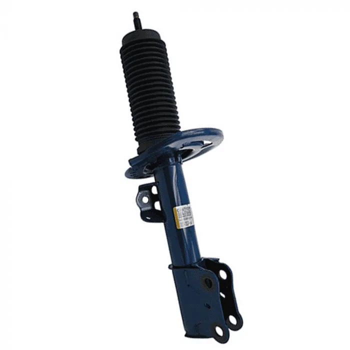

Hi Folks,
I'm on my way to install the trackin handling pack M-FR3A-M8A on my '18 GT.
As everyone, I was wondering how to adjust camber in the front, besides camber bolt (I don't like them), and camber plates (I don't want to disassemble my strut). This isn't for a heavy track use though so I don't need -2.5 camber :)

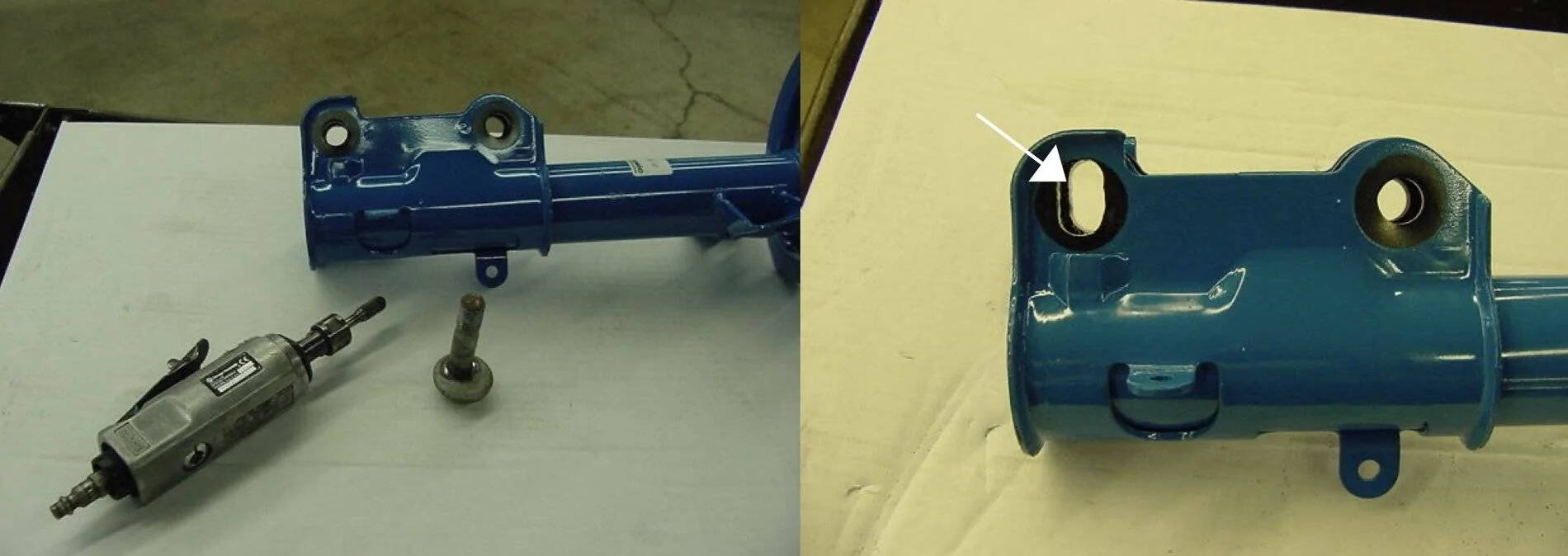

I finally found a response in an official Ford Performance documentation talking about the strut itself (see attached PDF). They say that we can slot the lower mounting hole with some restrictions.
Hope this helps !
Yves.

If you look at both pictures (the one you mentioned is an S197 not S550) the S550 shock does not have the same reinforcement around the lower part of the shock to allow the slotting without weakening it, from my view. The S197 has a folded crease to the bracket
I believe the procedure on the S550 is to slot the top hole anyway.

Yikes... not a lot of meat on the metal once you get close to the edge...
Manual only says to slot 1mm per side so not really that much. But it's a bad idea overall for reasons others mentioned above, sometimes the only one available though.
