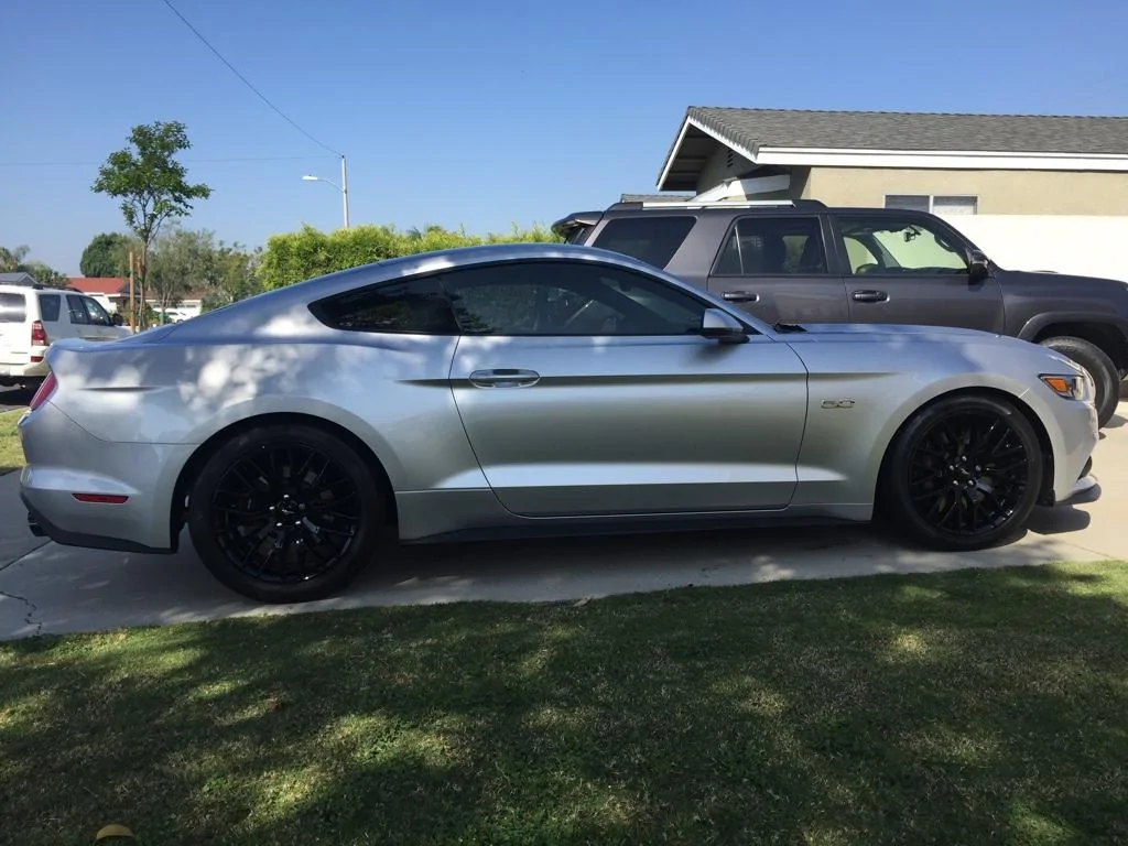

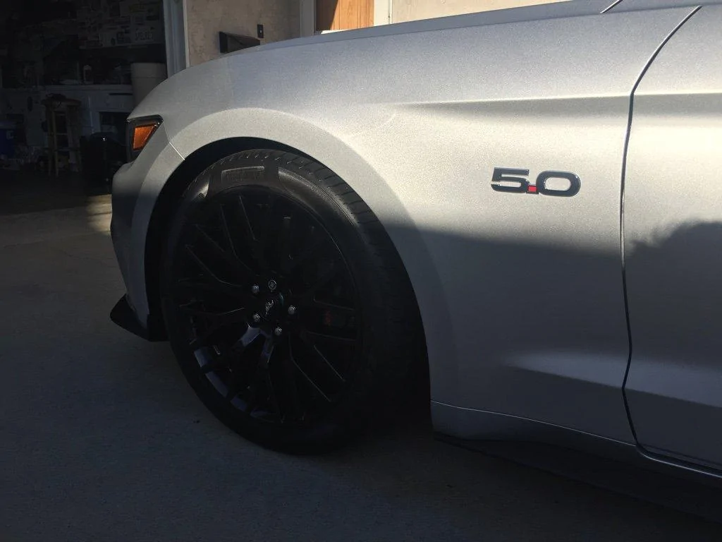

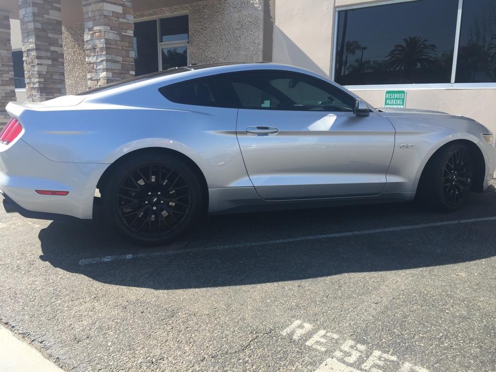

Installed today!
Just driving home I could tell it feels MUCH more connected to the road.
PLUS it looks cool!
