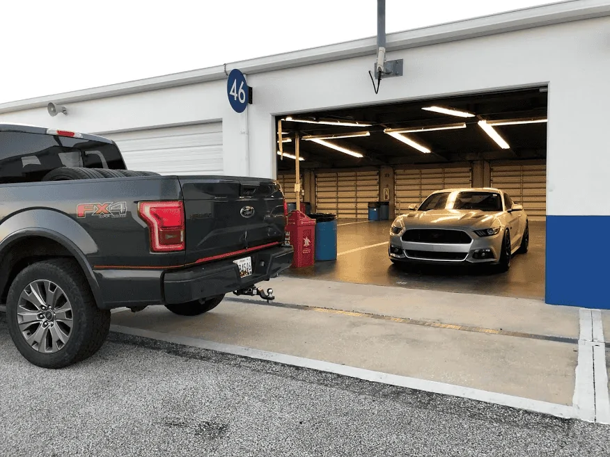

Bring or borrow a torque wrench and air pressure gauge. Would suggest renting a garage. I'm partial to garage 46. The garages are inside the track so you can grid in and out easier, you will have shelter from rain and sun, and there will be other drivers there to answer any questions and borrow tools from. There is fuel and food next to the garages but also just outside the track gates. Add a few extra psi to the right side tires because of the banking. Try to stay on the lower 1/3 of the banking to let faster traffic through up top but stay off the bottom apron. Tapping the bottom apron can throw off ABS and wheel speed sensors.

Awesome picture! For an SCCA track event, how would I go about renting? Just the day of? Like how much is that? Yeah hopefully someone will be there kind enough to let me borrow a torque wrench. Never even used one before to be honest. I have a tire guage and compressor covered though. But in 10 days getting new tires and will make sure they set that properly and then track day next month. Since it sounds like you've done the SCCA event there before(?), how early should I get there if they have the driver briefing at 4:30pm?
