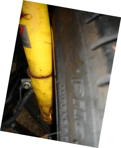

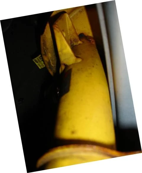

even if you were using camber bolts maxed out you shouldn't hit the strut, IF you used camber bolts in both upper and lower holes though, then it may be an issue, but if you just use camber plates, the tire to strut clearance won't change with camber, it only changes w/ the offset/width of your wheels which in your case would be 1mm less than stock, not an issue at all.
as stated above, the wheels don't affect alignment, so it won't matter what wheels you have on when they align it.
Wheels don't affect alignment per se. But they can limit how much negative camber is physically achievable. Unusually wide wheels with offsets chosen to stuff as much tire as possible into the wheel well without having to make fender mods is the most demanding situation I can think of.
Mostly because I've been there with my S197. Less than 1.5mm tire or wheel to strut clearance, no rubbing even on track. No room whatsoever for further negative camber with anybody's camber bolts.
Norm

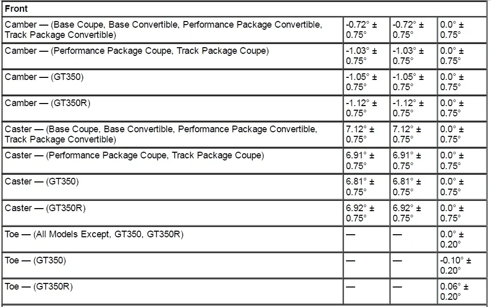

I’ve attached a screenshot of the settings from the owners supplement. The only additional thing I’ll add is, usually more negative camber is better (to an extent.)
If you’ve never tracked the car, I recommend starting off with the factory recommended track settings.
Once you get a feel for the car with those settings, then maybe start adjusting the camber as needed.
With the factory camber plates, maxing out the front camber should net you somewhere in the 2.2-2.6 range (for an R). The rear camber number is ok, but you could stand to add a little more negative camber also. It seems like this car likes -3.0 in the front, and -2.4 in the back. IF…… you can get that. Usually it takes a camber bolt for the front. Also attached is my last alignment for reference.
