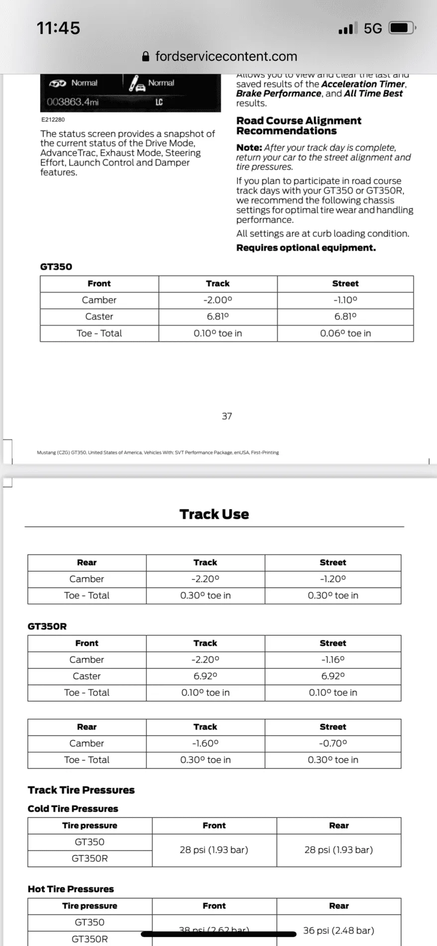

I’ve attached a screenshot of the settings from the owners supplement. The only additional thing I’ll add is, usually more negative camber is better (to an extent.)
If you’ve never tracked the car, I recommend starting off with the factory recommended track settings.
Once you get a feel for the car with those settings, then maybe start adjusting the camber as needed.

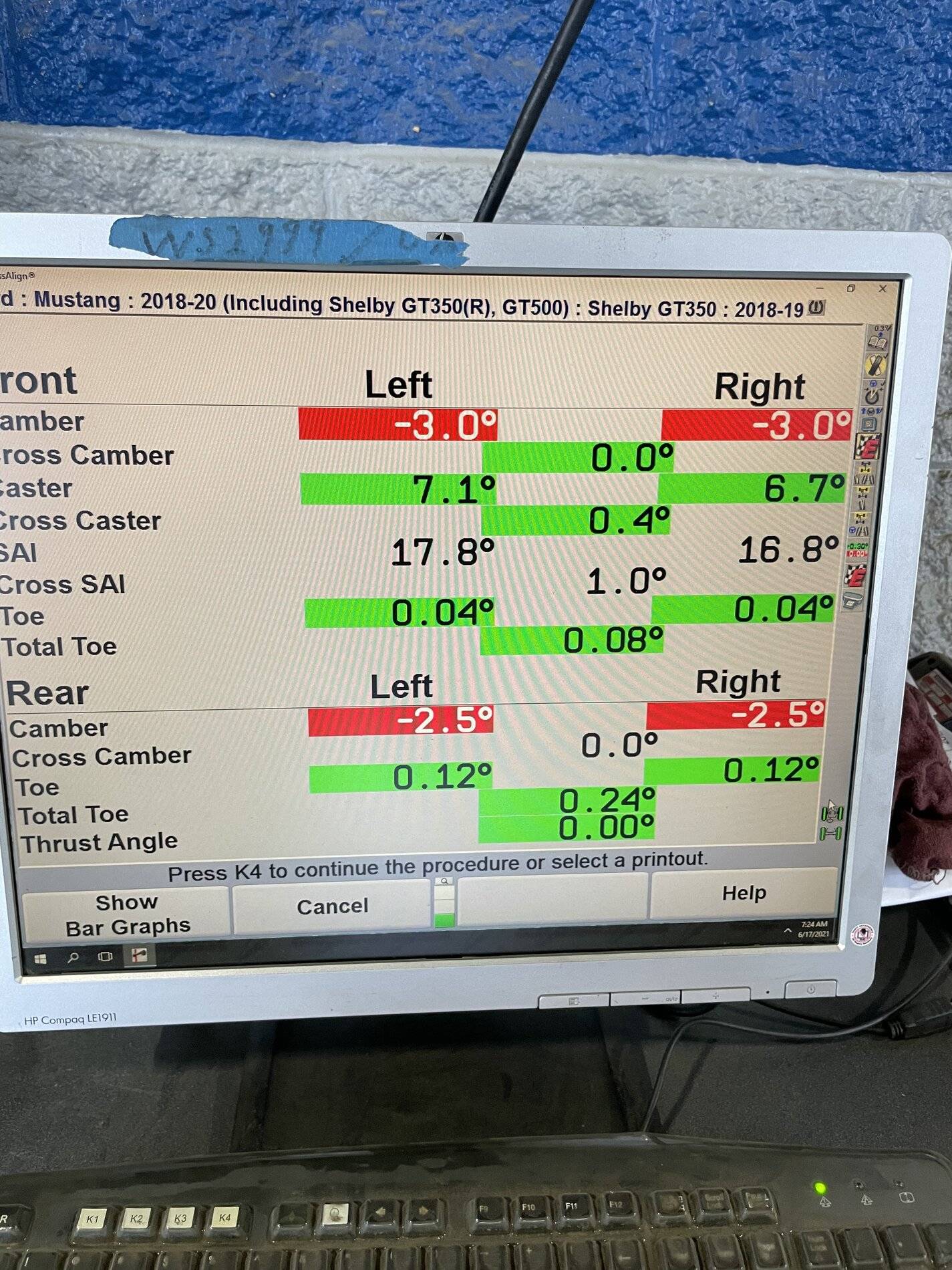

With the factory camber plates, maxing out the front camber should net you somewhere in the 2.2-2.6 range (for an R). The rear camber number is ok, but you could stand to add a little more negative camber also. It seems like this car likes -3.0 in the front, and -2.4 in the back. IF…… you can get that. Usually it takes a camber bolt for the front. Also attached is my last alignment for reference.

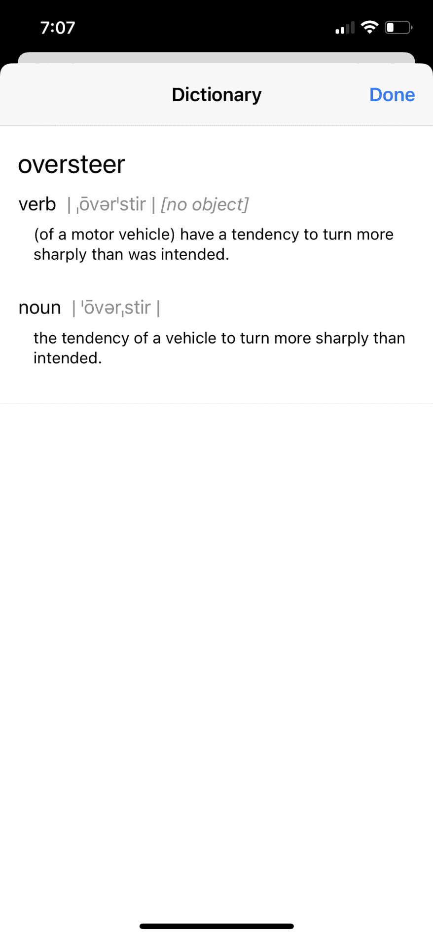

By definition, oversteer is the tendency of a car to turn more sharply than intended.
Pointing ANY of the tires away from the centerline of travel will decrease stability, giving it the tendency to turn more sharply than intended. Pointing the tires in has the opposite effect, making the car more stable.
