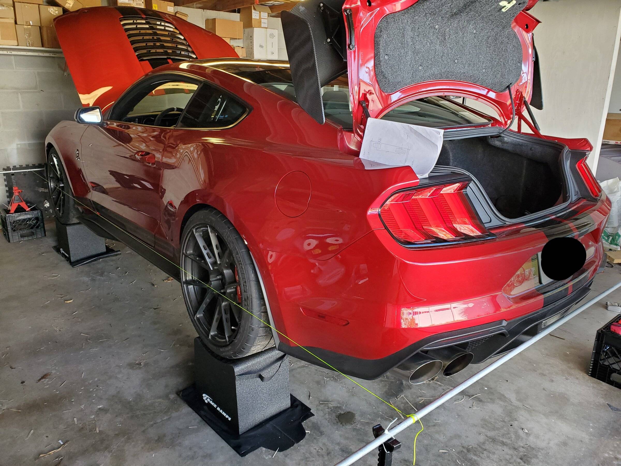

Hey, @Tomster, that's a great shot of your alignment setup - your string arrangement is remarkably similar to mine. One question, though. How do you get the suspension settled back down to static ride height once it's up on the Race Ramp stands?
I have a set of those too, but when I lower the car onto them and the weight comes off the lift, the suspension doesn't relax all the way and the car sits a bit high. What's the trick? I'd love to be able to adjust the suspension, particularly the rear, on the stands but because of the the ride height difference, I don't.

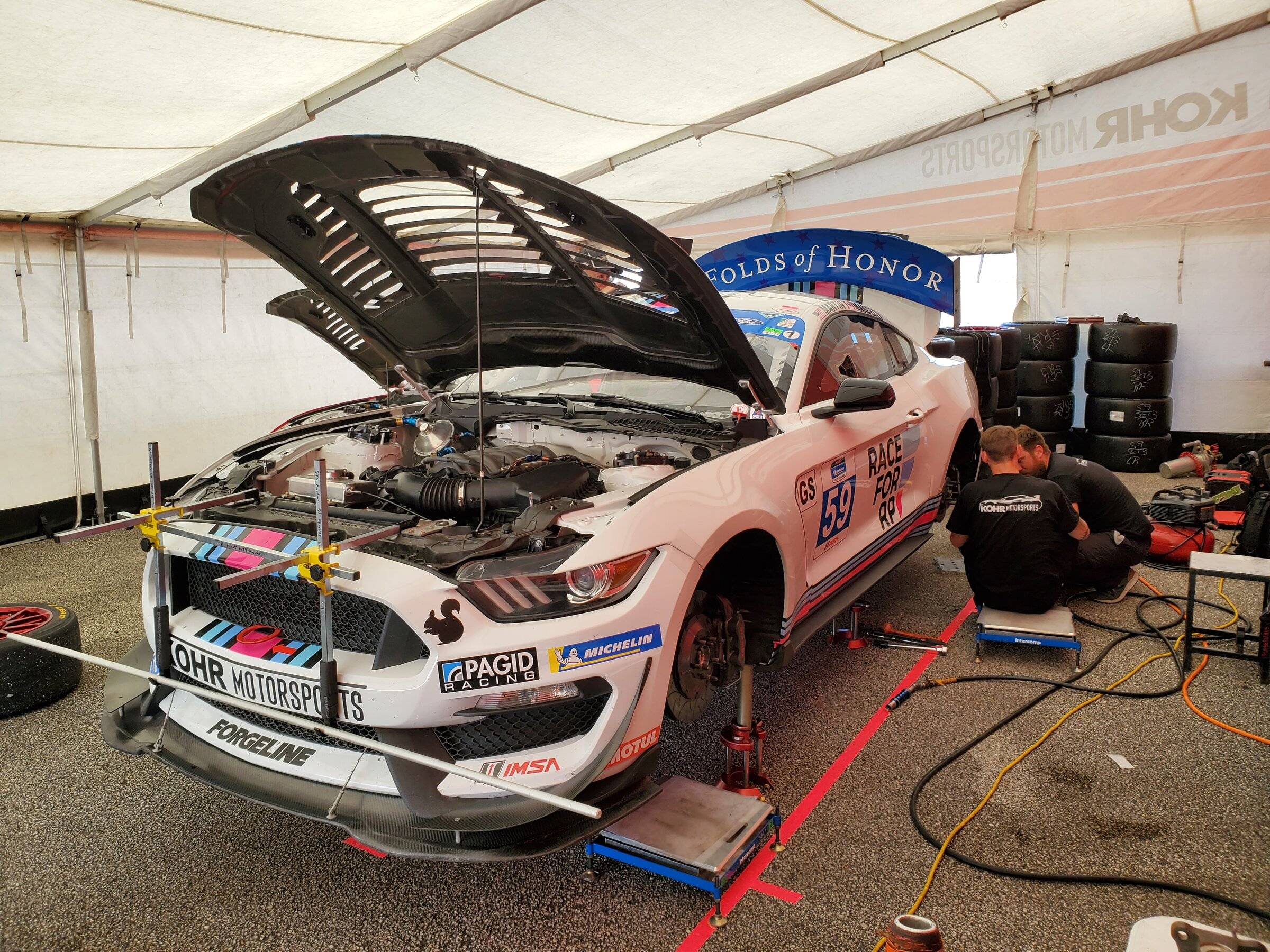

My setup is obviously the poor man's setup. I plan to buy the gear you see on Dean Martins GT4 as pictured.
What I do is jack the car and put heavy duty contractor garbage bags below the wheel cribs so they move with ease during adjustment. That creates a near frictionless surface so that the wheels take the adjustment. Wheel turnstiles are a better option, but this gets the job done until I spring for the expensive gear.
Once the car is up in the air, install the steering wheel lock and then I bounce the front end and rear end extensively so that the car is settled. When it is up in the air like that, you have access to all the adjustments under the car.
Next, I string the car. The 1/2 EMT conduit is marked so that the front and rear strings are exactly the same distance apart. Next, I measure each center hub front and rear and square the strings and then begin to take measurements. There you know what needs to be adjusted. When you think you have it set, I bounce the car again. I recenter/verify the strings and remeasure. I tweak if necessary and then road test. If I have time, I'll string it out again to see how a road test moved anything. Usually, it is fine.
The advantage of the gear you see on the race car is that the points of reference are fixed to the car. You can bounce it all day long as well as Jack and lower it and the strings should maintain reference.
