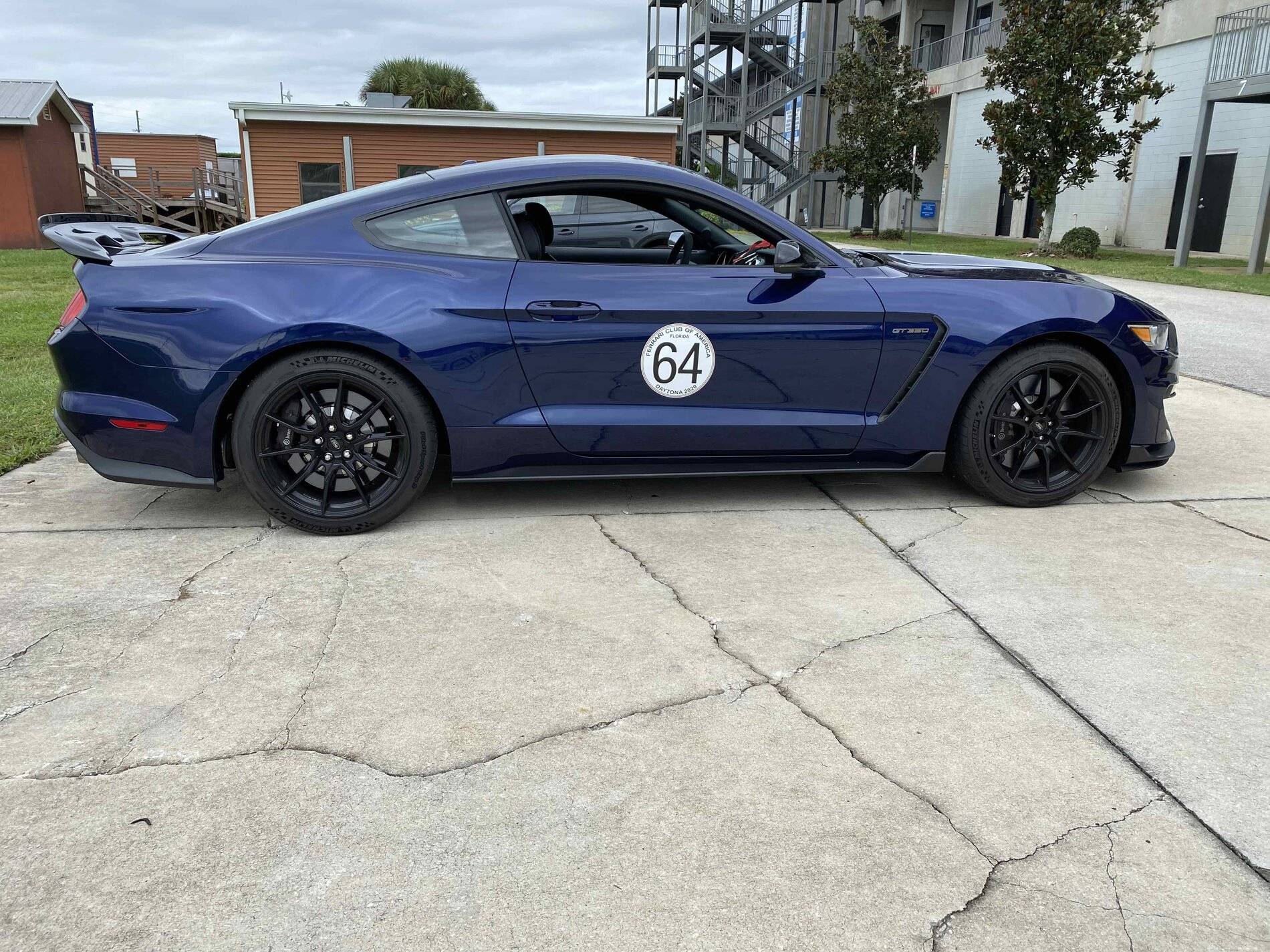

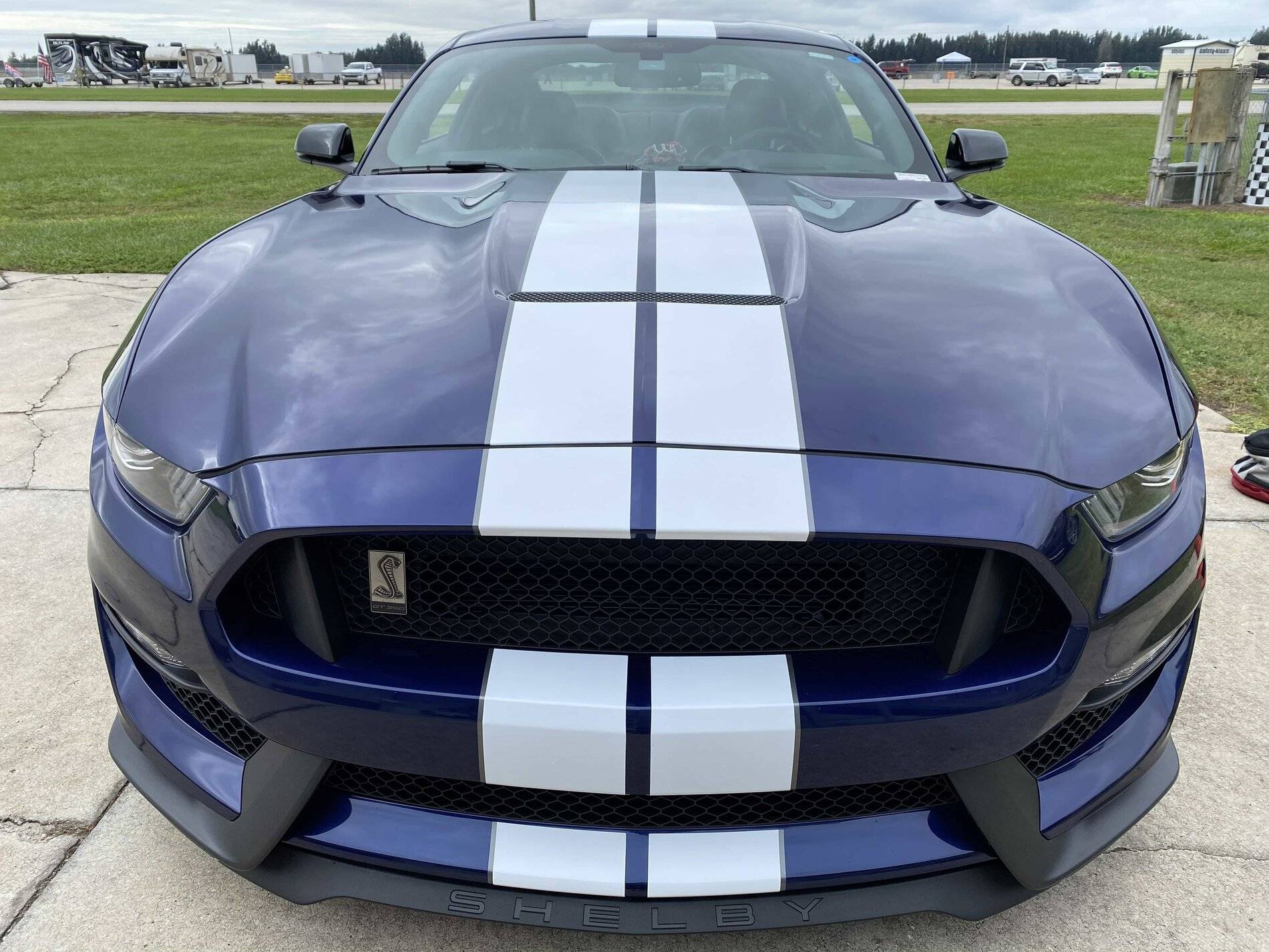

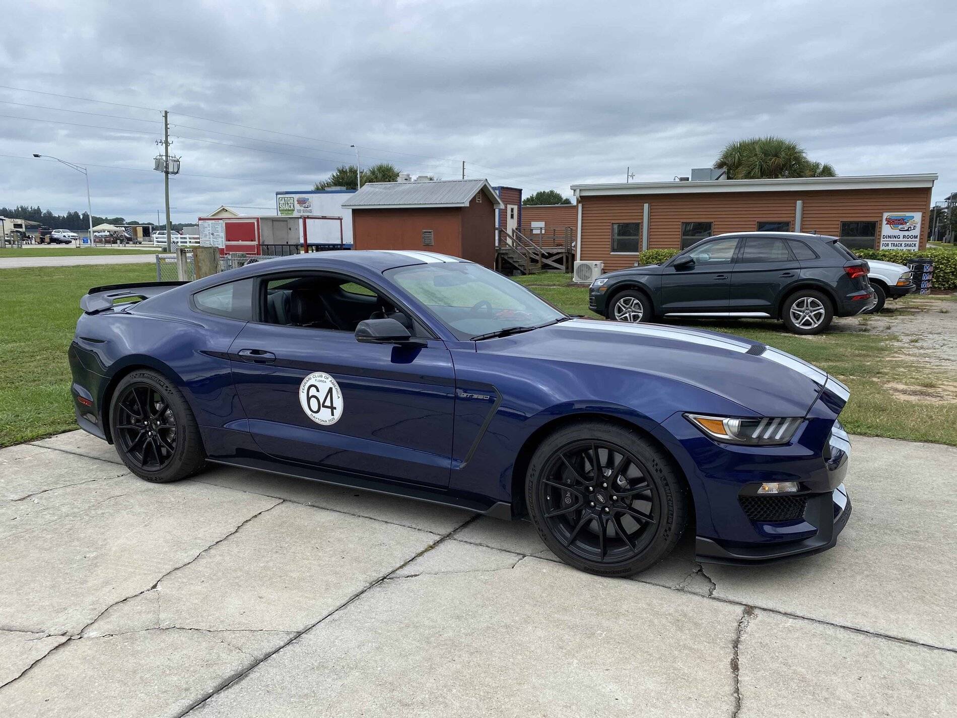

Hello! I have taken my Shelby to Sebring a couple of times and the car is so much fun to drive on the track! I am extremely surprised by its amazing capabilities! I have the handling package and I have not installed the adjustable strut plates yet. I wanted to feel the car on the track as is before I decided what to do, the car was extremely capable without them however I am trying to learn more about the advantages of installing them.
What is the advantage of installing these plates?
What is the process to adjust the suspension to track setting/street setting? do you need an alignment machine regardless of the adjustable struts?
Do I have to take the car to the dealer (or somewhere else) every time I want to go to the track to set up the track alignment and then back to the street alignment?
I am trying to learn more before I install them.
Thank you for sharing your experience!

I did not notice a tow hook? I thought the tracks required one.
David Yanez
Jan 4, 2021
Orlando, FL
David
2019 GT350
True. I have not installed one yet. I have a lot of motivation to stay inside the track 😂
Do you have any suggestions on best solutions? I did not find a tow hook that comes with the car

Tow hook does not come with 350, I have the ZL1 on mine.

oldbmwfan
Oct 19, 2016
789
947
Chicagoland
2017 GT350R
Yes, I look at Vorshlag and they look pro pro pro, I am going to call them today. I appreciate the tip on the tow hook, I really don't want to remove the bumper, do you know of any other options that are easier to work with? Can't wait to go back to the track, the GT350 is amazing as is, I can only imagine how good can it be with the right settings, Sebring has a lot of fast turns and the car provides so much confidence on braking and cornering that you can keep exploring the limits under control.
I installed the ZL1 tow hook without removing the bumper. It requires a bit of reaching, but it's doable. I did have to remove the splitter but that's not so hard.

Oldbmwfan, thnx for that info. My tow hook hasn’t got here yet so now I feel confident i can get it done Without tearing things apart.
