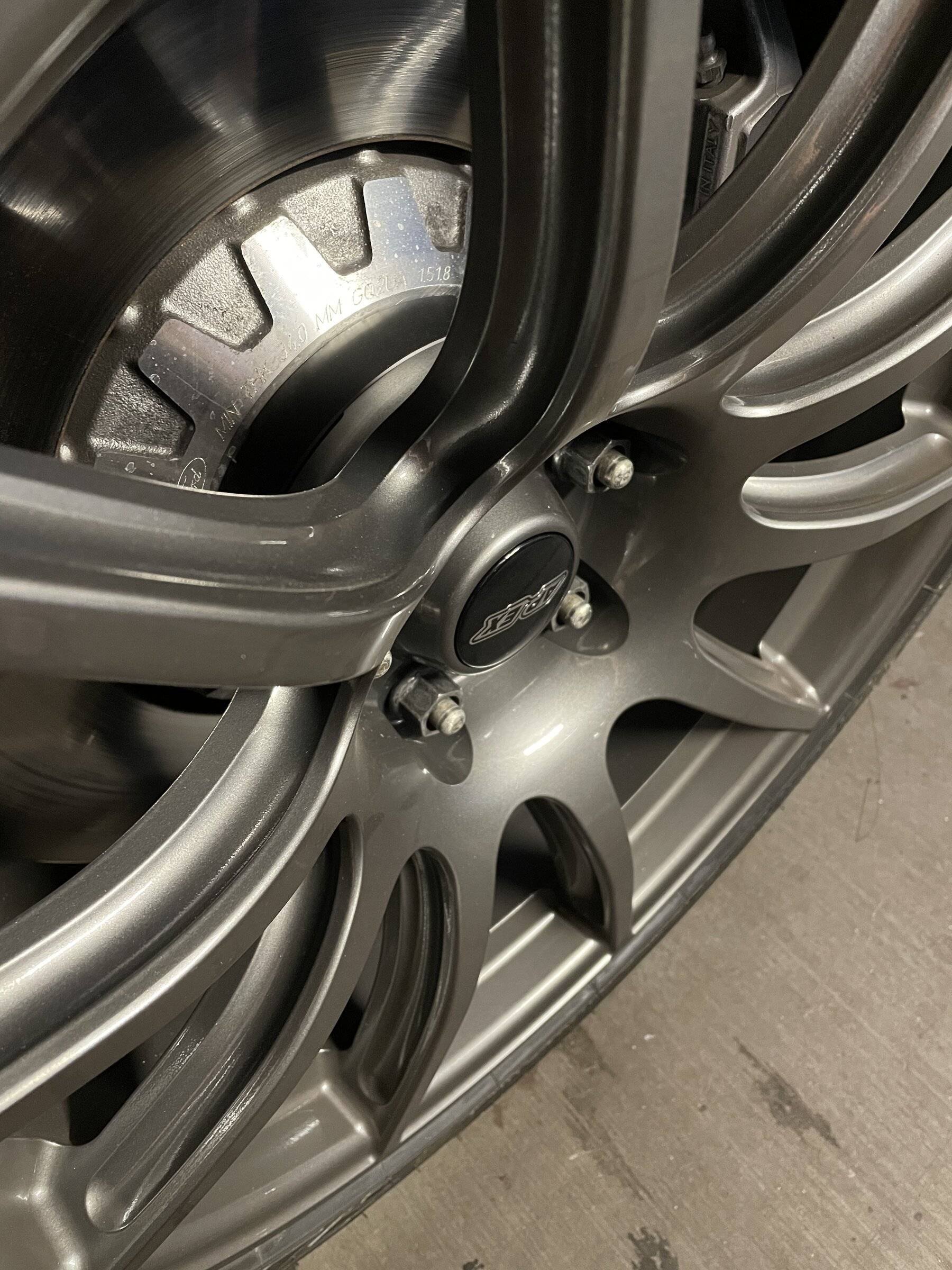

Suggest 31mm spacer with r length studs if going square
Not sure I’d call it poser points. There are definitely other benefits - wider front track, etc. The other thing I’d highlight is that it just gives you more flexibility. Some tires run wide (305 GY 3R is as wide as a 315 Cup2), add more camber without having strut issues, bump up to a wider wheel in the future, etc.
25mm w/ 315 Hoosiers
31mm with 305s and moar camber (which results in better wear and grip)
Besides, the R hubs you bought are perfect for the 31mm spacer from Tim at OP Mustang.
Can you educate me on the R hubs? I've added camber plates, and am at -3 on the front. There is still plenty of clearance with 305 R660's, but want to go 315 square on new rims.
I just need some place to start researching, unless the factory hub is the way to go. And searching this site, I clearly have not found the right key words yet.
Are you running the stock wheels or wheels with stock offsets? If so, I wouldn't worry about it. My comment above was specifically for those running aftermarket wheels that use extended studs and spacers so they can rotate wheels.
This is exactly what I want to do. I've searched the forum, and not really found clear information on this. I am sure it's there, I just haven't found a clean thread on the topic.
I am currently factory rims (10.5's and 11's), 305/30 front and 315/30 rear.
I could probably start a new thread instead of hijacking OP's. Just figured it might be as easy as pointing me in the right direction.
19x11 square 50mm offset, and extended studs up front with 25mm slip on spacers.

also will need open lug nuts if swapping back and forth to oem wheels... i prefer open either way though.
Gotcha! My recommendation would 19x11 or 19x11.5 with 52mm offsets and run 31mm spacers up front. These are the hubs I run with upgraded R length studs. You can also buy just the studs and press them in if you don't want to replace the hubs too (having extra hubs is never a bad thing, tho).
https://www.opmustang.com/store/p31..._Hub_Assemblies_With_Racing_Wheel_Stud.html#/
This is the spacer I run
https://www.opmustang.com/store/p302/31MM_Hub_Centric_-_Wheel_Centric_-_Wheel_Spacer_-_Pair.html#/
Same here - 52mm offset Apex 19x11 wheels square with Apex 25mm spacers. Using ARP extended studs as well.
