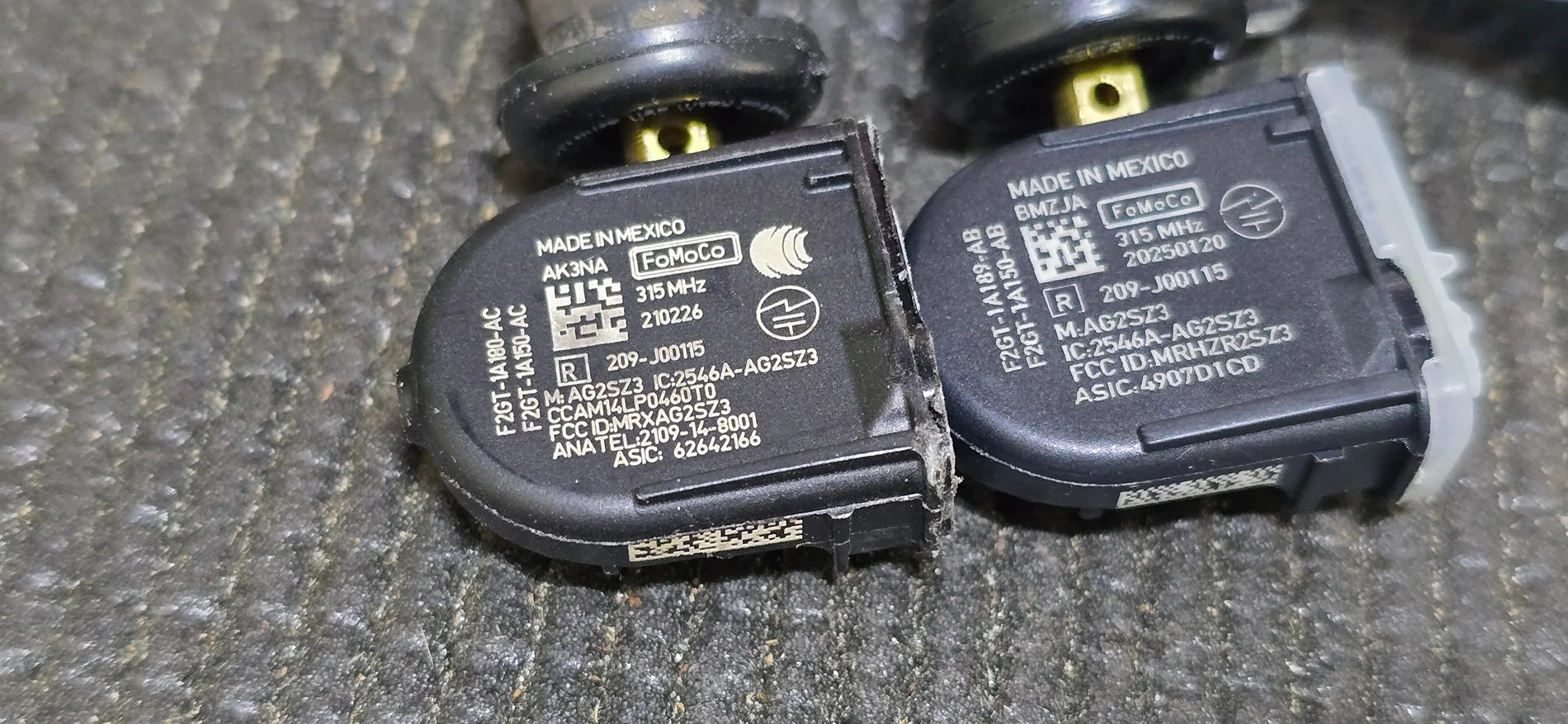

They are not the same part number. They dont make the f2gt-1a180-ac any more. Based on my vin, the 189-ab is the replacement.

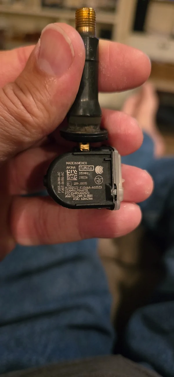

Swap the PCB from the old one that works into the plastic of the new one. Glue the white cap back on with CA.

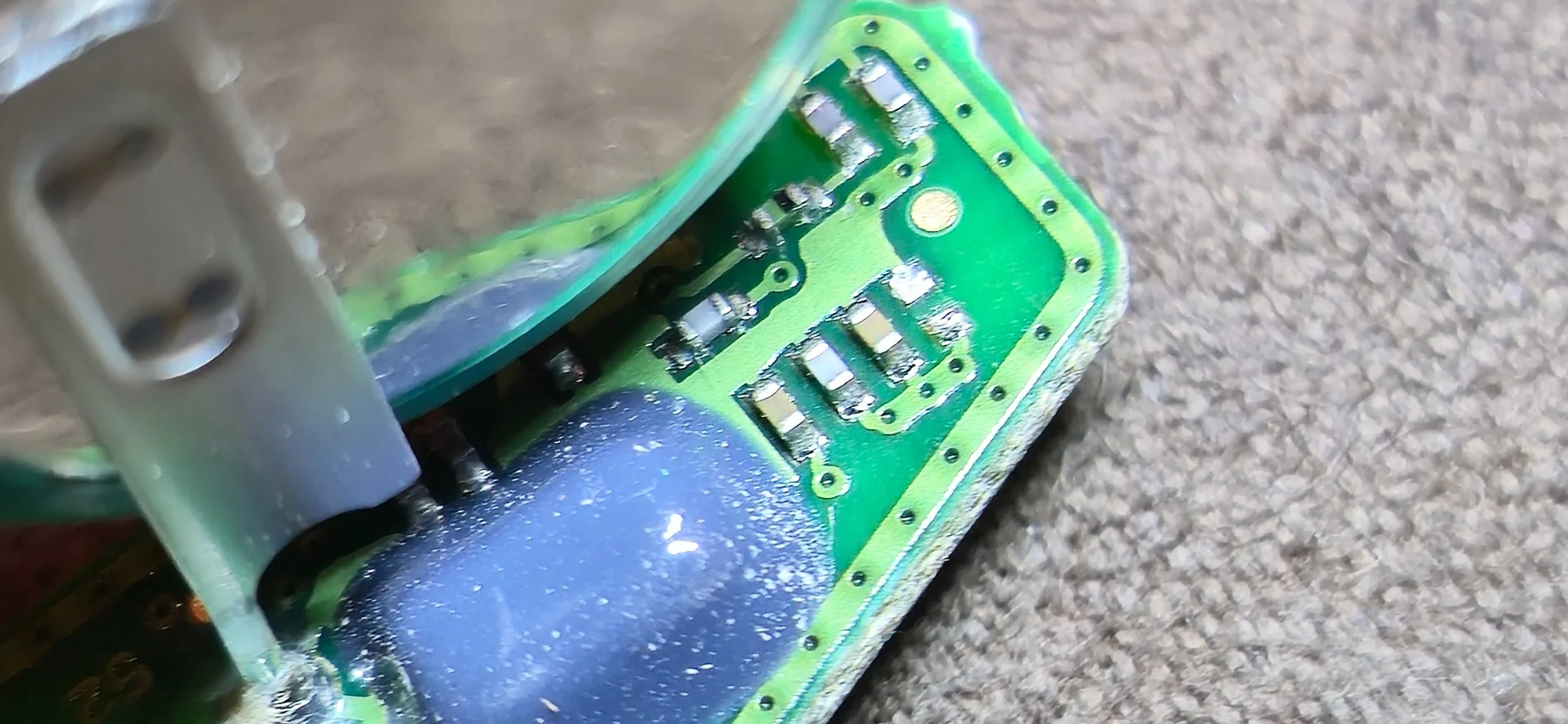

I can't because the old one is broken. I believe there is a resistor missing on the board that's causing it not to work.

Is that a new part? Because that looks tampered with. Perhaps try exchanging it? Or move the missing part from the old one to the "new" one if soldering is part of your skill set.?
Or maybe consider calling all of the dealers around you and widening the circle until you find one with "new old stock" of your original part number.

The working PCB is missing an electronic part, got it. The same part from the new sensor could be removed and installed on the PCB with the missing part. On the other hand is the second PCB in the picture as bent as it looks?
That might account for the change in behavior?

It is recommended that you replace all the sensors at the same time. The battery inside is only good for ten years. If you have two different part numbers, you may be confusing the RFD. I would just replace the other three so that all of them are the same part numbers.
