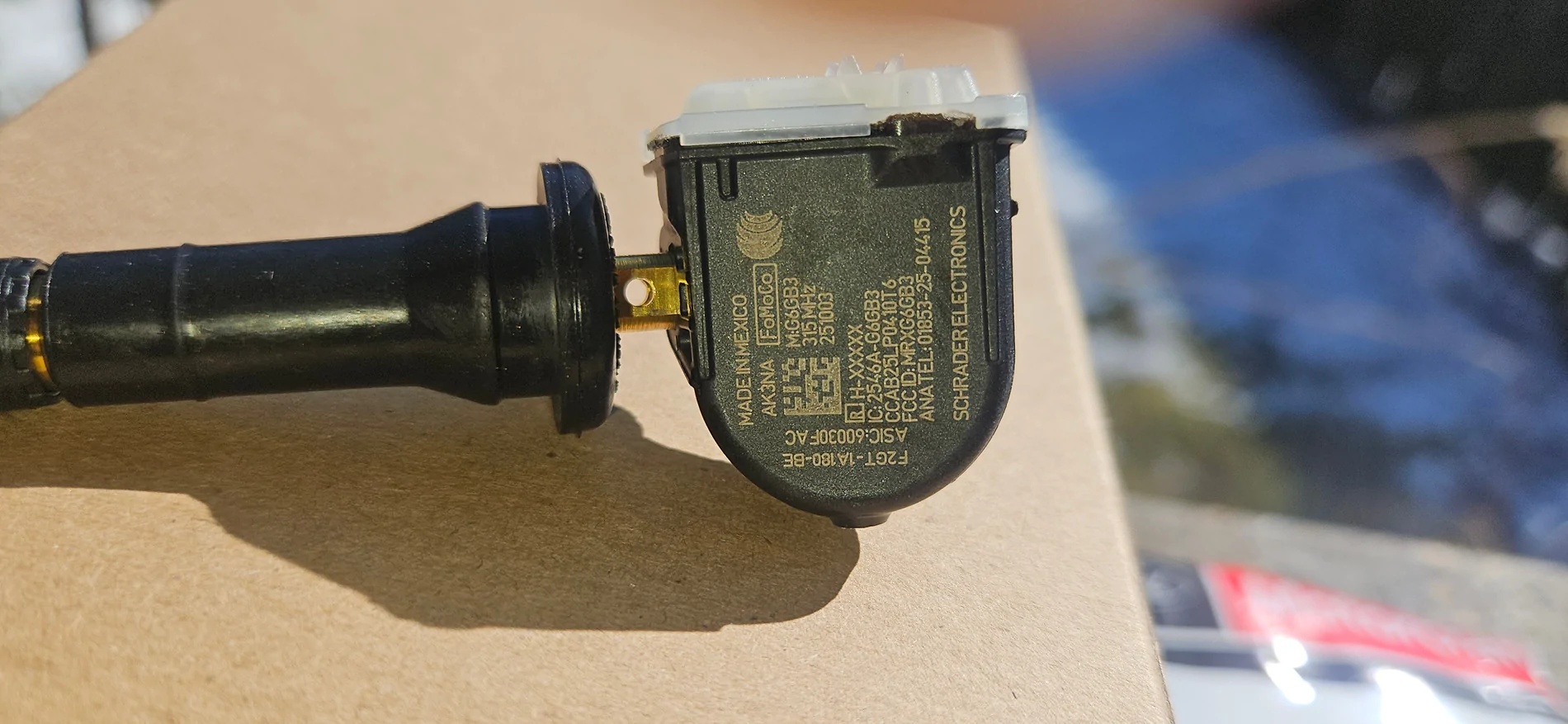

I was going to order the kit from CJ Performance or others that showed them cheaper, but not sure if they're selling counterfit sensors in a box with FORD on it. So I bought directly from ford.com. If yours don't show the 180 part number on the sensor and say schrader on them, they're probably the wrong ones.

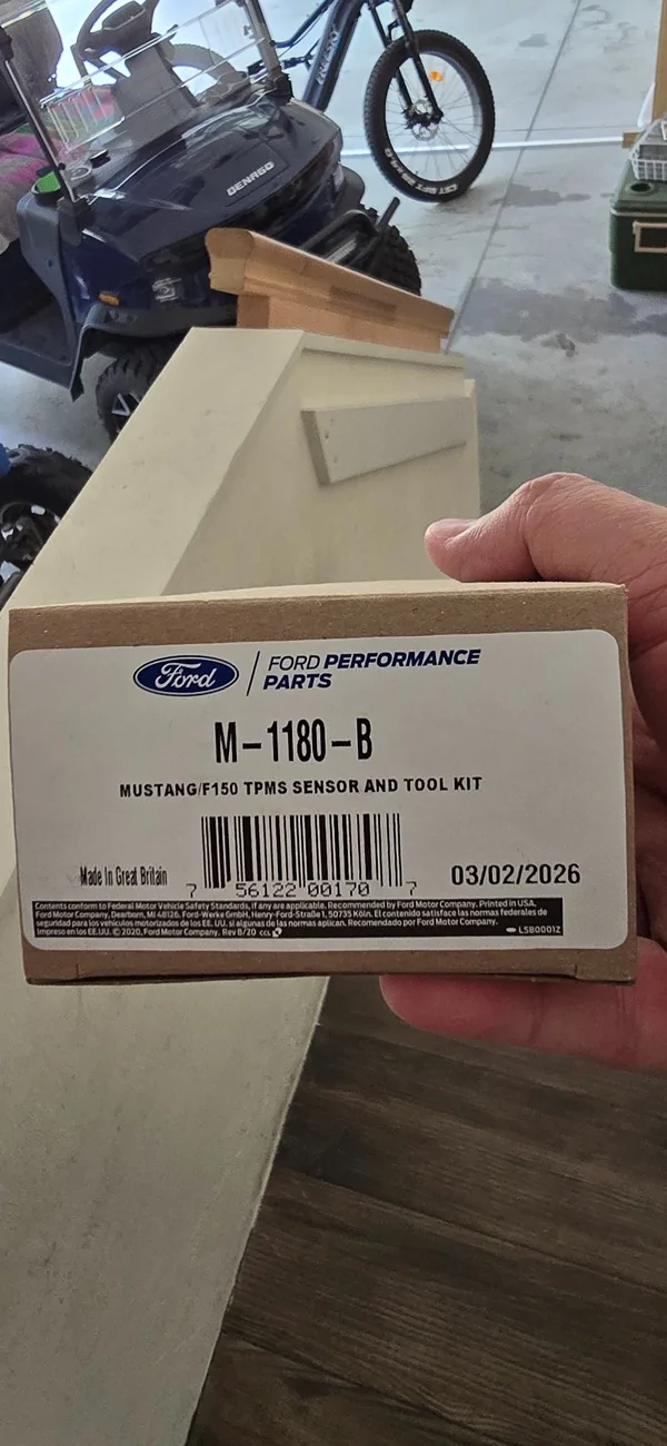

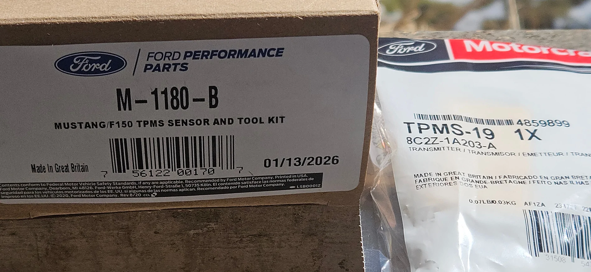

Pretty sure these are the real deal from CJ I received yesterday.

That looks like them!
Same box
