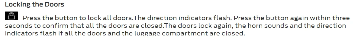

Double honk when you close the door when the car is running. Not sure if the Euro cars do that, but every US Ford does and it's damn infuriating.
Yeah ours do that too - to be honest I don't mind that, but its not a feature that alerts me often. I think its only done it on me twice, leaving a car running and not being sat in it isn't a smart choice in the UK ... lol
Do the American Mustangs horn honk on a double lock ? I know that the hire cars I have had in the states have done it and over the years it become common for the kids to associate it with American holidays / cars. They were disappointed when the mustang didn't do it so I'm actually looking to turn that feature on ... lol
Interestingly the UK owners manual says the UK cars do it - but mine doesn't ?

Yes, if you double hit the lock button the horn honks on the US cars. Not sure why you guys don't get that. Sounds like a rip off lol.
