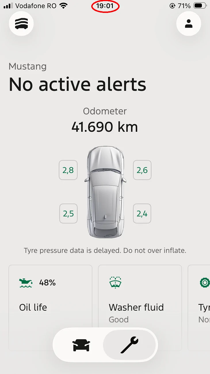

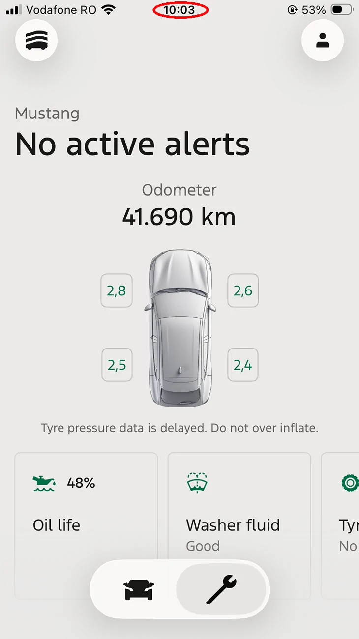

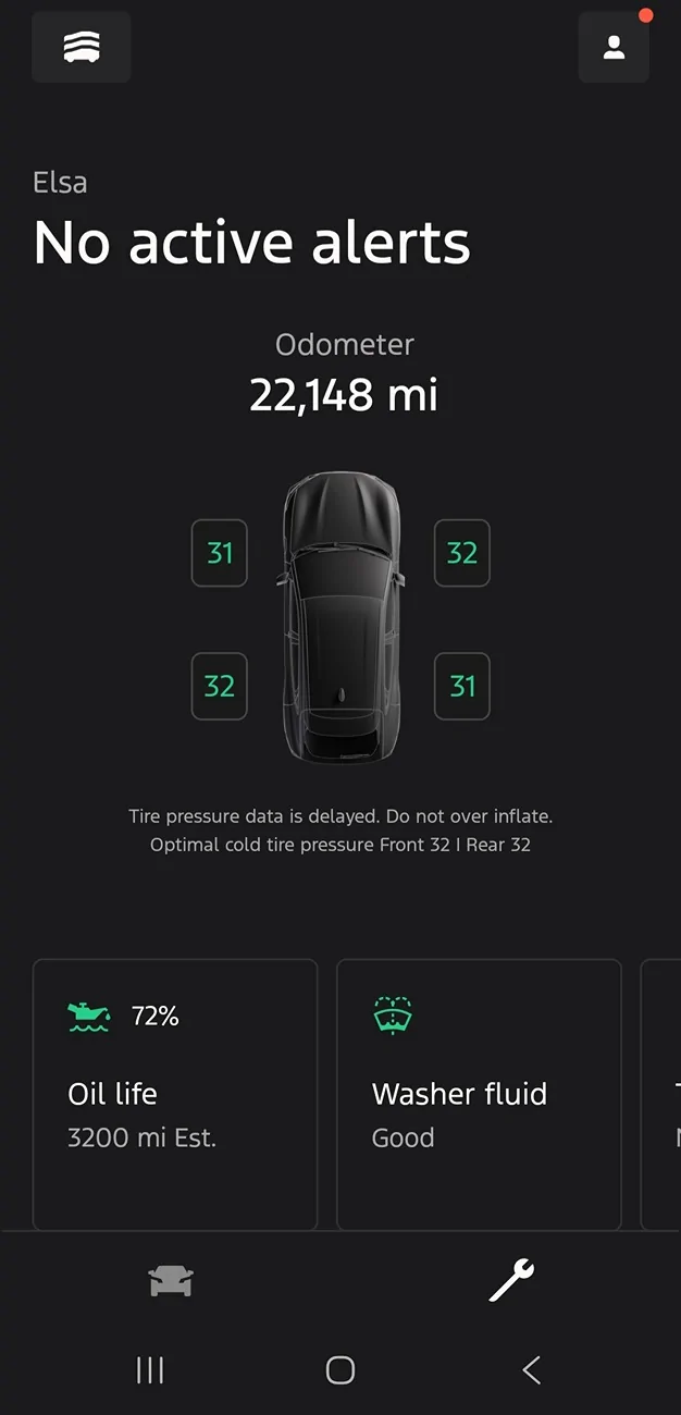

Can anyone verify that their fordpass app shows tire psi changes overnight?
I checked at 7 PM yesterday, and then at 10 AM this morning. It looks identical. The pressure doesn't seem to have updated over night. Unless, of course, it just happened not to vary at all in any wheel, but I find that extremely unlikely.
2020 GT, still on factory sensors.

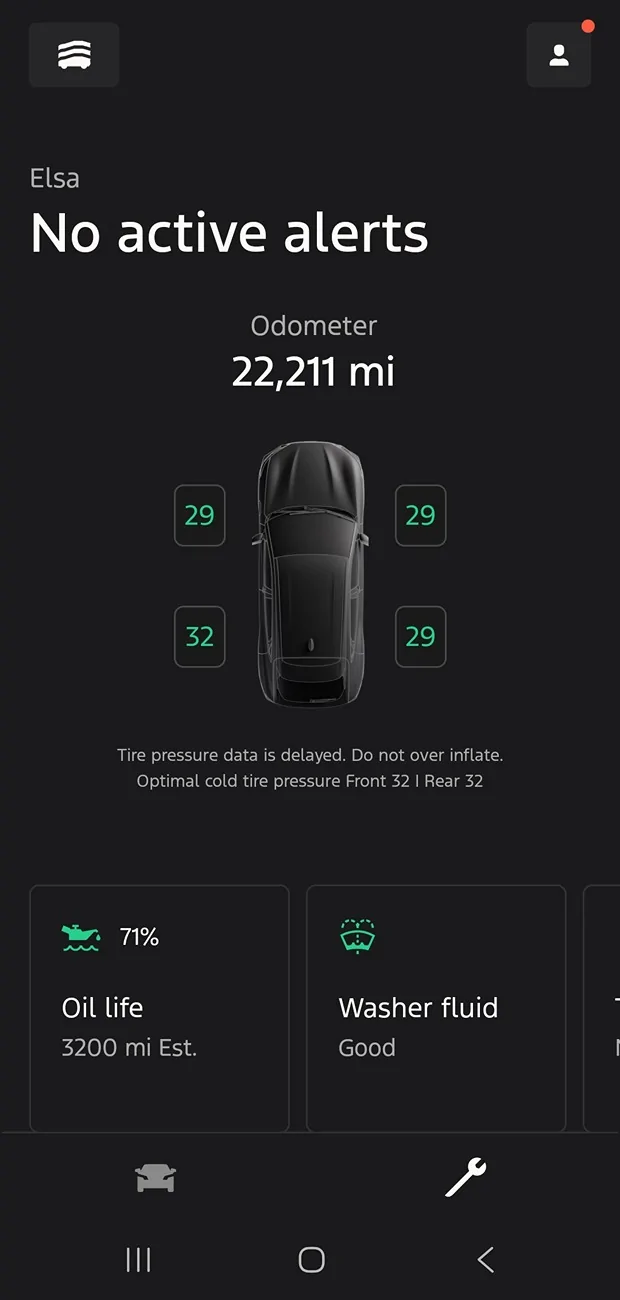

The original ones seem to update a few times overnight. The new one (left rear) doesn't update at all after being parked.
This was yesterday when I parked and this morning when I woke up.

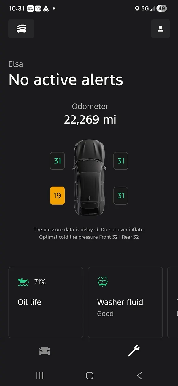

Ok after more testing I have some results to discuss.
I left the car sitting since yesterday at 530pm. No updates showing for the left rear (new) tpms sensor.
When I got home today (car still untouched since yesterday) I went to the left rear tire and let 10 psi out of it.
While I was almost to the -10psi amount, I heard the car make some clicks and electric cycling noises, the ford pass automatically updated and showed 19psi in orange.
I guess that's good enough for me. As long as it knows/alerts when a tire is low, im happy.
I can continue on replacing the other tpms sensors now with new ones.
Also, I set the tires at 29.4psi cold. The new sensor reads 30psi and the old ones read 31psi. So the new one is more accurate at least.

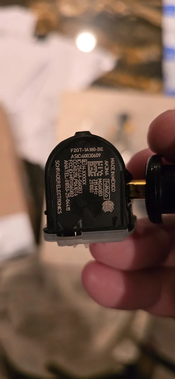

Well, I couldn't accept the issues with the aftermarket TPMS sensors not updating tire psi in the Ford app. I've tried the aftermarket ones on amazon, I bought counterfit Ford ones on ebay that come in the ford packaging, etc. None of them would update with the correct tire psi when I refresh the app. They would only update once driven; sometimes up to 2 miles before they even update on the car's dashboard display! My local dealerships want $100.00 a PIECE for them!!! That makes me so angry that they do that to customers.
I finally found the correct ones that work properly!!!
The kit was bought directly from ford.com. The part number is M-1180-B and goes for about 140 bucks for 4 sensors and a pair/learn tool. The new sensors have the -180- part number on them just like the originals that came out of my tires and say SCHRADER ELECTRONICS on them.
The sensors work perfectly. The app shows them change from 30psi to 29psi to 28psi over-night when the winter temps drop the tire psi. The psi is correct on the dash/display as soon as I start my car.
I almost sent them back because I couldn't get them to pair with my car while holding them in my hand and using the tool. I had to put them in and air up the tire before they turned on. They wouldn't pair without having psi first. Guess its a way for the sensor to save battery when in storage.
Oh, and another thing! There are 2 different methods to putting my car in TPMS train mode. The first method worked on most of the aftermarket TPMS sensors but would NOT work with these Ford sensors. (turn ignition on, cycle hazard lights 3 times, horn honks once and says train left front tire, etc).
The 2nd method is press the brake, turn the ignition on, off, on, off, on....press the brake....off, on, off, on, off, on...horn honks, train left front tire, etc. This method worked for the new ford sensors.
Now I have properly working TPMS sensors again!
Hope this helps someone going through the same BS.
