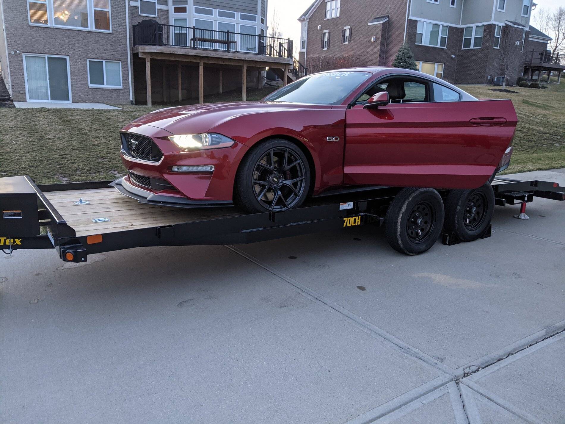

Another option is to elevate the car on the deck like Inthehighdesert mentioned above - but it comes with issues (drilling into a steel deck, raising CG of
Ohhhh, so the removeable fenders isnt so much for gaining width as it is for gaining height clearance for swinging the door open. Correct?
Absolutely - they don't gain you any width since they sit on the outside of the deck anyway. I've measured height from the ground to the bottom of the door and asked for fender height from the deck when shopping for trailers - none of them had fender low enough.
See the pic - door would not clear fender when it's on.
tamadrummer1120
Aug 18, 2016
89
MD
2017 Lightning Blue GT
Okay good, so im just that stupid I was looking at gaining width lmao. Well my buddy who welds is taking my trailer to weld on some other stuff so he will making the fender removeable.
