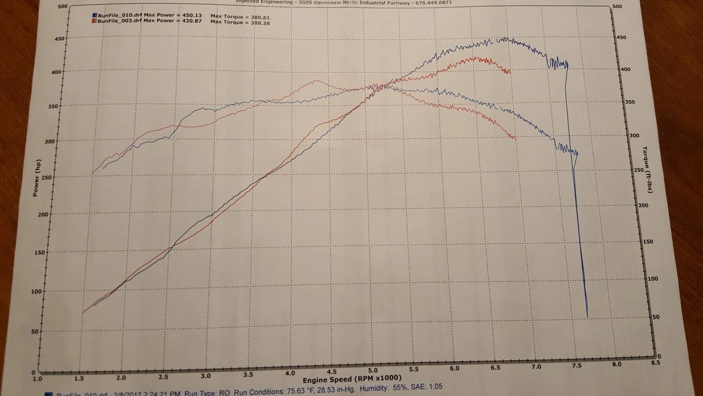

Here is the graph. The red line is on e85 (flexfuel), Steeda CAI and catback and 26 degrees of total timing. Blue is the Sniper, BBK 90mm TB, Stainless Power catless headers and 28 degrees of total timing. These are SAE numbers.

Hmm I wonder how much difference the sniper and BBK 90 honestly made. Catless long tubes plus 2* extra timing should be at least 25whp if not 30whp and similar torque by themselves. Peak power moved about 500 RPMs but seems to fall rapidly.
Stock injectors or 47s?

47s, it's on post 877 - nice set-up Todd! I see you switched the blue filter out for red...

Well....not sure honestly. It seems numbers are all over the place on IM setups. I know dynos read differently.
I know some Lund tunes are capping out at 33* of timing at 7700rpm. That's a good bit more vs. my 28.
We are having a dyno day tomorrow with Sniper, GT350 and CJ setups all coming. They all have headers and throttle bodies. Every one is tuned by Lund but me. I'll report back those numbers in a new thread. Should be very, very interesting.
Yep. 47s.
Thanks buddy:thumbsup:
